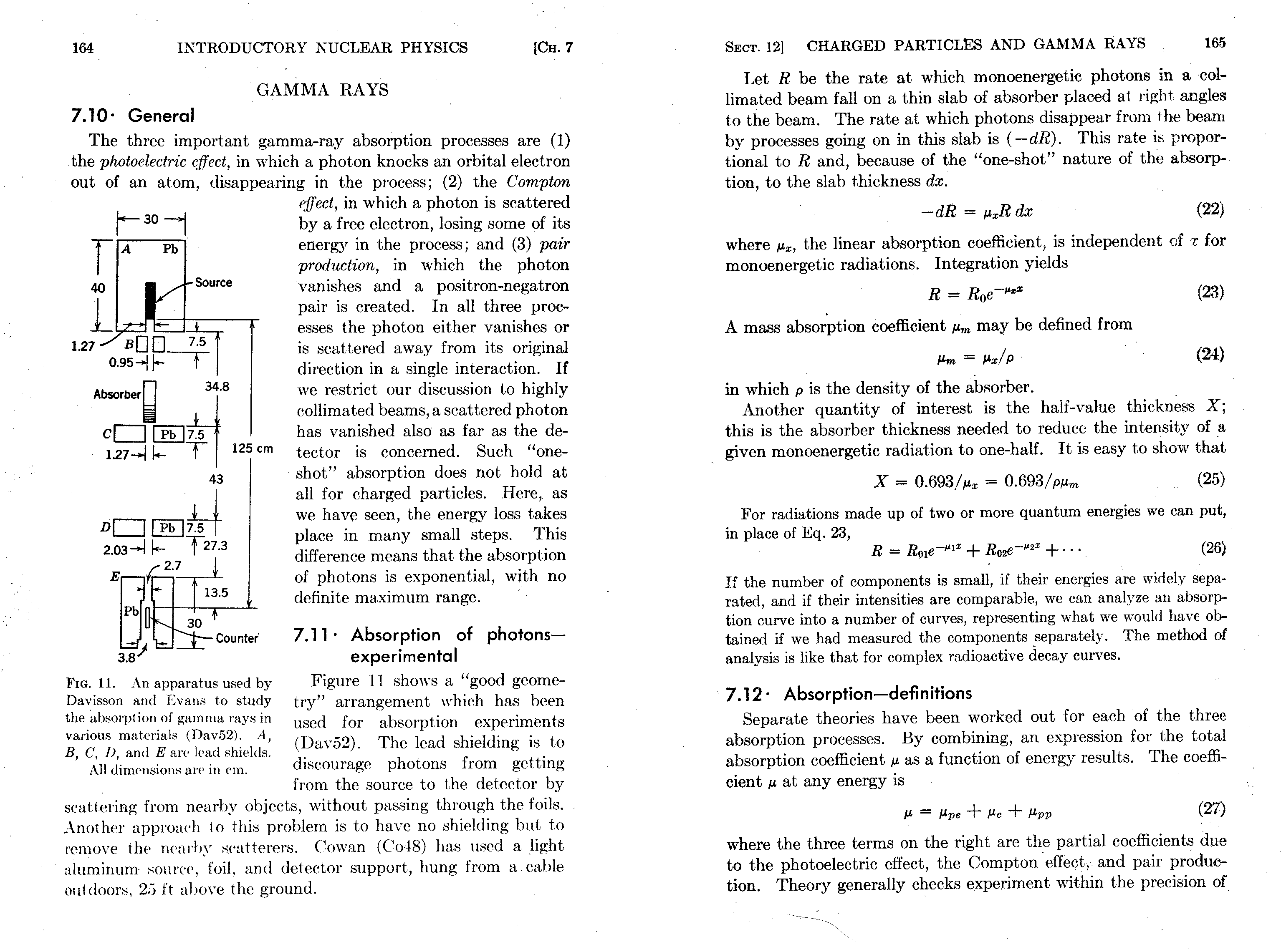

To simplify his discussion, Haliday here assumes that scattered energy isn't an issue. But with a detector out in the world, say hand held, (not his good-geometry example) it's a lot more complex. Charged particles also have some "straggling" issues but no where near as bad. You can sort of use foils of known stopping power as shutters and get a coarse spectrum that way, assuming you have a zero energy threshold detector behind them (there is no such thing). One thing he omitted above in his #1 is that a knocked out electron leaves an ion in the shield, and when another electron takes its place, you emit another ?-energy photon and start the process again inside the shield - and since that's a high-Z material, it could itself be a pretty high energy X ray again.The upshot is that it's impossible to do a perfect job on everything with existing stuff and knowledge, so all these sorts of things have to be traded off somewhat. Many-many books exist on this subject for designs to handle special cases, since there is no way to do the most general case.
For fusors, you can get rid of all the power-supply energy X rays with just a 1/8" piece of lead. But that's not the whole story by far. Some of the reactions make photons up in the high megavolts, as does neutron absorption in things -- 2.2 mev for absorption in hydrogen in the moderator (or your body). Now you're talking inches thick lead, not fun to carry (or design a shield for full coverage for with no leaks, either). To merely stop the secondaries from cosmics it takes about 4" thick lead and no cracks or leaks, but of course the primaries zing right through that without noticing it much. Which is why they do things down in salt mines sometimes - that's what it takes to eat those primaries -- 100's of meters of dirt and rock.
Most things with decent neutron capture cross section then emit gammas. http://www.nndc.bnl.gov/capgam/indexbyn.html
Shielding those is quite a chore in a home lab where you can't just have recourse to 6 feet of concrete. It's easy to make it worse, health wise.
