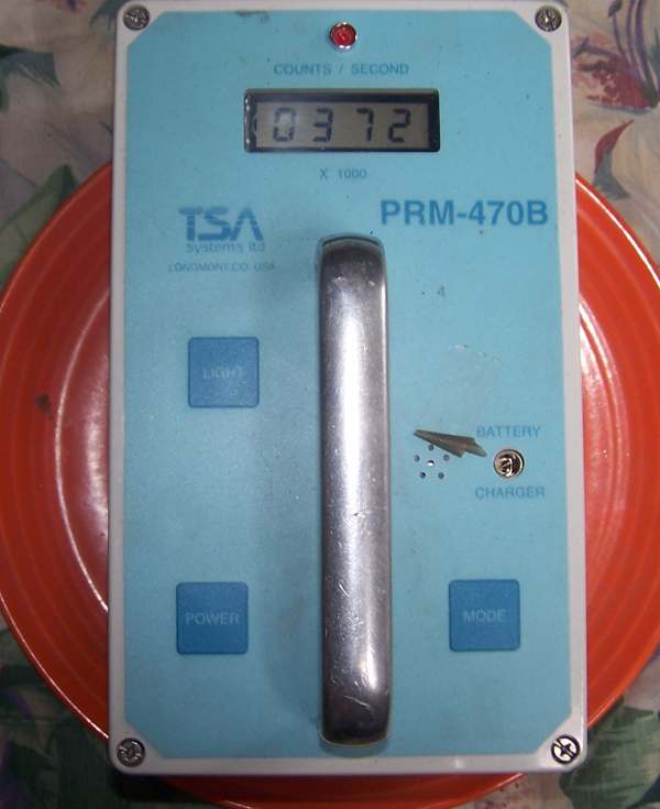

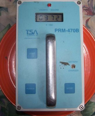

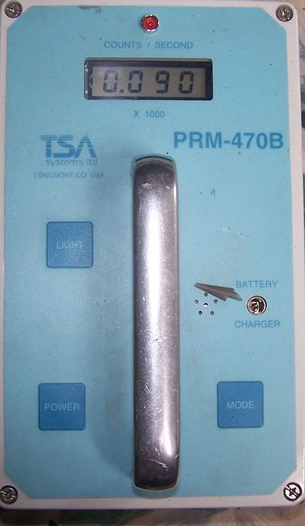

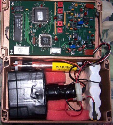

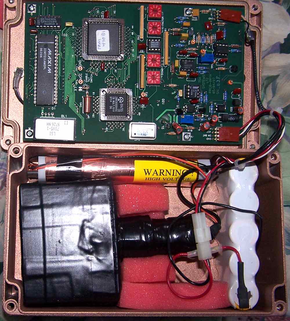

For example, this is a problem with Bill's "Henny Penny" which is a plastic scint/counter-only -- it goes wild with radiation that won't hurt you, because it sees *everything* and counts it all the same.
The unit is a TSA systems PRM-470b. It counts like 10/second on cosmic background where a 2" pancake geiger counts about 1/second -- it must be seeing the individual particles in showers. And that one counts a U glazed plate at 700 counts per second and the safety alarm goes off -- a bit much. Good for prospecting, but lousy around the lab.
So, what are we after with this idea? Let's define that first, then worry how to make one real. Easier to keep your eyes on the prize once you know what the prize is.

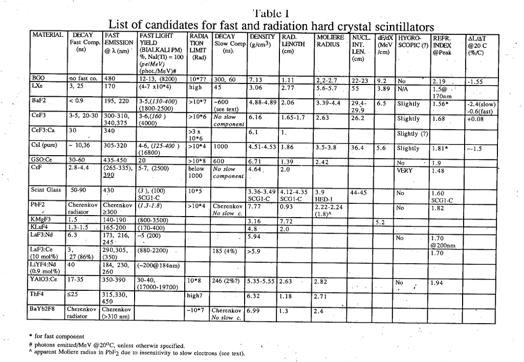

I would recommend against using any crystal that needs sealing. I've seen far too many "professional sealed" ones that didn't keep their seal. I have a shopping bag full of bad ones already that we got on ebay and other places. Further, if we are going for small form factor here -- you can't machine them for a custom fit. In addition, anything with iodine in it will activate around neutrons and be ruined.
This is responsible for the well-sealed but still bad NaI:Tl heads we've also bought -- they are counting their own activity, having been near a neutron source at some time.

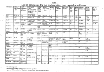

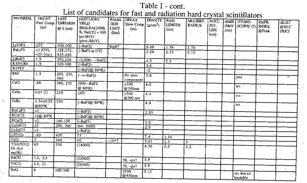

BGO is pretty good stuff for a lot of things, and not only can you get it, I already have about 10 of them. Used end on they are decent (not as good as NaI) for spectroscopy, and the end is 1/4" by 1/2" so you can use them with a small photodetector. They don't need sealing in air. I use a chunk off one I dropped inside the fusor as a visual indicator -- it lights up just fine in there (bright) in the X rays inside the tank.
The downside of any scint vs a geiger or proportional tube is that you won't be able to see alpha radiation usually -- they are hard to make light tight enough, and so by the time you get there, they stop alphas on the way in. With a small geiger tube (really easy to make, actually -- I've done a few here) you can have a thin enough window to let them in. So that's a consideration too, since most natural radio-actives give off alphas, mainly, which even a sheet of plain paper will stop and a sheet of Al foil (what you usually wrap a scint in) will really-really stop.

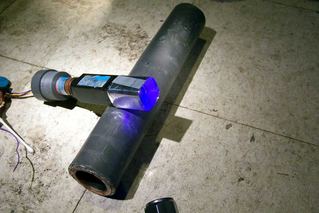

Re: Small radiation detector
Acetone just touches it, toluene makes it liquid fast. Yes, what I just tried was putting it rough on a piece of glass, then letting
some toluene into the interface with a dropper. Well....I should have treated the glass with mold release first. It got nice and shiny alright, but....now it's got a glass liner
glued on pretty well. Doh. The stuff comes off the mill smooth enough that I may just do the old sandpaper thing (starting around 400 grit), then finer stuff (like plain newsprint). If you take
a couple passes when you mill a side, it comes out pretty nice, almost optical already, just using a sharp HSS end mill. Seems like a second or third pass
makes it a lot smoother (I'm running a 3/8" mill at 550 rpm, which is on the fast side for this, but it works anyway). Rough cuts melt it a little bit but another pass
at the same quill setting smooths it back out nicely.
Most of these plastics are index of refraction in the 1.49 range, so are a lot easier to get the light to come out of than say BGO, with an index of 2.19.
You could have some kind of step index interface, but they work fine with either crazy glue or that fancy epoxy Elgen sells as a way to stick them
on a tube or whatever.
The trick to get the efficiency is to have a minute air gap between the plastic and the reflector -- the index gap between this and air
makes the reflection internal to the plastic. I use space blankets which seem to work better than Al foil,
as even though they let some light right through, they are shinier than Al foil, usually. Then worry the light-tight part.
I just tape it on there loosely as the reflector for the light that doesn't reflect inside the plastic.
In my case, I put the whole mess into some steel pipe, which also shields the phototube from mag fields, which mess them up.
I'll try and get some pix up here for all that -- it's a nice system after you machine the ends for a tight fit in the pipe. I use PVC for the phototube
end with a stepped hole in it to hold the tube centered, and another cap piece also a tight fit for the business end, material determined by
what I want to have come through, or be stopped.

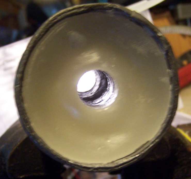

Neutron camera parts
Here's a pic of some of the pieces of a neutron one pixel camera I'm working on now. The big pipe is lead, with a 1.5" diameter steel pipe cast into
it with cerrobend for the tube. In front of the plastic, I have a moderator/neutron stopper with a hole through it to make a colimator so it only sees
fast neutrons, and from only a small angle view. Without that junk on it, this tube in a smaller setup is about as sensitive to fast neutrons
as my 3He tube is (which I run numb, so that's not completely fair). In that case it's just wrapped in lead to keep the gammas out.
Being far away and behind a tiny hole, it takes tens of seconds to count up a good pixel as a camera. -- I made the hole too long and too
small it seems.
Bore of camera, can't see the Cd washers in there along with the borated wax.

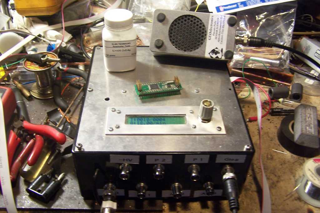

Here is a pic of some of the parts I'm working with anyway. The big box need not be anywhere near that large, it's mostly full of air and cable connectors.
(this one runs off a wall wart)
The little 40 pin dip board is the computer I use in that. The pancake detector is a very sensitive (for a geiger) from Geo, and there's actually
room in that package to put the rest into if a custom efficient HV power supply is made for that -- CCFL's will kill a couple of expensive
Li cells in no time flat with their 30+ ma at about 6v input requirement. For whatever reason, the lower volt input versions of those seem to
throw efficiency to the winds. However, the PIC computer has PWM outputs that with a single smd complimentary fet, can make some serious
drive for a small HV xfrmr....(amps at 5v if needed, ~35 ma without any help at all).
Even the 35 ma is well above what you'd normally put on a primary cell if you wanted it to live more
than a few hours. For high draw stuff I'm still a fan of rechargeable cells of whatever technology. This board counts up to 5 counters, and has
4 a/d inputs as programmed, the code is written, along with the drivers for the LCD glass. It puts out rs232 as well, for my fusor data aq system.
The uP itself is about 20ma running at full speed, but can run slower as I'm using hardware counters in it to do the counting, and it can go to microwatts
if required -- gets slow, but maybe no one cares.

The more I think about this, and did some tests the other days, the more I think we can skip the alphas if we want. 100% of my ore samples put out plenty of gammas on things I know won't see alphas, for example. The only really good alpha-only detector I've seen yet was a large table top unit RichardH had, and we'd never make that small. It had the light equivalent of an airlock, you had to put your sample in a drawer and shove it in there to measure it, so as not to wreck the phosophor by "charging it up". I think a plastic or xtal scint that just sees gammas and neutrons would do, what do you guys think? Henny penny is quite a detector working on just that, I can say that for sure after living with her a little. I'm still not sure if when the little red light comes on (which you can't see in the flash photo here of it on the plate) if that means a scale factor has changed. I'll have to find the book, but it sees that plate from 4 feet and more, well above background. For ref, a normal large area thinwall geiger here sees 40-60 counts per minute on cosmics. This appears to be saying 90 per second under the same conditions.
Henny on background only.  No sources near.
And here it is sitting on a feistaware plate.
Henny on a dinner plate.
At any rate, this thing feeds my partner's paranoia quite effectively. It sees a torbermite ore sample from ten feet -- with the sample in a 1" thick lead pig! A smaller version would seem handy indeed, this thing has over the top sensitivity. Like I said, I'm not real sure of scale factors here, I'll have to compare with my geiger counters, but note the light was on and the decimal point went away in the second picture.

Here is a table from one of my books on the topic. There's still not enough here to really do a good design, but it's a step up.
Scint Table, part 1
Scint Table, part 1
Table, part 2
Table, part 2
As usual, click these to get a readable version. Note that even with this much more information, we still don't know all we'd like to, but at
least we know a little more. We see that for example, BGO can absorb radiation better per unit length, so you'd need less in a pulse height analysis
situation, and indeed it is very popular in PET scanners for this reason -- it has "good enough" resolution for that, in a much smaller size. In fact,
other than the tiny ones from PET scanners, I know of no other affordable source of these. Now, this table was put together by the guys designing
detectors for places like CERN, and doesn't have some other info important to us in it other than not covering organics at all (I have another somplace for that).
They don't care much about low energy stuff, so good things for that are left out, as are slow things (from their perspective, a few nanoseconds is slow
as they have an 18 ns cycle time at CERN).
A consideration not mentioned here is how badly they attenuate their own light, which begins to matter when you go to bigger sizes for more chance
of intercepting the radiation you want to be sensing. For example all the Zinc based things are horrible in this regard along with being slow (which we
might not care too terribly much about within limits for our design unless it's really slow).
So the pure sensitivity number compared to NaI is more or less meaningless IF: A given hit gets you out of phototube noise well enough. That takes less
for go-nogo than it does for a good PHA spectrum. And those numbers are all for fully absorbed hits -- which may not be the case if the radiation length
is long, but the crystal not. Another important thing to know -- those are theory numbers, not what you can practically get out of one end of a given crystal,
some is lost, some reflects back from the index of refraction gradient, and hey -- phototubes aren't frequency flat and neither are these crystals.
So as with most design, it takes more than a single number to know what's best for a given application. And as always, price and availability figure in there
someplace.

I would note that significant improvements to the "henny penny" design are possible -- look at this picture of the guts.
Henny's guts
Henny's guts
Just for starters, unless there is some serious optical trickery going on under that tape -- most of the photons aren't finding their way to the tube.
Next, notice some off the shelf power supply is used that simply drives a normal resistive divider dynode chain -- little thought taken to efficiency there.
Also note the PCB and the more or less obsolete, high power, components used -- again, little thought to battery life, so you also notice:
The big battery pack it needs to run for a fairly short time.
Yet this is far and away the most sensitive detector to ever grace my lab. I would think that with just the improvements possible and pretty easy to do,
we could shrink this puppy quite a bit, gain longer battery life, and make it even more sensitive by fixing the dumb optics design. The two biggest remaining
pieces would be the scint, and the display -- the rest can get tiny and power efficient easily if we just use more modern electrical parts. Which shrinks the
batteries needed and so on. It wouldn't quite fit in a shirt pocket unless you made the scintillator a lot smaller, and the existing cheap LCD displays aren't
really thin enough, but given those limitations, I think we could design something really good - and generally useful.
So, no matter what, I'd suppose the search should be on for a good blue sensitive phototube, small, that we can drive the dynodes independently.
The ones I have access to at a decent price are bigger than this one by a good bit, though we could take the sockets off them to get to the
dynodes and ditch the R string in there. We want a gain level roughly in the million range.
