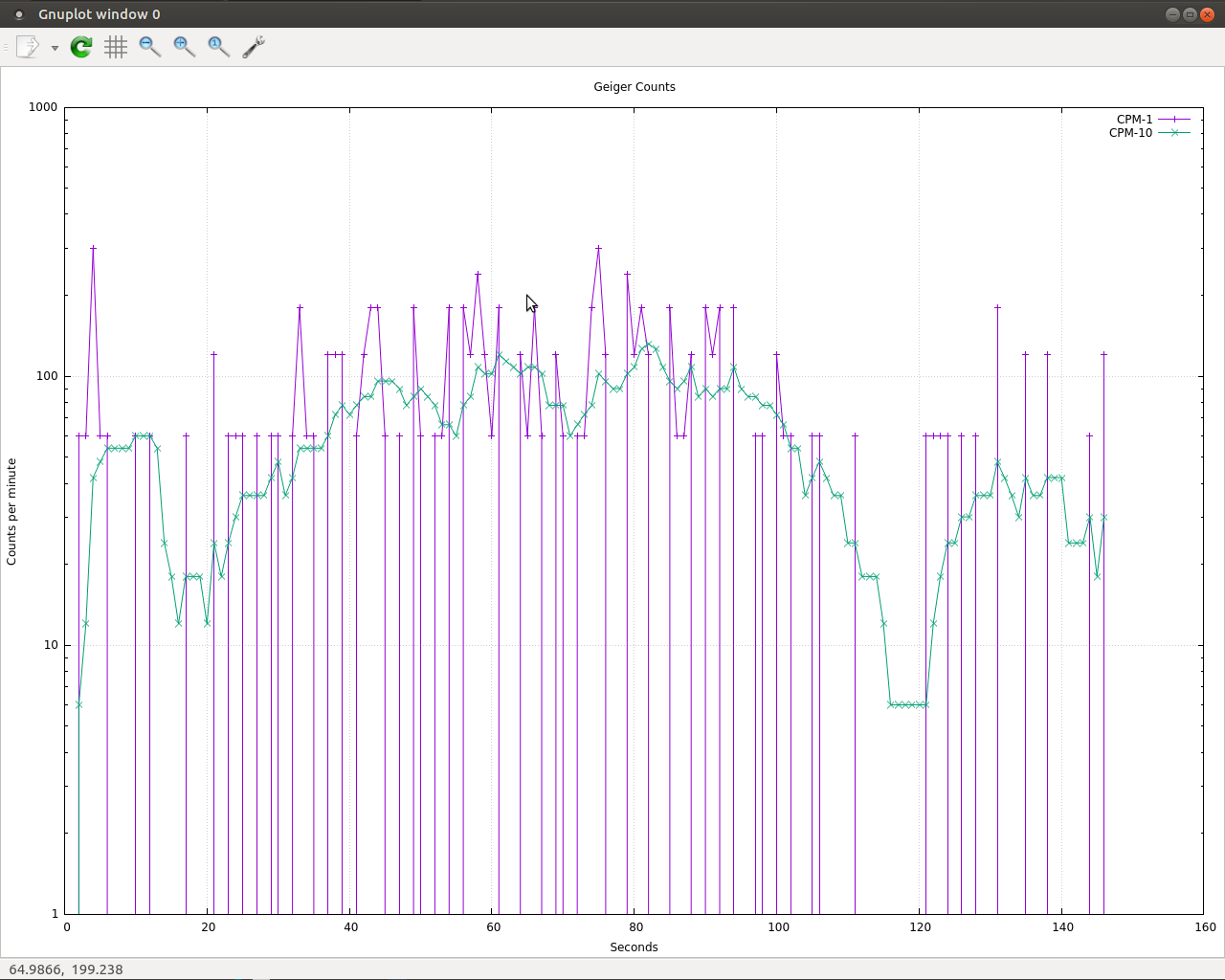

From a standard counter in the lab

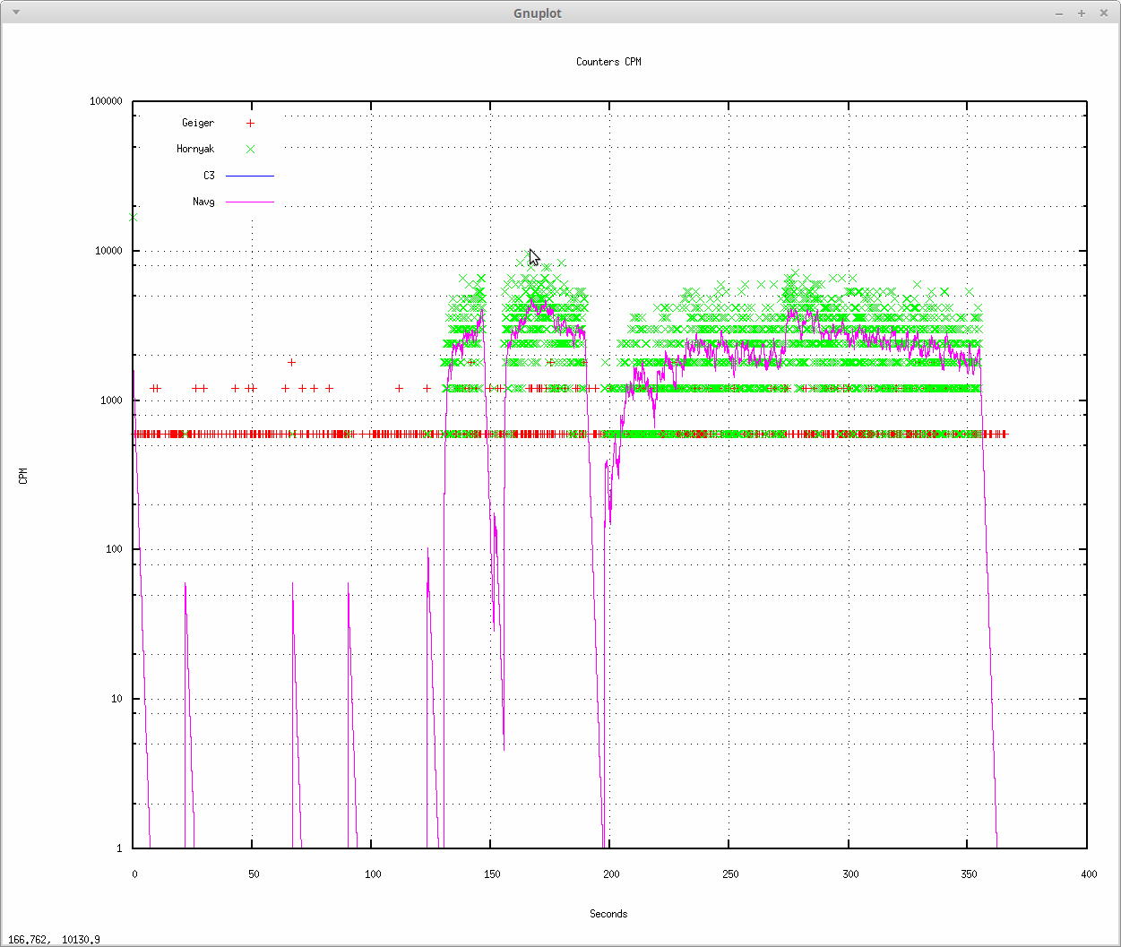

Our radiation plot.
Our radiation plot.
In this plot, the green X's are from our Hornyak detector, the one we trust the most and which was calibrated at HEAS 2009 along with a lot of other people's detectors, using Richard Hull's fusor as a source. The scale here is 980 cpm per million neutrons/second, which I mentally just round up to 1k/1million to be conservative. The purple line is an exponential moving average of that - attack and decay are straight lines because it's a log plot. We could, and used to, put our actiation sample on the geiger counter (the red crosses) after a run, and the log plot let us extrapolate back to the fusor cut-off time, which made it not as important to get that done in some fixed time. It's not as big a deal now, as we can't get there fast, and we're using indium now which decays much slower anyway. As our numbers go up, we can use "numb-er" activation targets, which is handy. Going for the gold takes on a whole new meaning in this context.

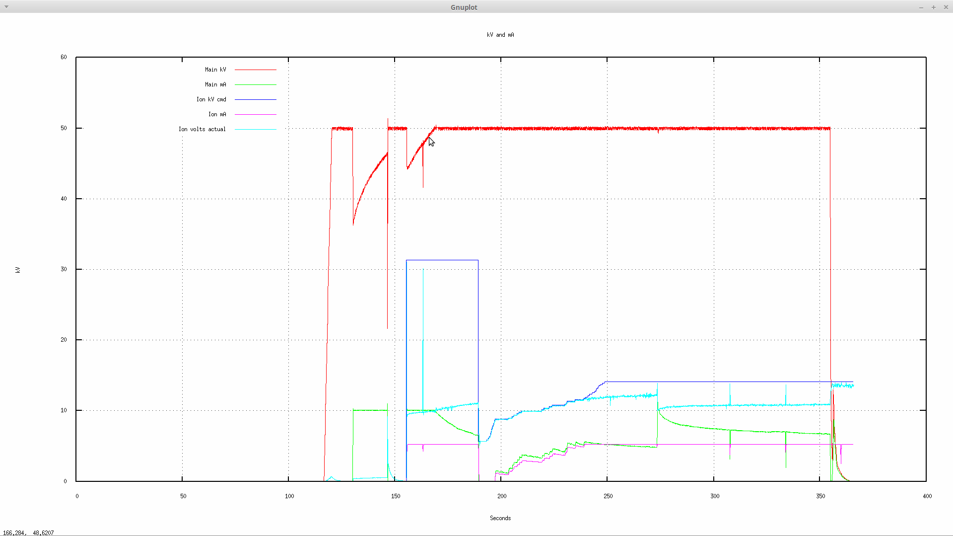

input volts and current
The above is the plot of power input for both grids, and with our scaling, kV and mA work out. In the case of the ion supply, sometimes we ask for more than we can get, so you see it bump into internal current limit around 5ma. The big guy on the main grid I have set for 50kv max at 10 ma max - and I don't fool with that remotely during a run (could if I added d/a converters) for now.

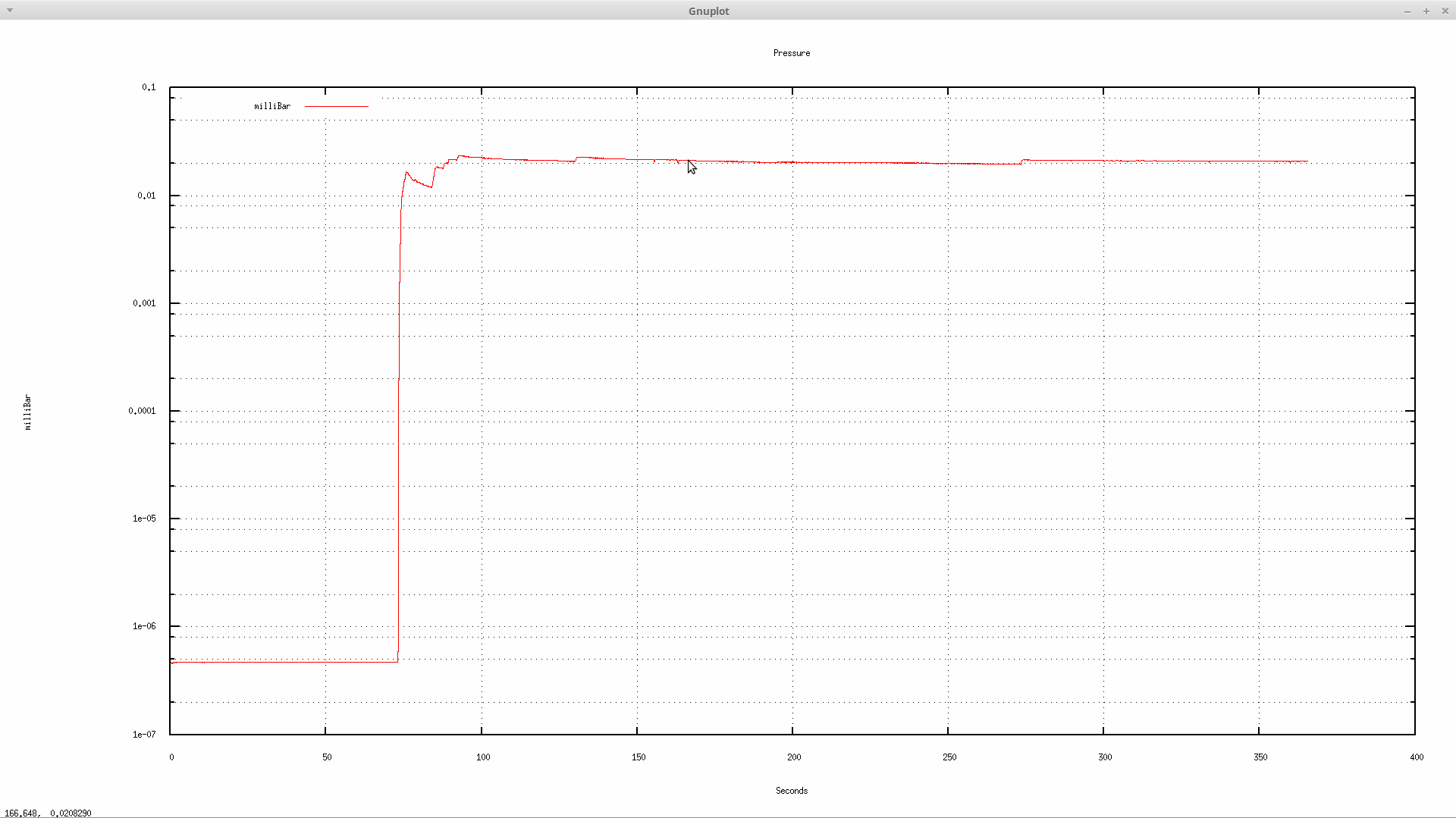

Maybe the least interesting is gas pressure.
gas pressure
gas pressure
You can see me letting it in, sort of, the speed at which I hit the solenoid is kind of hidden in the log plot. You can also see it change due to "cleanup" and other effects. The ion gage reads roughly 2x high on hydrogen, but not on He for example, and yes, during a long run, perhaps not here - we have measured a significant amount of tritium in the exhaust gas, which means about an equal amount of He3 is produced. In this case, most of what you see is cleanup, reduction of things chemically, and me letting in more gas to compensate (I have logs of all the button presses that did that too).

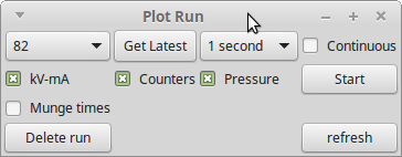

Last but not least for pix - here's the plot gui I wrote in perl and gtk3.
Gui for plotting
Gui for plotting
It asks the pi database for updates once per second default, saying in SQL "gimme all the timestamps newer than last time" and adds those to gnuplot instances created by perl code. The reason there is a "munge time" checkbox is that when we have crashes at the fusor end, the timestamps start over at zero, and in real time we quit getting new data, so that means "ignore the timestamps, just give me all of it, and make up times under the assumption that the sample rate is 10Hz". It's far from ideal, but it's better than no data. I've put in a lot of effort to prevent that from happening in the fist place, and this run it didn't happen...(I will post the raw code at some point too, as an example of fairly readable perl. Since GTK3 uses XML, well, I can't make that something you'd call readable, breaks of the game, but that's not my or Larry's fault.
