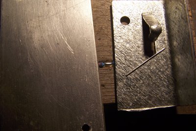

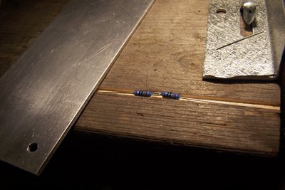

I want this detector working more or less yesterday, and I didn't have the just right resistor values in stock (and resistors are so cheap I'd have to figure out a few other things I want to make anything like a minimum order at my chosen vendor). But I had a big bag of ones just half the size I wanted. Soooo...I need a bunch of these, hooked in series in pairs. Yes, I can do this by hand, I'm fairly dextrous for a left handed guy, but...I'm in a shop, it's full of tools that can make tools, darnit - same as being on a computer that has say, perl on it. Soooo...we build a jig for this, since it saves more time than it takes to make, and saves lots of fiddly frustration. Like so:
Simple...
Simple...
I just needed a slot and a couple small flat weights. Not shown is the other side, where I tried different slot depths - it's easy on a table saw, and by cutting a few, I knew I wouldn't have to walk back across the shop. So you cut your resistor leads, put them in the slot, and set the weights on them like so, and solder:
Just solder this - the weights prevent the surface tension of the solder from lifting it all off the bench.

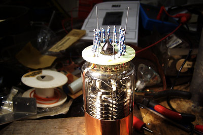

And almost before you know it, you're done:
All those pairs that are all nicely uniform done in a jiffy.

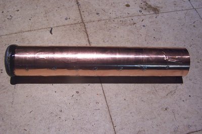

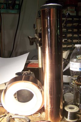

This is ~ $100 of "worth every penny": https://www.amazon.com/Copper-Conductiv ... opper+tape
Which lets you do things like this:
Shielded PVC pipe using copper tape, overlapped and soldered in-place..
I use this all over, including say, inside an electric guitar to kill hum, to be a "shorted turn" in RF situations, you name it. Solderable without messing up the adhesive. Now I have a pipe that's insulating on the inside, yet grounded and shielded outside.

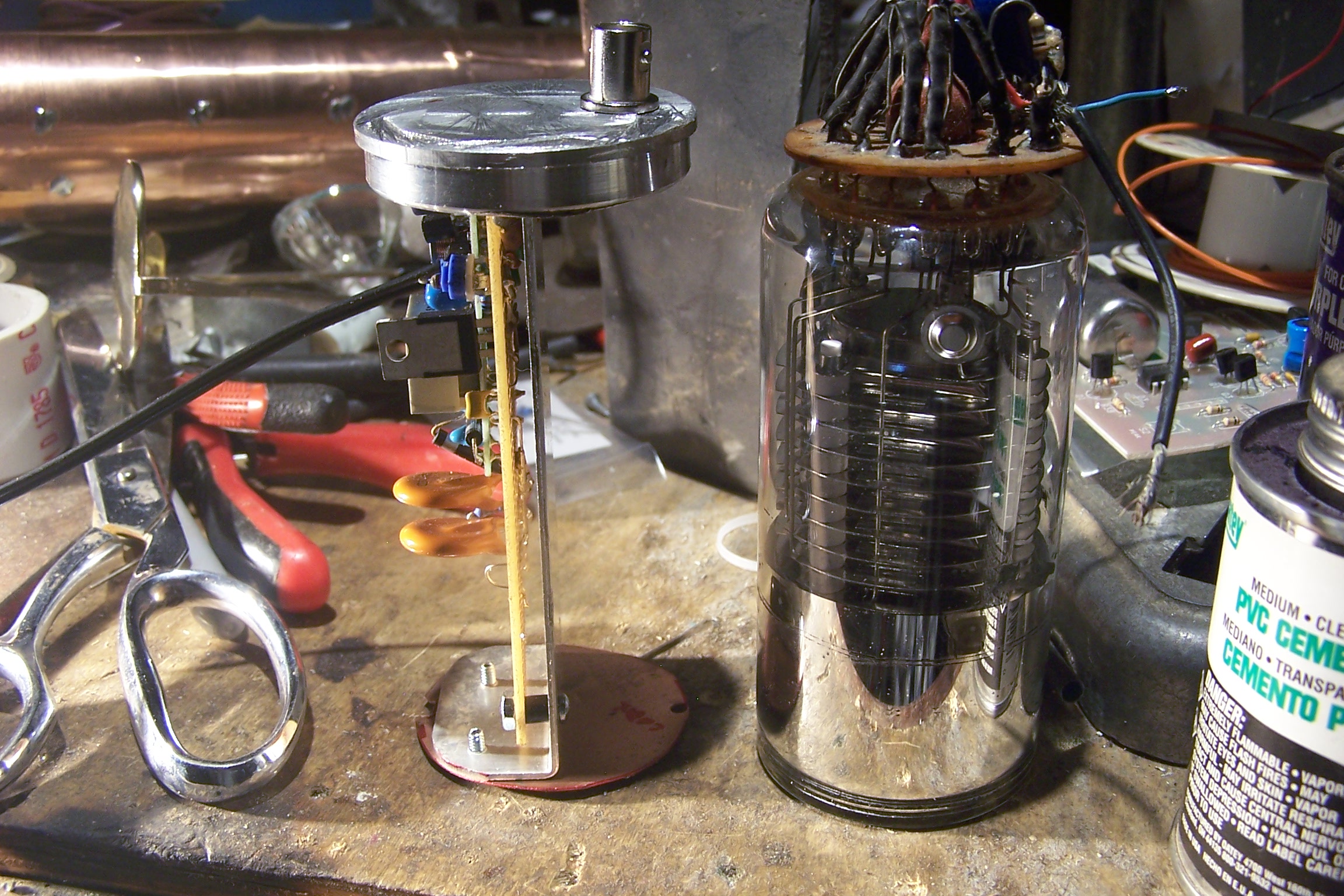

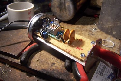

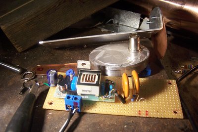

I built up more more or less standard HV supply for this, schematic to come. It's just a 12 watt (big) 12 volt 1kv output CCFL inverter, a couple fast diodes in a voltage doubler, some output filtering, and an lm150 input regulator. Fairly "stiff" output so it doesn't really need feedback regulation, particularly with this fixed load.
Power supply and other parts
I'm using a 9v 800ma wall wart - because it was laying around (same reason I used an lm150 instead of a lm317). It puts out around 11.7 volts under this load (~ 2 megs across the HV output) at full crank which is around 1900 volts out - more than I need here most likely (shooting for around 1200 or so, which I guess is about right). These older transformer wall warts put out much higher voltage at light loads than the spec, just about universally. This is due to them using cheap, thin wire for the windings, so to meet spec at full load, they have to account for a lot of series R in the transformer itself. Saves a little heat in the series regulator under load, too. Just a tip - right-sizing is good design now and then.
This will be mounted on that aluminum angle bracket with the copper end plate (which will shield the phototube from the noisy CCFL). Any other electronics will go on the other side of the Al plate to avoid that CCFL noise, which is prodigious - 1kv of fast risetime 50khz is no joke. That little piece of copper flashing (also an expensive but worth it kludge material) will be punched out, retained under the BNC nut, and hold the other end of the Al plate. Thus, the power supply and any preamp or audio provision will be able to just slide out of the end of the pipe.

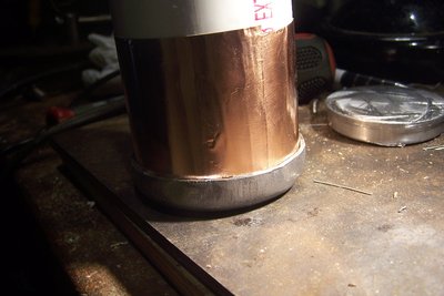

Here's the enclosure. I ran the cap through the die again with the pipe as the pusher to get it as close to light-tight as possible, then glued it on with black silicone (not on every street corner, but from McMaster-Carr).
Pipe and cap
Pipe and cap
I will solder a wire to the cap and to the copper tape to ensure it's well grounded.
Now I'm working on the other stuff - next to the power supply mockup is another phototube without the hornyak button, just for looks (it's not wired correctly for this application anyway).
Partial mockup of power supply and other end cap
Notice the aluminum bracket roughly centered in the enclosure that will hopefully keep its noise away from the other side of it, where the signal will be. I will of course use coax for that. The copper flashing ring on the table end is also to help with noise, and probably a little with light leaks. Mostly noise. I cut a piece of teflon sheet to go right behind th phototube and prevent shorts, and will fish around for some super-black foam rubber I have from another photodetector somewhere to push the phototube to the front. Inside the front of the pipe I glued in a couple of 3/16" spacers so the -1000v or so copper wrapped around the phototube and detector won't short.
Here's a little more finished looking power supply and back end. Yes, I actually got the calculations right and the pot is centered when it's putting out what I think is going to be the right voltage. Incoming power uses the old "tie a knot at the hole" strain relief, and more black goop.
more complete back end
My goal for today is to get this wired the rest of the way up, and into total darkness.
This is the part of this that stinks the most - you have to trust you more or less got everything right, and exposure to light "charges up" the phosphorescence of the ZnS, so you have to wait 24 or more hours after each light exposure to test the thing. For someone with my (lack of) patience, it can be excruciating.

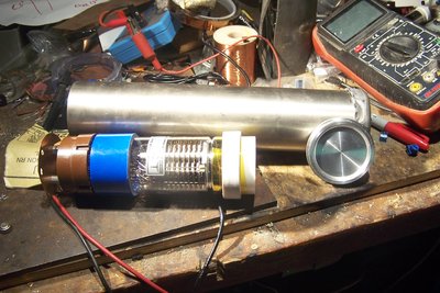

So, we bought a new in box tube and a new hornyak button from Eljen. The sad thing is the new tube has a base on it that won't fit in the plastic pipe, so I get to do nearly all of this over.
I stupidly used optical epoxy to glue the old hornyak button to the bad tube...since grease would have ruined the stickem on the copper tape, and it's not a place you want to solder while on the glass...
More when I have more. I have to use a larger pipe to clear the base for the new tube, which means a new piece for the back end too and various other fiddly junk. I'll get there.

So, the new tube wouldn't fit in the old pipe. Obvious solution - get a bigger pipe. We did, it's stainless steel, and a new set of caps had to be made for it, a socket for the tube wired up and so on, those parts are now done:
Getting there
Getting there
The old power supply will fit, I have to drill the back end cap for DC input and BNC output, and make a new round holder, emi shield, and light-stop for the far end of the supply.

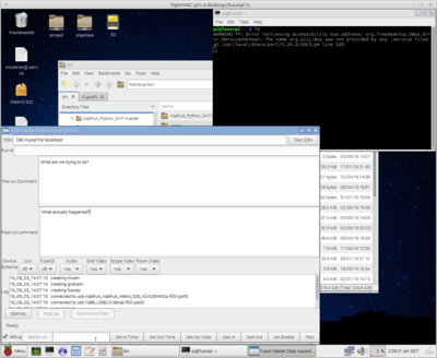

O/T but here's what the remote pi screen looks like here at the op position (leaving out the web streamed cameras etc) at this point. I'm using tightVNC for that.
Just finishing this up.
