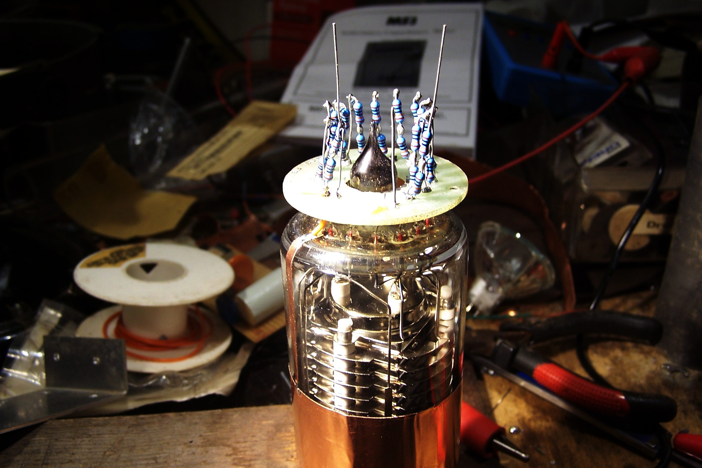

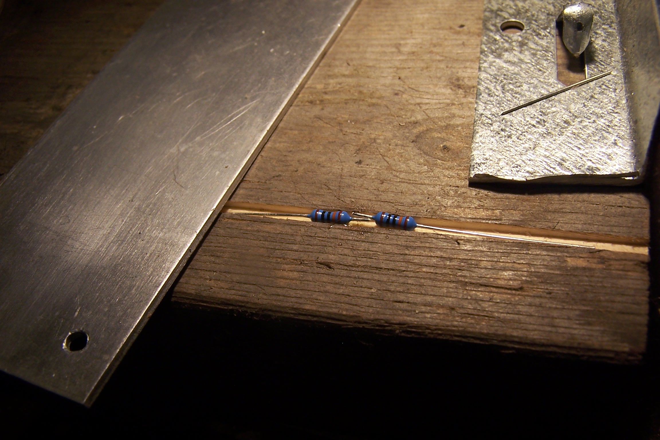

I want this detector working more or less yesterday, and I didn't have the just right resistor values in stock (and resistors are so cheap I'd have to figure out a few other things I want to make anything like a minimum order at my chosen vendor). But I had a big bag of ones just half the size I wanted. Soooo...I need a bunch of these, hooked in series in pairs. Yes, I can do this by hand, I'm fairly dextrous for a left handed guy, but...I'm in a shop, it's full of tools that can make tools, darnit - same as being on a computer that has say, perl on it. Soooo...we build a jig for this, since it saves more time than it takes to make, and saves lots of fiddly frustration. Like so:

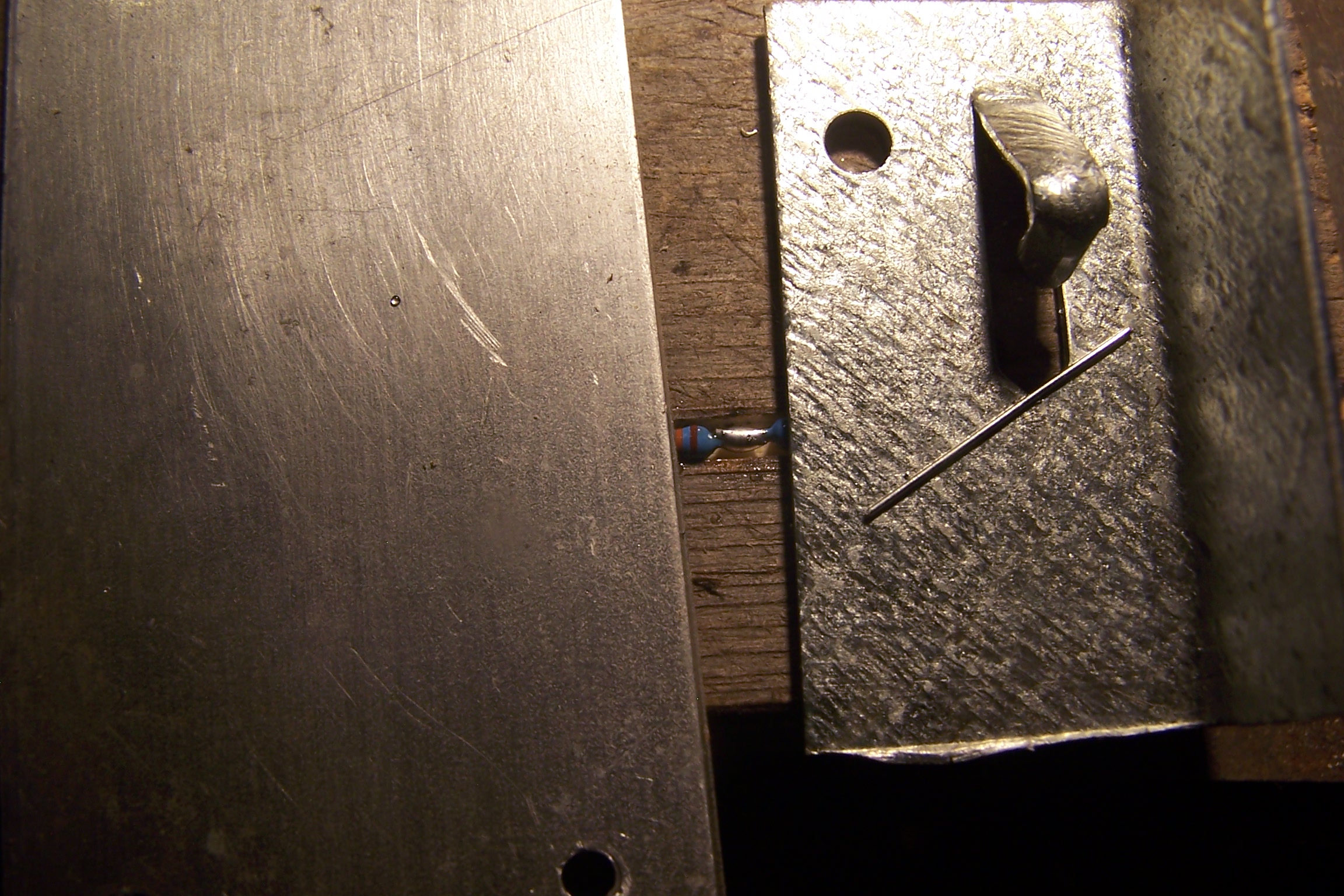

I just needed a slot and a couple small flat weights. Not shown is the other side, where I tried different slot depths - it's easy on a table saw, and by cutting a few, I knew I wouldn't have to walk back across the shop. So you cut your resistor leads, put them in the slot, and set the weights on them like so, and solder:
And almost before you know it, you're done:

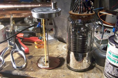

2" Hornyak build details
Re: 2" Hornyak build details

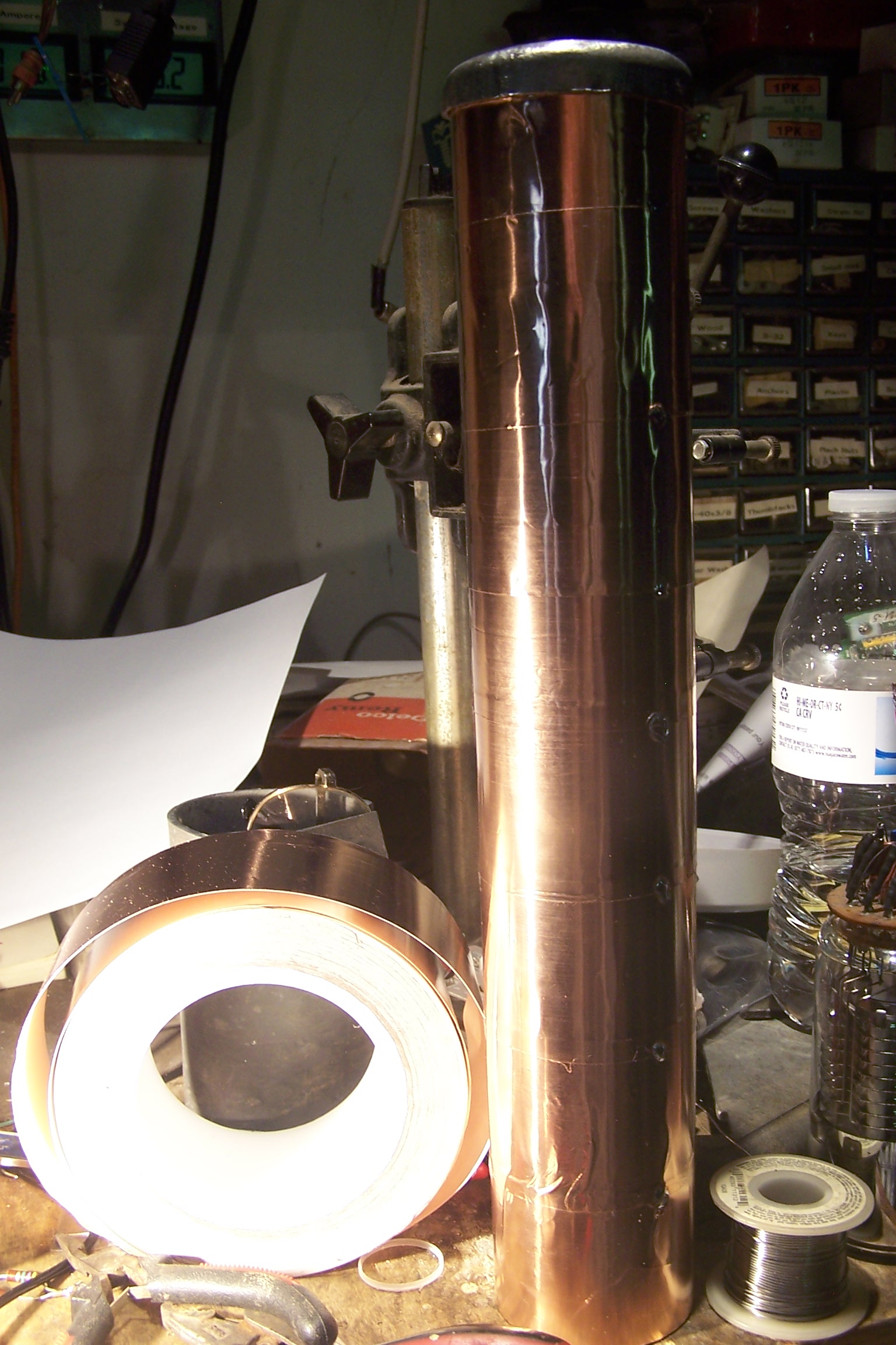

This is ~ $100 of "worth every penny": https://www.amazon.com/Copper-Conductiv ... opper+tape
Which lets you do things like this: I use this all over, including say, inside an electric guitar to kill hum, to be a "shorted turn" in RF situations, you name it. Solderable without messing up the adhesive. Now I have a pipe that's insulating on the inside, yet grounded and shielded outside.

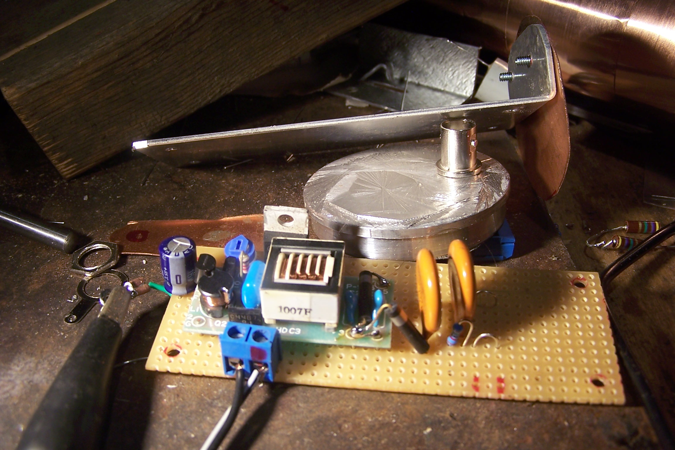

I built up more more or less standard HV supply for this, schematic to come. It's just a 12 watt (big) 12 volt 1kv output CCFL inverter, a couple fast diodes in a voltage doubler, some output filtering, and an lm150 input regulator. Fairly "stiff" output so it doesn't really need feedback regulation, particularly with this fixed load. I'm using a 9v 800ma wall wart - because it was laying around (same reason I used an lm150 instead of a lm317). It puts out around 11.7 volts under this load (~ 2 megs across the HV output) at full crank which is around 1900 volts out - more than I need here most likely (shooting for around 1200 or so, which I guess is about right). These older transformer wall warts put out much higher voltage at light loads than the spec, just about universally. This is due to them using cheap, thin wire for the windings, so to meet spec at full load, they have to account for a lot of series R in the transformer itself. Saves a little heat in the series regulator under load, too. Just a tip - right-sizing is good design now and then.

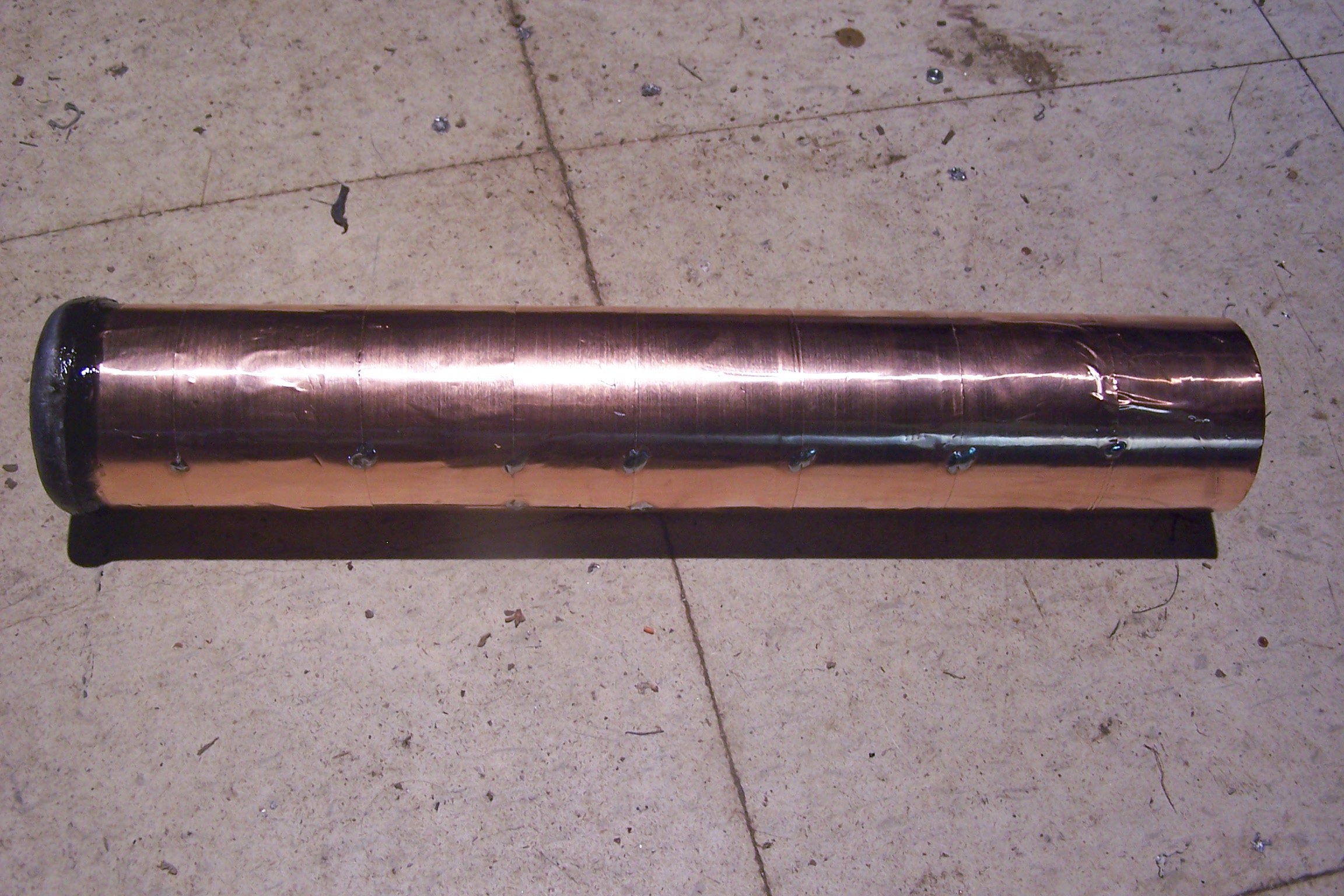

This will be mounted on that aluminum angle bracket with the copper end plate (which will shield the phototube from the noisy CCFL). Any other electronics will go on the other side of the Al plate to avoid that CCFL noise, which is prodigious - 1kv of fast risetime 50khz is no joke. That little piece of copper flashing (also an expensive but worth it kludge material) will be punched out, retained under the BNC nut, and hold the other end of the Al plate. Thus, the power supply and any preamp or audio provision will be able to just slide out of the end of the pipe.

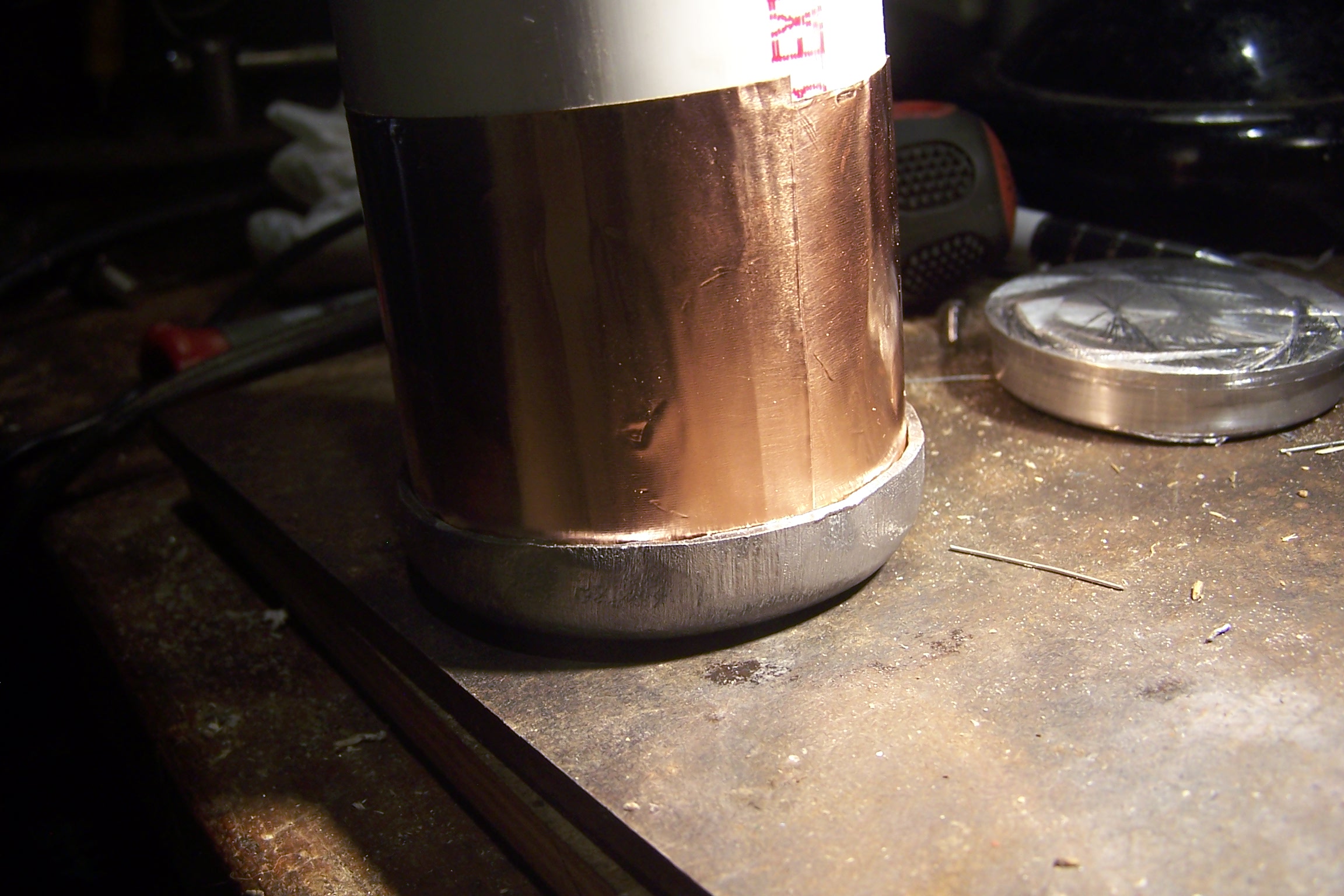

Here's the enclosure. I ran the cap through the die again with the pipe as the pusher to get it as close to light-tight as possible, then glued it on with black silicone (not on every street corner, but from McMaster-Carr). I will solder a wire to the cap and to the copper tape to ensure it's well grounded.

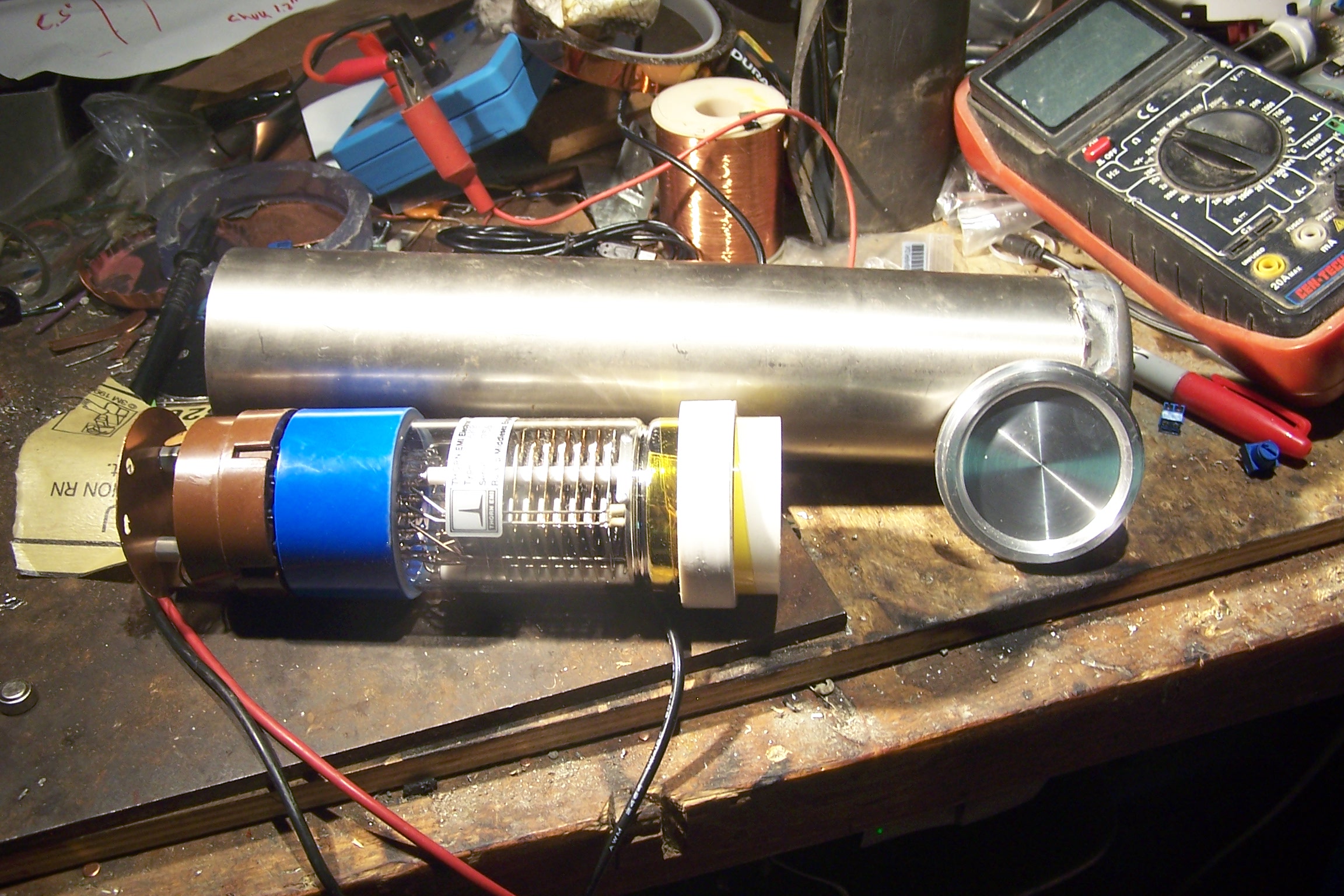

I have a little bit more on this. This one has had to take a slight back seat due to a patent final-filing deadline, and the data I expect to collect with this isn't relevant to that directly.
So, the new tube wouldn't fit in the old pipe. Obvious solution - get a bigger pipe. We did, it's stainless steel, and a new set of caps had to be made for it, a socket for the tube wired up and so on, those parts are now done: The old power supply will fit, I have to drill the back end cap for DC input and BNC output, and make a new round holder, emi shield, and light-stop for the far end of the supply.

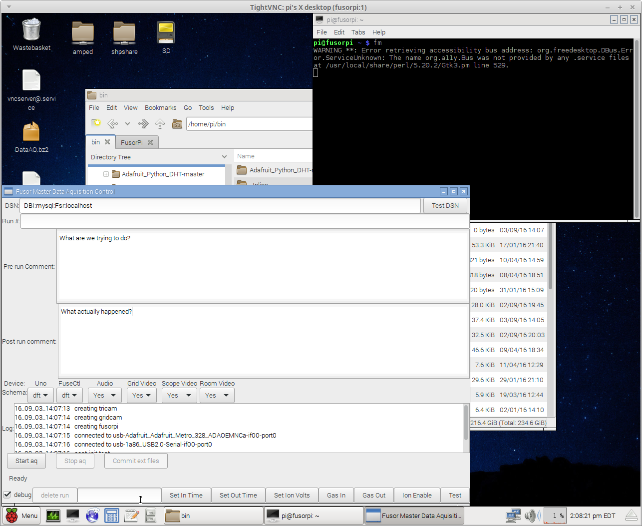

O/T but here's what the remote pi screen looks like here at the op position (leaving out the web streamed cameras etc) at this point. I'm using tightVNC for that.
See link:
