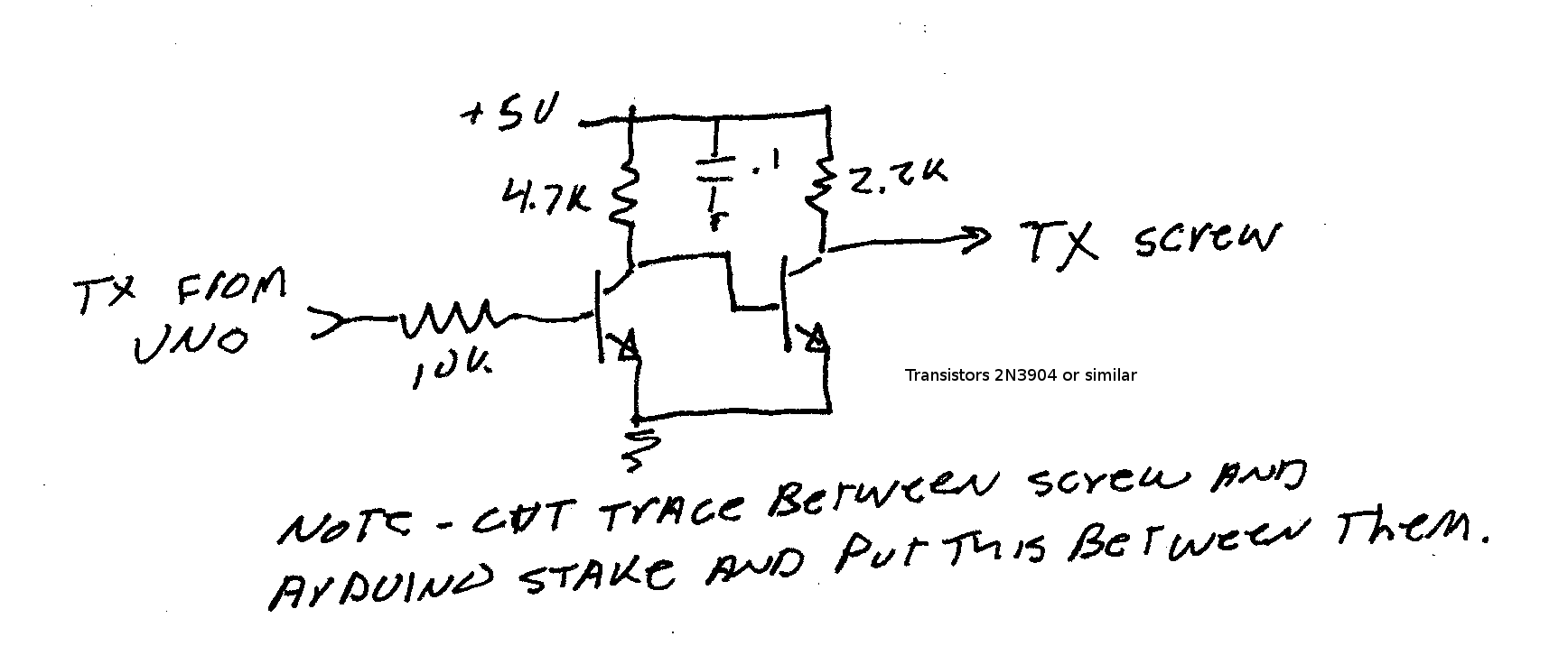

I decided on a wired-OR async serial situation as the physical layer. With this, we don't use the RS-232 levels, but 0-5v ones, allowing for the wired-OR situation on one of the wires. I'm starting with 115200k baud, as this seems like it will work over the required distances - around 50 feet max, with good cable termination and attention to reflection issues and drive levels. I'm using a raspi as the hub, and it's TX output is amplified both voltage and current to 5v and up to 2 amps(!) via a transistor and complimentary mosfet inverter. It will have a nice large fan-out to drive unmodified Arduino Unos and overwhelm their 1k resistor to the FTDI chip easily. When the pi speaks, they all listen. Period. In fact, this interface can even power the arduino via the protection diodes on its serial port...one has to be careful!
Going back to the pi, we have one wire for input. Each arduino has a two transistor circuit (NPNs) and a pullup, so that any one of them can drive this wire low (the start condition, stop is high). Fairly easy, and doesn't have to be quite as robust as the pi drive, so stuff like 2n3904's will do here. I could design for max fan(in)out - but I don't think I'll need more than a few Arduinos on any one pi anyway. More important will be using impedances that more closely match the cable I use so that reflections won't cause errors, and managing ground bounce. There will be more on how I did this - once I have.

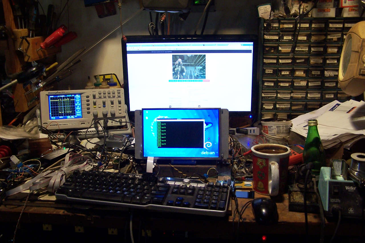

As mentioned elsewhere (I'll come back and edit this with some more cross-links to other parts of this project on the board, till then - search and you will find), I made up a nice box for a Pi (B+ at present, like everyone, I can't wait for the B-2 but they're all sold out). It has an HDMI display and board, a switching power supply to get to 5.1v for the pi, and of course, the pi itself, which just might become a B-2 when they can be had. It's running raspimjpeg, apache, mysql, a full dev enviornment for various things (mainly, pi, perl, arduino), and is a nice, if slow, general purpose computer and web server. Slow is relative - you might notice the computer in the back, a fast i5 NUC - is showing video streamed from the pi. It actually does this faster, with more resolution, higher frame rate, and less latency than I can manage using another NUC (also i%) and a webcam...the GPU on the pi is actually quite decent...

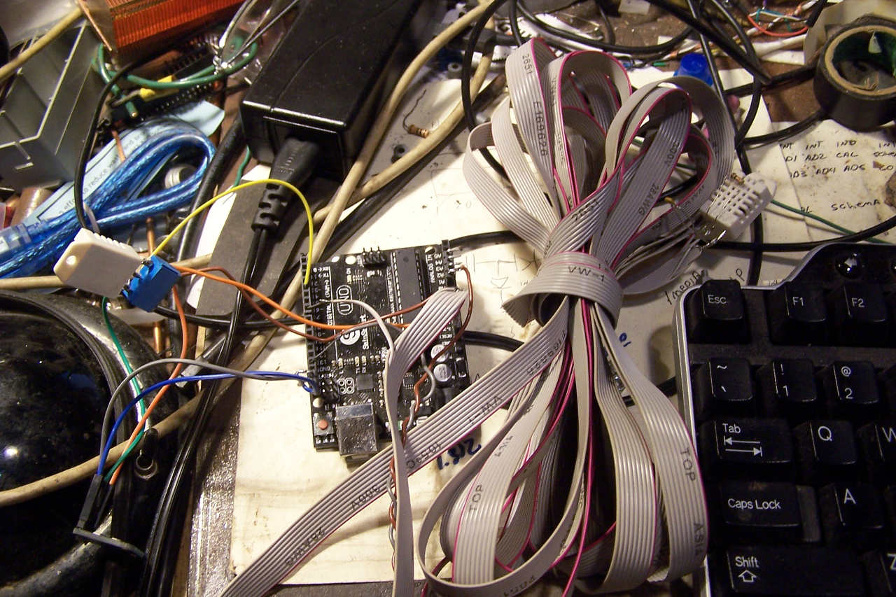

Here's the arduino kludge with some sensors I used during a recent severe cold snap (well for us it was severe - around 3f) to watch the plumbing and so on. This is when it became obvious that NO| WAY should you go for internet of things. This "meta data" tells all - I can tell whether I went over there to take a dump - or wash dishes or didn't go at all, just from this, and this isn't exactly super-intrusive data collection...Don't fall for that! I don't mind spying on myself, understand, it's just not something for public consumption. All by itself - no camera, this thing collected all too much (very interesting) data, and I plan to max out about 2 of these doing various things. The pi will merely manage it all, and be built into a wall for display and control, as well as web-serving it all on my LAN (only) so I can do things from anywhere else on the 'stead.

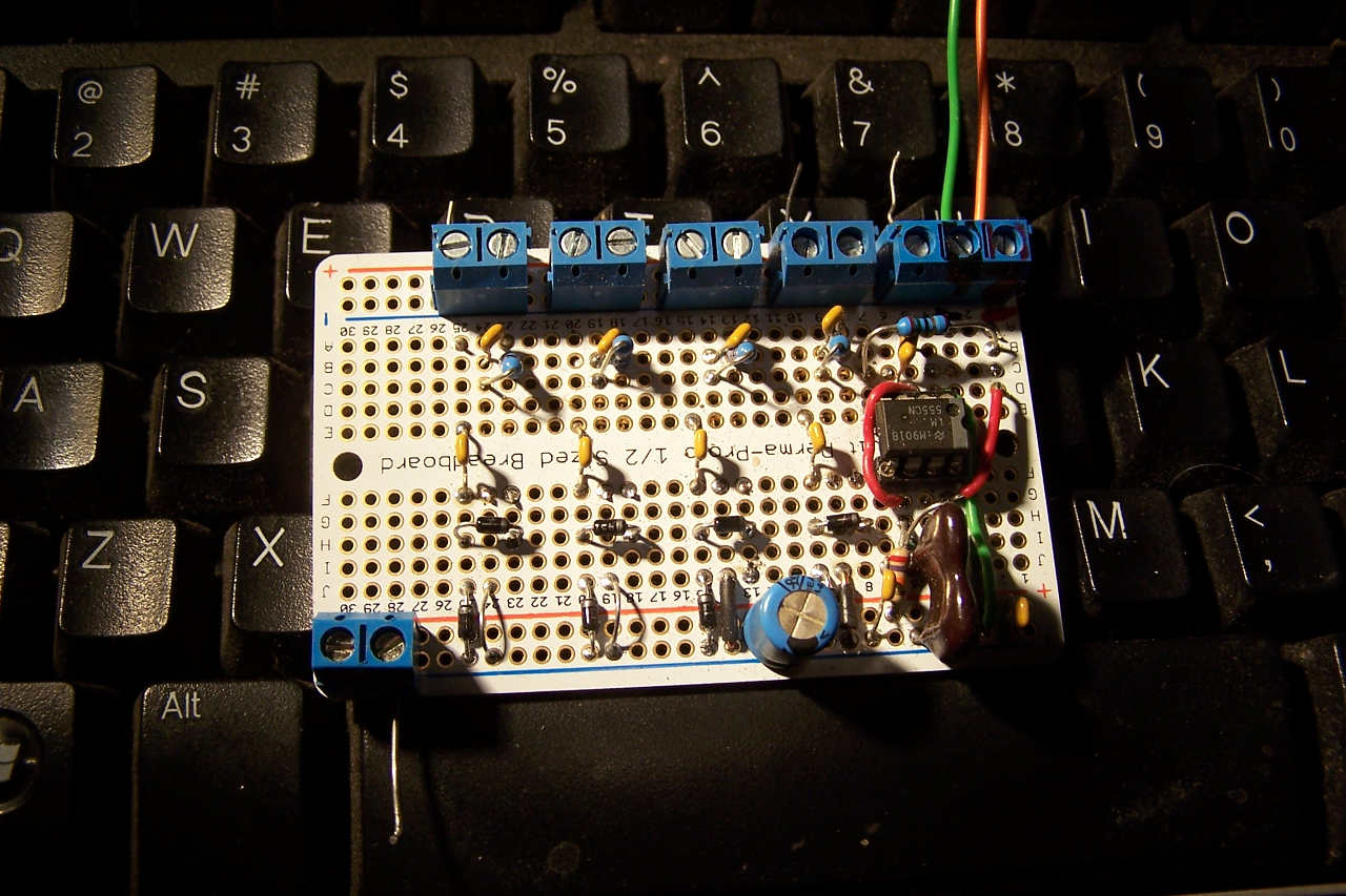

I've developed a water level detector based on an old idea National Semiconductor first put forth (decades ago). You can't use DC current around water - things etch and corrode. But water, pure or otherwise, has a dielectric constant of 81 or so.
This makes any two wires put in it (I'm using titanium) a good capacitor. So, one puts in one big wire, and drives the snot out of that with say, a 50khz 12v square wave - AC coupled. Any other wire touching that water picks up a fair amount of that, and using an AC coupled voltage multiplier (doubler in this case) with an appropriate load (100k in this case) you find you can get a nice analog voltage out from around zero if no water is touching one of the wires, to a bit over 5v (at low current, no danger) if both are submersed. This circuit "triggers" above 2.5v output or so (actually it's the software reading an a/d channel doing the triggering) when more than about 3/16" of any of the sensor drivers is touching water. With 4 channels of input, I can have a decent idea of how much water is in my cistern, at the level of - "is there room for another batch from the rain collector?" or "should I be conserving water use?" which is what I need here. Since I wanted 12v signals, the easiest and cheapest way was to use a simple 555 timer to make those, and just some standard silicon diodes, .1uf caps, and 100k resistors for the "sensors". It works a charm in tests, we'll just have to see how well and how long in real life. But Ti wire doesn't corrode very easily...so I expect that barring false alarms from condensation or something, this will live nearly forever, and it doesn't draw squiddly power.

Just a quickie showing going from raw prototype to a build that will get installed, for the arduino part of this project.
http://youtu.be/gbC4ne_Hiew
The Adafruit "Screw Shield" for arduinos is pretty cool for this. I like the screw terminals vs the little stakes for things I might have to go repair someday. And I got a little room to build and test the two-transistor buffer for the arduino transmit line on the proto board (with lots of room left).
Here is the schematic for the wired-OR for arduino serial. This, combined with a beefy driver for the Pi's transmit, and a protocol I developed, allows for one Pi to connect to many arduinos over the same cable - RX, TX, Gnd. The Pi drives all the arduino RX's from it's TX, the arduinos are wired OR from their TX's to the Pi's RX, with a pullup on each device. So far, running 115200 baud seems workable even over 40-50 ft distances. This is not a really picky circuit, just build it small and tight. I will publish the one on the Pi end, but I plan to make some changes to it - it's not perfect enough yet as is. I used a pretty large (though in micro-8) complementary FET as the output, with a similar single transistor to get the other inversion off the pi, hooked to 5v for full drive on the wire. It works, but even with a 1k pullup on the FET input, it slew rate limits one of the edges due to miller capacity in the fet. I think I'll wind up with more manageable sized fets and just use two of those in series...one danger, if it is one, is that the FET pair I'm using can do 3+ amps and will sort of power up a bunch of arduinos via their protection diodes. I might have to put a series resistor at each one to make them safe from frying if they in turn have heavy power loads from sensors...Looking into that now.
