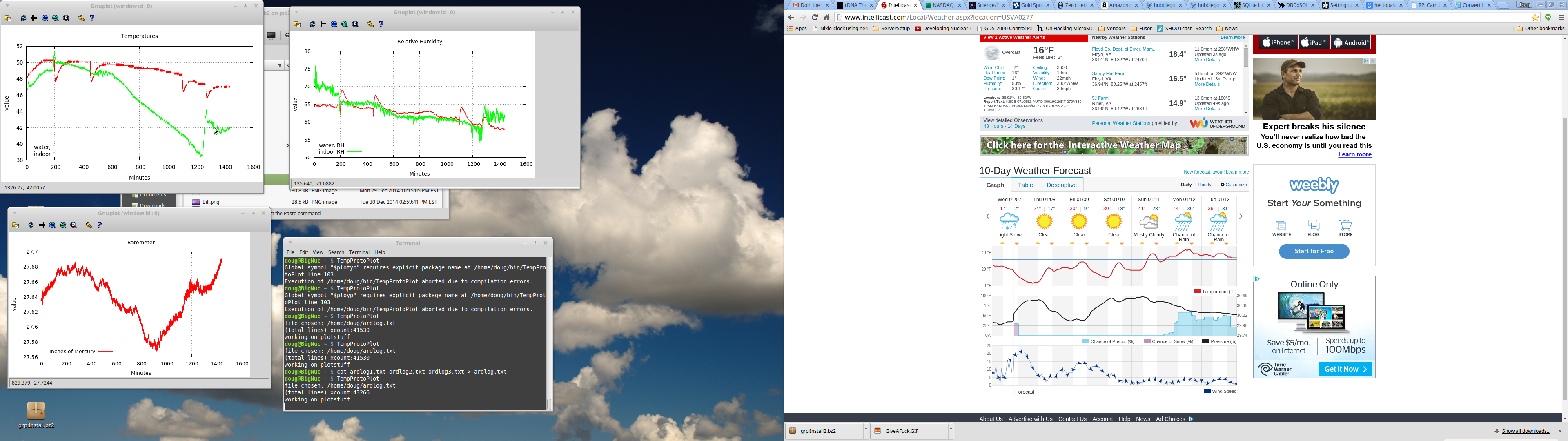

Here's some stuff I've been working up for here, but it's all for "cold" rather than hot water, and can therefore use the cheap DHT-22 sensors for temp and humidity, and the BMP-180 for temp and barometer.
There's a rather large discrepancy between my baro readings (converted from hecto-pascals to inches Hg by my code). Could it be that the local weather corrects for our altitude? Water never reaches 100c here on the stove, more like 98 tops.
(I'm at something over 2k feet). Still, relative pressure is really what one mainly wants, and it's going up as the real cold moves in. This all got pushed way up on the priority queue as you can see from the right half - they are predicting 3F temperatures tonight, and that's a record low for here, along with winds. Worst we've had, ever, since around 1979 was sub 10f and 20 mph winds for two days, but not very sub 10 - 7-9 at worst. And yes, everything that could froze, and it was a lot of work to replace. I didn't get as many sensors on there as I wanted yet - just had to move the stuff over there or have nothing. This beats nothing.
What's cool about this is I'm monitoring another building on campus without having to go over there in person, with wireless...yes, I'm not keeping it real warm there, it's impossible so far from the woodstove and so close to the floor where I'm measuring indoor temps. You can of course see the bump in indoor temp where I went to use the plumbing, and for that time, turned on the propane heaters full blast...comfort. Didn't want to freeze to the seat! You can also see about when I quit going over there last night to push more wood into the fire...and other interesting "metadata" that an "internet of things" might collect. I'll settle for a tight security "LAN of things" myself.

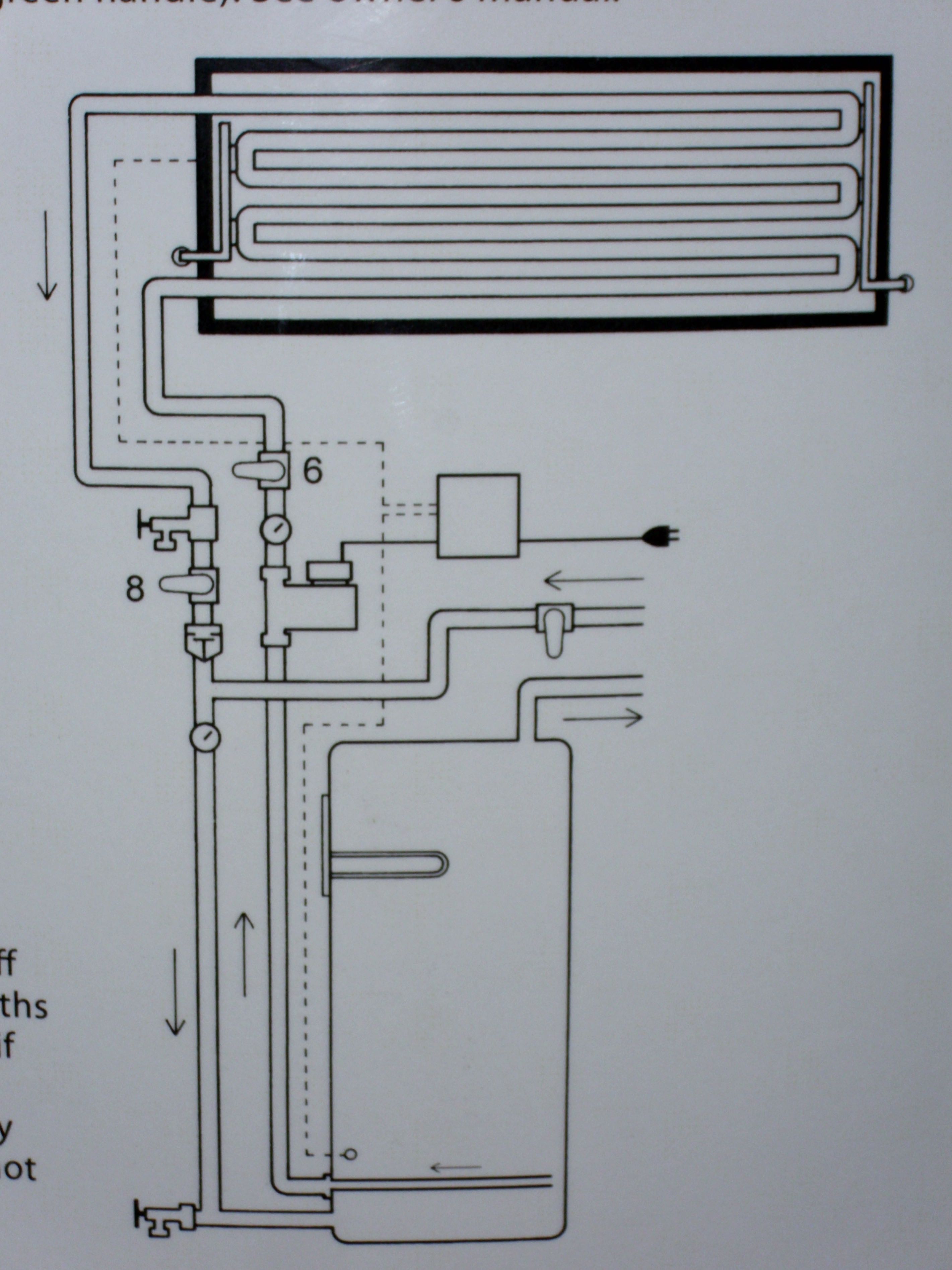

The current system has a controller on it, a Goldline GL30 and it works correctly I think. It has temp sensors, one in the collector and one near the bottom of the tank on an outlet pipe. None are wet. I would like to get the tank temp near the top where it draws off the "preheat" water for the gas hot water heater, the location after the mixing valve going to the house, along with the return from roof temp and the two locations currently on the controller (denoted on the attachment with dotted lines) . Really in the summer the preheat is way over the setting on the gas heater so it fires rarely.
Here is a pretty good description of the controller:

Well, doesn't look like that controller is going to do you much good. Where I live it would result in freezing my hot water tank in winter by trying the keep the collector from freezing...
At any rate, if you can get access to place a sensor where you want it, you can probably put together some lashup based on a raspberry pi..I'll have to look and see what they have that will work direct-connect to that w/o needing an arduino, which I think is out there, and with not much programming you could have the pi either directly display what you want, log it, make a web page showing it and so on. I don't see any obvious way to do it with that controller, and in fact, that controller is one of the things you might want to monitor-log with the pi as well. It would take a little coding to adapt one of the sample projects for the sensors to do all that, but probably not much, and that at a fairly high level...the pi easily runs apache (and probably nginx if you're a real tweaker), and does do CGI's with little effort for things like that, it's how I'm using one of mine to operate a camera as well as collect the output of an arduino with a ton of sensors on it and log it all.
Anything that thermal-cycles and hits over 100 something F degrees on the hot side is bad news for a semiconductor sensor of any kind. Encapsulation fails, and the doping of the silicon migrates much more quickly at high temperatures, rendering even fairly linert things useless in fairly short order. Even thermistors fail due to encapsulation issues. So I'd still go with a thermocouple for the hot stuff, they live really well under harsh conditions, and you can even seal them up in glass tubing if you're the worried type (and use high temp silicone gasket seal if you're not a glass blowing type). Type K couples with some amplifier with cold junction compensation should be ideal for that.
This might work for you. Type K thermocouples are cheap to make if you have the wire (I have a lot). They're also sold already welded at the junction.
http://www.adafruit.com/products/269
Edit - this isn't the only option, but probably the best one. With SPI, timing isn't critical, and you can hang a bunch on the same wires, keeping only /CS (chip select) separate for each device. I plan to use a couple here for monitoring things that have wild temperature swings, since they'll take it (and also to include my bullet casting pot). Note that their statement of possible inaccuracy of type K thermocouples stems from two separate effects - the purity of the alloys (nothing you can do there except buy the good stuff) and the fact that NO thermocouple is linear, there's actually a document describing a polynomial you can apply to the output to correct for that part, though, and it's generally most of the error.
And here it is. Took some looking, I think it got lost in the latest round of computer upgrades. Handy link for TC data: http://www.omega.com/thermocouples.html
