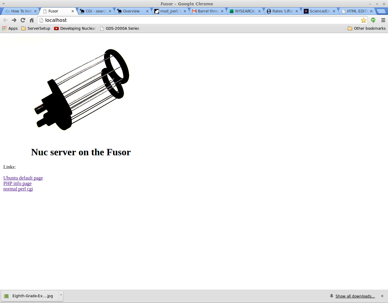

Oh, I forgot. Here's what it looks like now on the homepage. I'll be adding links to the real CGI's that will do the data aq work. Maybe some for analysis, but my rotating gnuplot in 4d probably isn't going to go browser enabled, it'll have to stay native, just be adjusted to pull from the database instead of log files.
I will probably add some features to that anyway. What happens now for a Q plot is if we get a couple neutron counts while the power supply is off, it looks like infinite Q and spoils the autoscaling seriously. I've been going through log files and hand-editing those points out for now, which is a major job. I think with SQL we can just make a query to toss the obvious outliers like that.

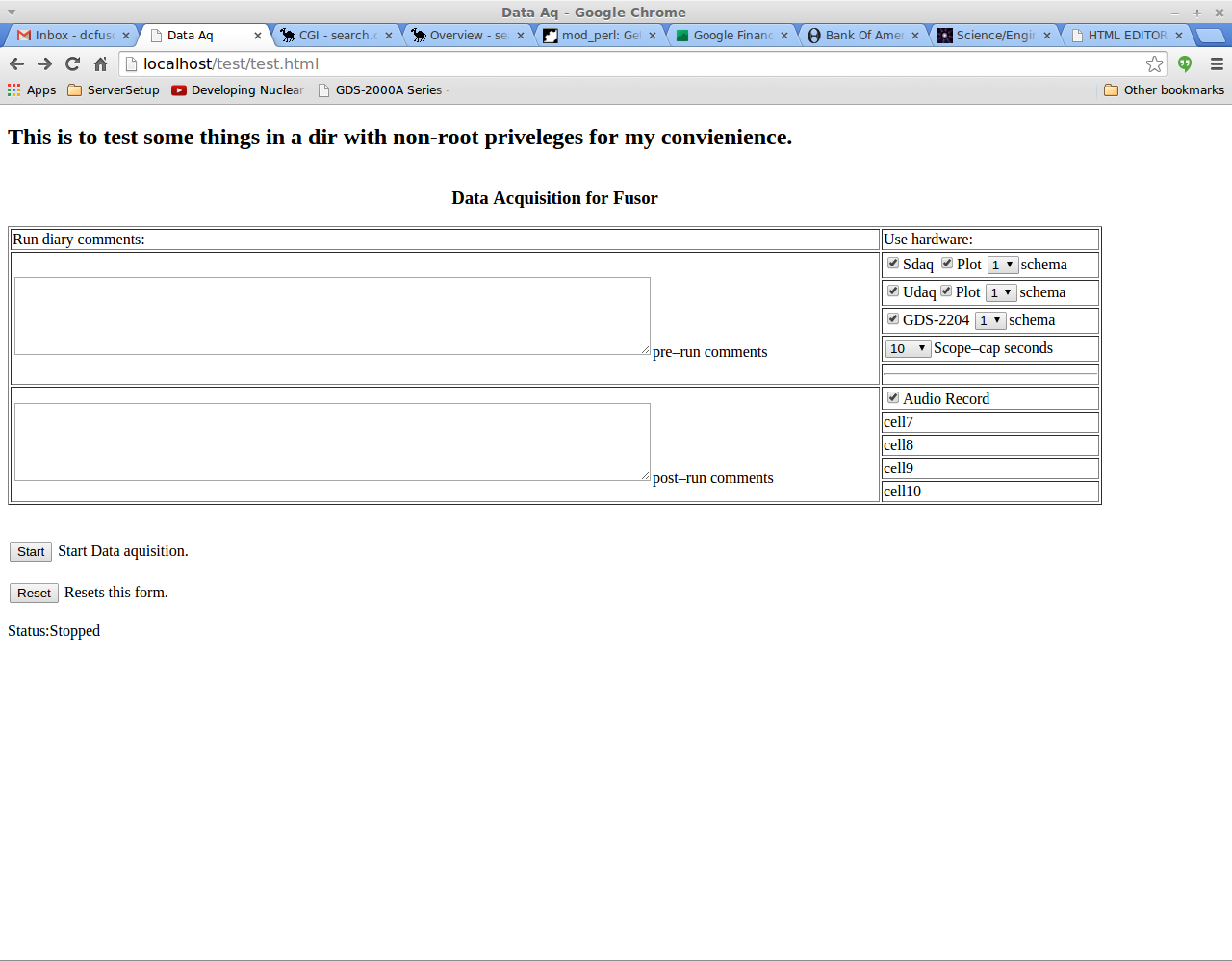

Of course, I've not even finished the HTML yet here, but this is along the lines of what I was thinking above.
In theory, this will be a CGI that auto-checks the boxes for the present hardware, and maybe remembers what schema etc you last used as well.
It will kick off another CGI (as yet undesigned) that will actually run all that stuff and shove it into the database. Looks like all the realtime plotting etc will still be native, not through a browser, as that's pretty hard to do without eating a ton of extra computer - and not needed, since playback will be possible - in non linear time just like an audio/video editor.
Other pages off the main page will let you view and edit schema for the various devices, which will hold info on what is hooked up to what, the multiplier to get to the specified units, rates, and things like that. There will be a schema table for each hardware device, and the data table for that device will have a run number. A separate "runs" table will have and create the run number (for all the other data tables) and specify which schema was used with what.
