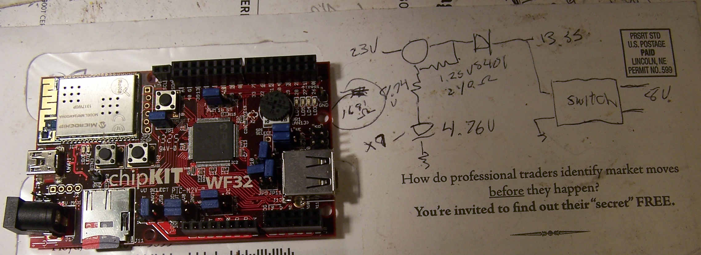

Gel cel battery to the rescue, in this case a 12v nominal 7ah nominal one. These have a tempco if you're going to use them as a float backup, so that the voltage from the charger changes with temperature correctly - else they die young, and of course, you don't fine out till right when its needed. Most UPS systems don't get this right, and it matters less as they are not in an unheated (usually) crawlspace either. But here that's where it is - with the water, plumbing, and spiders. So I need to tempco match the charger (which happened to be there already to run the plumbing pump) to the battery's desired float voltage for whatever the current conditions are over there, and for it to be reliable - once this is in, I don't want to have to fix it often.
There was already a supply with a 14v transformer, full wave rectified, with 15,000 uf filter there, for running a spot sprayer pump I use to pressurize the plumbing (yeah, I know - but it's cheap, simple, easy to repair, and rarely fails, even though it's noisy). It puts out around 23v no load, and drags down to around 16 v with the pump running, but in reality, it's all over the map. So I used an LM317 with some temperature control and a series diode to adapt that to the gel cel. Turns out that these AGM cells need about one diode/cell to compensate them, plus another to compensate the diode I put in series with the LM317 so losing AC power won't run down that little battery (and LM317's don't like backwards volts). I used a 317 rather than a higher rated part because I only had a convienient 1n5401 diode and I didn't want anything to burn out if AC was applied against a dead backup battery. It's always a question of balance in these things - the raw supply can easily fry all this without breaking a sweat (40amp bridge...14 amp rated transformer).
Now, I also wanted about 7.2v out of this to actually run the WF-32 and any ancillary arduinos from, so I added another stage to that - a little switcher I got from a chinese vendor on ebay that's real efficient, so that went on there too. Now I have terminals with nominal 13.5v, and 7.2v on top of my board to hook into the more-delicate computers and servo supplies for doing that valve work (or whatever else I dream up for this system, which might include some horsey 24v fans run at under-volt to move heat around and so on).

So, the goal is to run this thing and friends (it'll be in a box when running), and in this pic, it's sitting on the schematic I drew on an envelope, which is about what stock trading advice mail is useful for- at best. Note for noobs - click the pix and they get full sized.
Server board and schiz

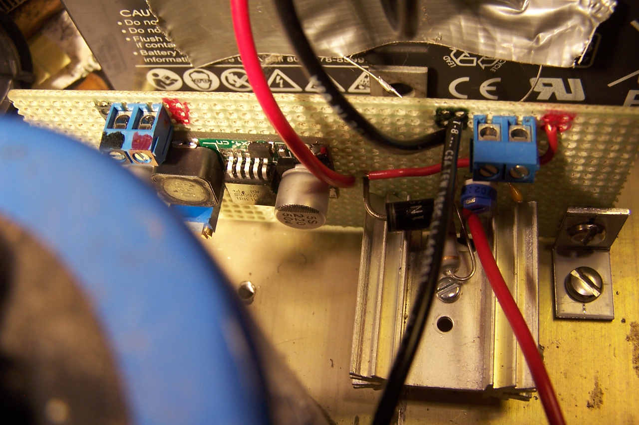

Here's the board I added to the basic plumbing power supply.
The board - this one didn't have or need solderable pads, just perf is fine, this is low-grade kinda stuff.  Only needs to be reliable.

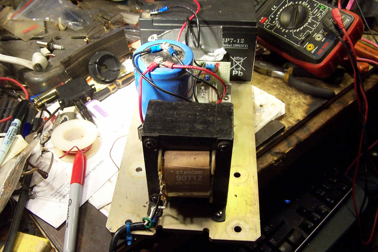

And, here's the whole mess on my messy bench just before I put it in. No pix of it in place as I didn't want to juggle the camera while fighting with the spiders and such (and the light is kinda crummy down there).
The whole mess.
The whole mess.
