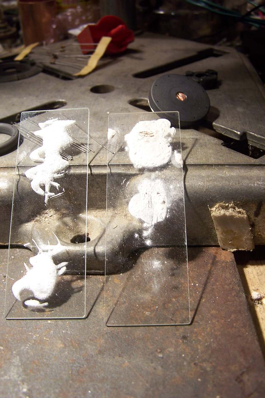

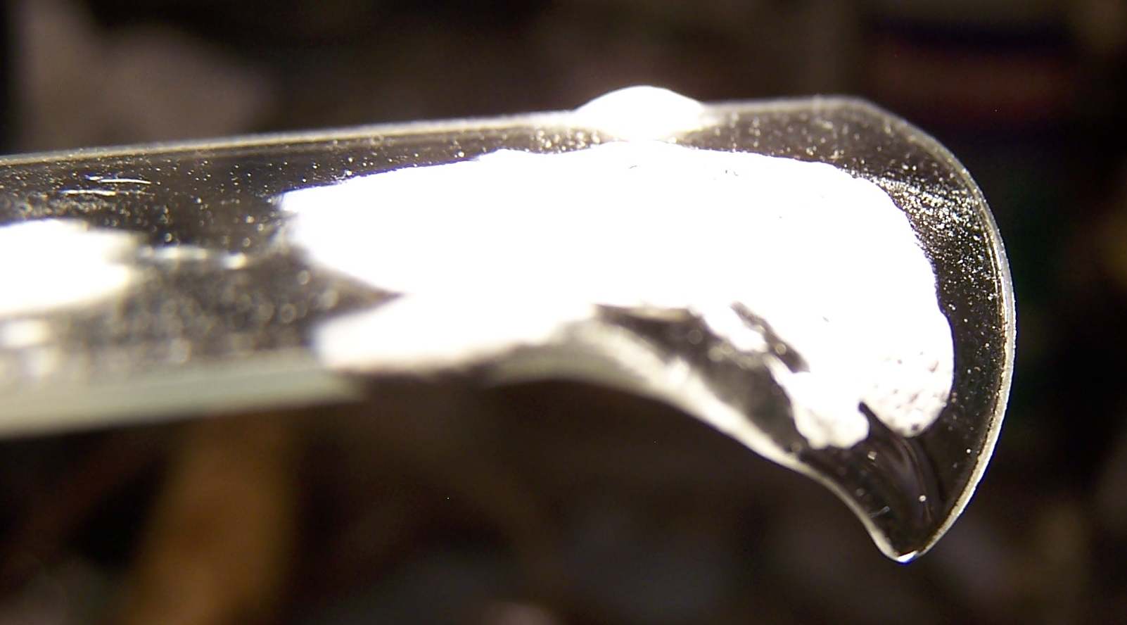

I slathered two microscope slides, one with pure sodium silicate, the other with the previously baked out talc from the grocery store, mixed thick. I let them dry, then left them by the wood heater overnight at around 120f, before baking them in the toaster oven just now. Pictures:
Before heating - you can barely see the pure stuff on the slide - almost the same index as the glass and very clear.
The pure sodium silicate turns white and expands over 3::1, while the talc mix is almost unchanged.
So, even though it's kind of crunchy/bubbly, the pure SS probably wouldn't do here - it might break the graphite. I in fact should have tried this on a graphite sample anyway, since I can heat that hotter, and "who knows" what other chemical reactions might have happened with graphite or tungsten? But this is making the talc mix look better - I think it expanded a little, but I'll have to check closer and try higher heat as well. The pure SS had done its thing by the time the toaster oven said 250f. I didn't notice a change in either sample after going to 475f for half an hour.
Now, here's the real test - orange heat with a mapp torch, enough to make the glass sag under its own weight. No damage noticed to the talc mix. I didn't try the ss pure one, no point, the bubbling (sorry I couldn't capture that in a pic) would have pushed the grid apart before it could melt or whatever it would do at "orange".
After as hot as I could get it on glass...the talc mix, no damage noticed.
Not too surprised about it, but it looks like John Strong was correct - again.

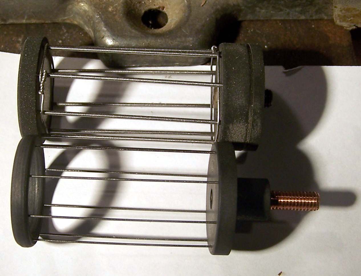

Just for fun, our oldest record-setter and the new grid next to one another. The old one has the fat wires, and they're at an angle, a machining "mistake". The "twisted" grid like to be a bit further out into the main tank, but does not throw a concentrated beam of "something that can make SS incandescent and glass crack" like the straight ones do. Perhaps I should consider making that mistake - or even sweeping that parameter space - again.
Note - the old one was shiny-smooth when first put in. It's rough now - carbon sputters a little.
