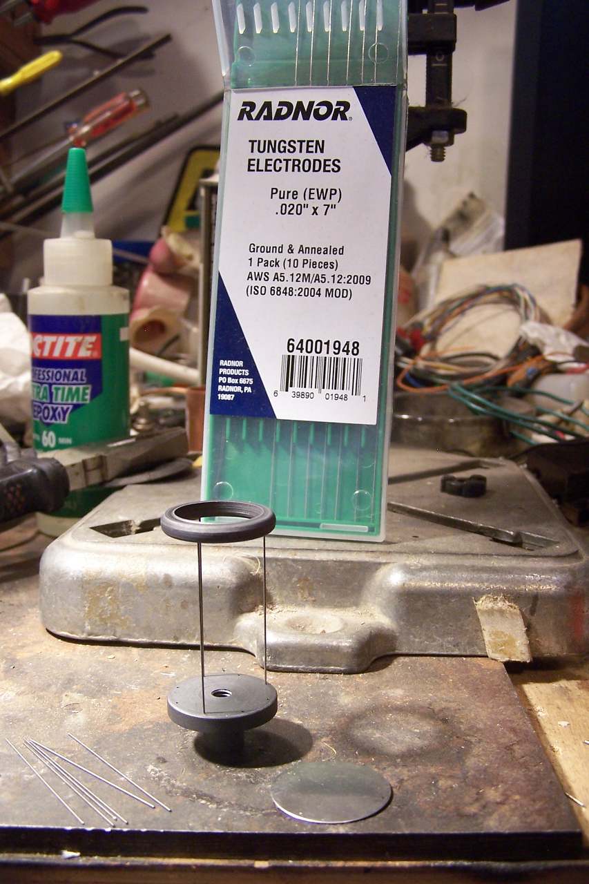

Here's what it looks like as a test-fit.

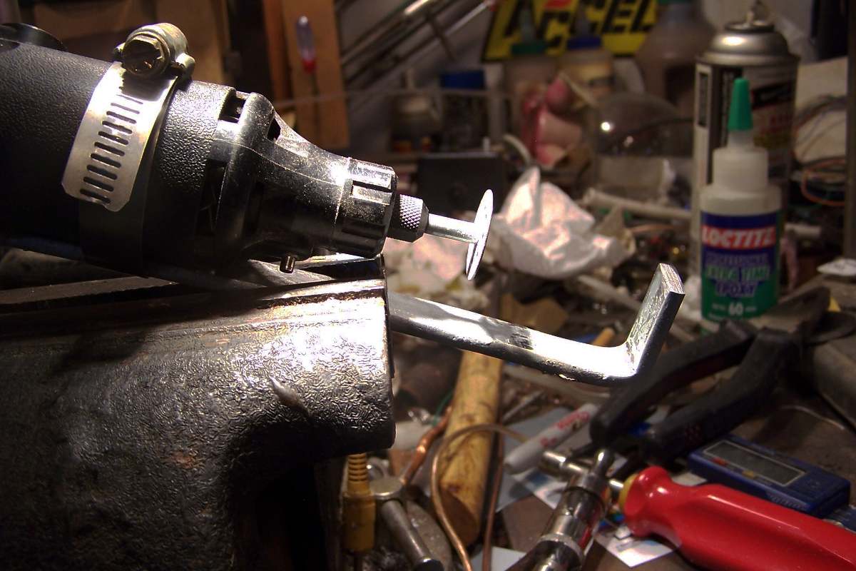

Then I had to cut (at least) 8 rods for this design. I wanted them 1.75" long, which will give me about 1.525" of active length for the rods. You really want this to have lens-like accuracy, though I'm not even to good optical, much less ion-wavelenth precision here - but you never know - it might be perfect for some part of its length. Since I've not yet adapted my dremel drill press for the new tool (the old one literally let out the smoke), I made this jig for a newer dremel (thanks BillF) that's a lot nicer motor and in better shape anyway.
These rods come very straight - the far more expensive wire from Alpha-Aesar, say, don't - and these are pretty cheap at the welding supply store. I'd used the "E3" type in the other grid, but that stuff (doped with various rare earth oxides) was just too good at emitting electrons, especially after being hit by a bunch of hot D (reduces them). So this time we're going with tried and true pure tungsten, 20 mils diameter. It tends to get pretty hot in the middle - even with a cylinder shape, and so far, almost no matter the length as long as it's a bit longer than it is in diameter, the poisser concentrates in the center of the length anyway - and that's where the wires get hot. The ends get hot too - because they are hanging out there, big, and at full volts, so they attract ion hits. At least with carbon, it's not a great secondary electron emitter, but it seems I do get some hydrocarbons from the sputtered off carbon atoms interacting with the hot D ions. I may vacuum coat this with titanium or some other high work function metal - I now don't care if it gets orange or yellow hot, since the graphite is what's holding the forces anyway, and it's quite happy well past white hot (at which point I'm more worried about my copper feedthrough stalk...). With all titanium, it got orange hot - at which point Ti has the strength of butter...this may get as hot (I'd bet it doesn't, since if nothing else, carbon radiates heat better than any metal as well as being thermally very conductive), but it won't be at risk of slumping, which I've had happen to other grids.

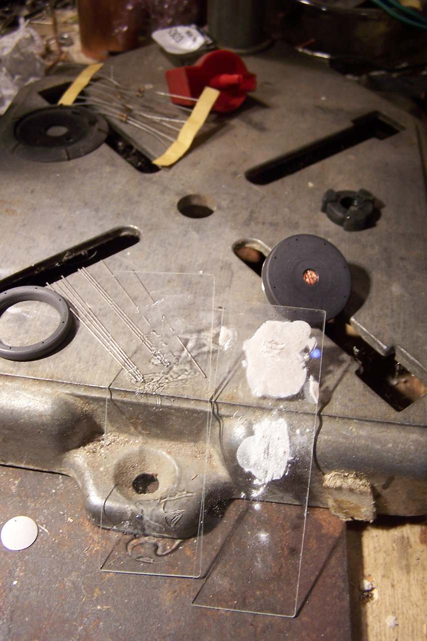

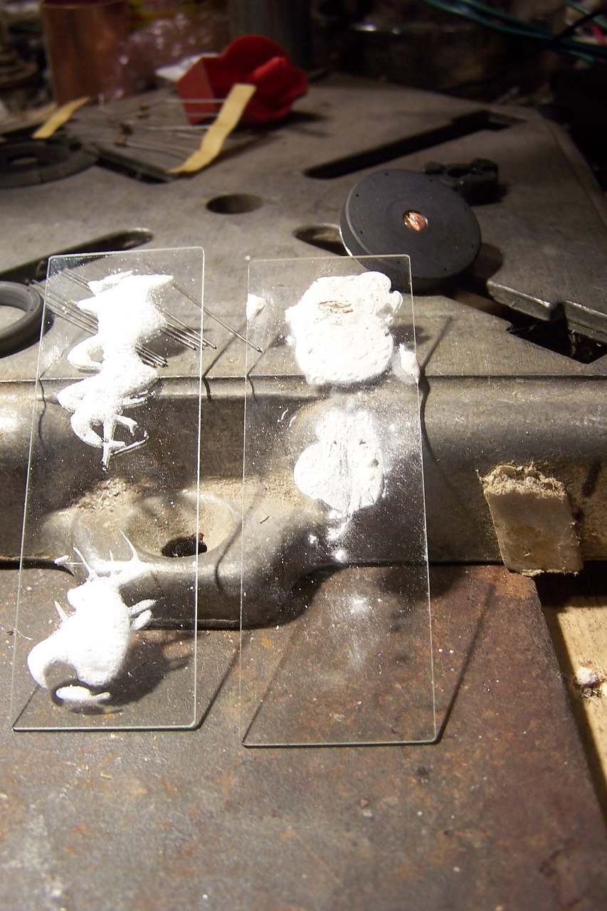

I slathered two microscope slides, one with pure sodium silicate, the other with the previously baked out talc from the grocery store, mixed thick. I let them dry, then left them by the wood heater overnight at around 120f, before baking them in the toaster oven just now. Pictures:
So, even though it's kind of crunchy/bubbly, the pure SS probably wouldn't do here - it might break the graphite. I in fact should have tried this on a graphite sample anyway, since I can heat that hotter, and "who knows" what other chemical reactions might have happened with graphite or tungsten? But this is making the talc mix look better - I think it expanded a little, but I'll have to check closer and try higher heat as well. The pure SS had done its thing by the time the toaster oven said 250f. I didn't notice a change in either sample after going to 475f for half an hour.

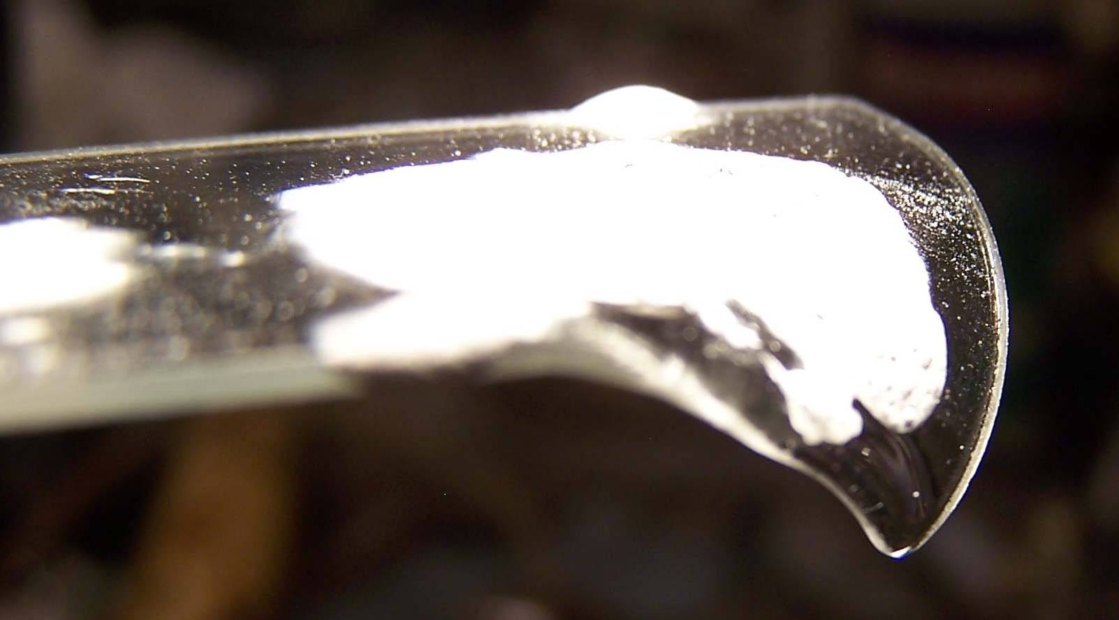

Now, here's the real test - orange heat with a mapp torch, enough to make the glass sag under its own weight. No damage noticed to the talc mix. I didn't try the ss pure one, no point, the bubbling (sorry I couldn't capture that in a pic) would have pushed the grid apart before it could melt or whatever it would do at "orange". Not too surprised about it, but it looks like John Strong was correct - again.

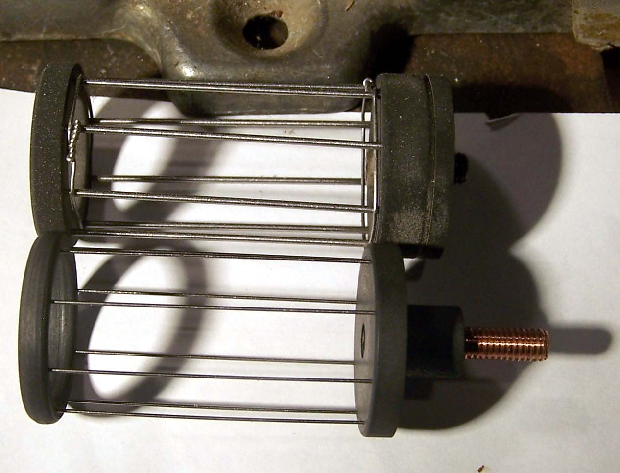

Just for fun, our oldest record-setter and the new grid next to one another. The old one has the fat wires, and they're at an angle, a machining "mistake". The "twisted" grid like to be a bit further out into the main tank, but does not throw a concentrated beam of "something that can make SS incandescent and glass crack" like the straight ones do. Perhaps I should consider making that mistake - or even sweeping that parameter space - again.
Note - the old one was shiny-smooth when first put in. It's rough now - carbon sputters a little.

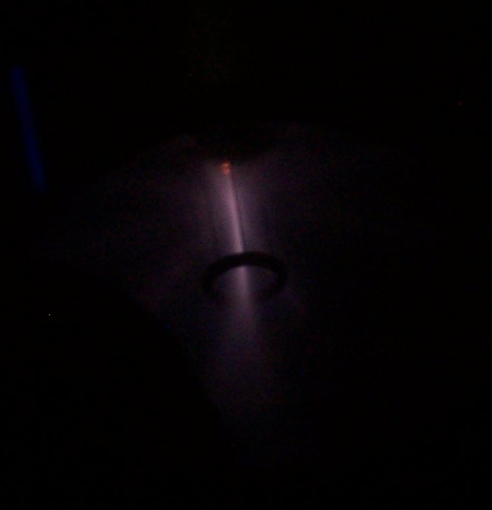

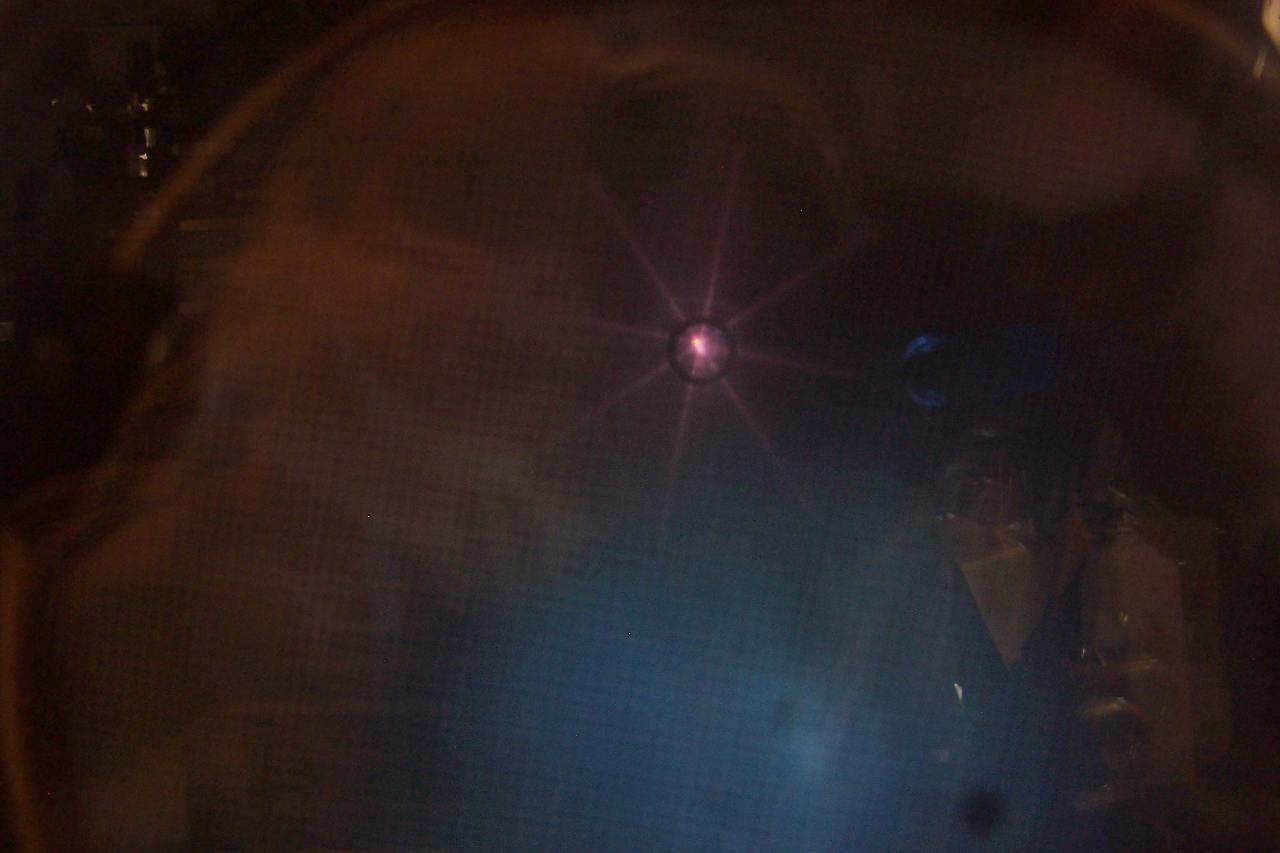

Yup, it works, a little better than expected in fact, easily broke and held over 2m neuts/second at reasonable input power, though it would go higher and take all I could put in (which is quite a bit, I stopped at 50.2kv@25ma). And that's despite a wrong placement. We've found that placing the grid-end more or less flush with where the sidearm meets the main tank is far better than the 1/2 or more inch recess I have here due to having put in a spacer for the older, longer grid. Here's some eye candy.
And, from the top. Kind of hard to see here, but the poisser does tend to concentrate around the middle of the length. You can barely see the rays here, I've done better shots of this effect, but this is what I got today.

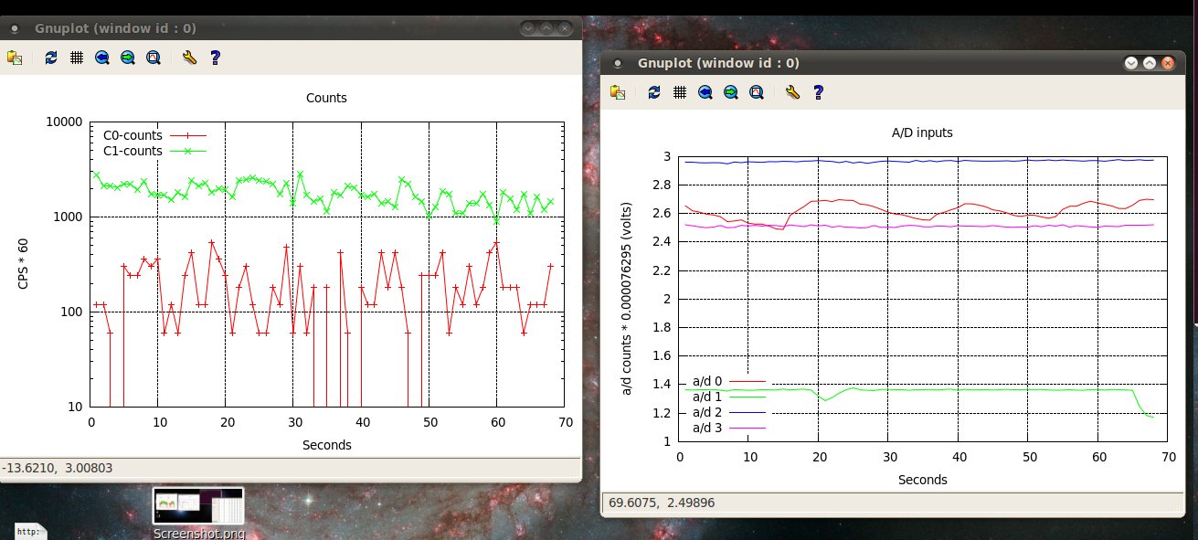

And a tiny bit of data. The green counter is 980 cpm/million neuts second.
Now the system is in pumpdown for a few days most likely. I may re-space this to the place we know seems to be best, or not (it leaks a bit of shop air in when I let the tubing coupler move), or just try the next step (deliberate pops mode) as is, since we don't know what will work best for that. Satisfyingly, it went down to 1e-6 millibar almost instantly when I turned on the real pumping after these check-in runs.
But I like to see e-8 and below before I trust things are pure. That will probably take a couple of runs.
I really like the way this handled heat - even with well over a killowatt in, the base got to dull red at most, and frankly I couldn't see the rods glow at all. Very minimal break-in arcing, just a couple sparkles and it was done. Oh, and no glue used at all - it was such a tight fit when I test-fit it I was afraid to damage it pulling it back apart - I wanted precision, and from the focus on the beams I saw just now - I got it. No bent rods.

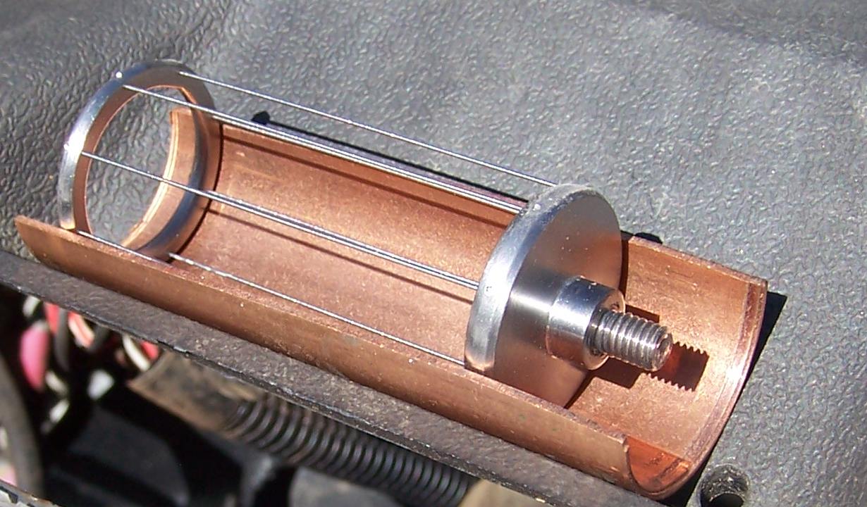

Here's the grid the new one replaced. It was pretty good, but was too long (wastes power) and got too hot (Ti isn't the greatest heat conductor). It got orange hot all too easily, and I was afraid the end ring (butt welded Ti wire) would slump. This one used E3 rods, and it just emitted too many electrons as well. Looks purty, but...that's not all there is to this. Staking in the rods spoiled the accuracy a little as well.
