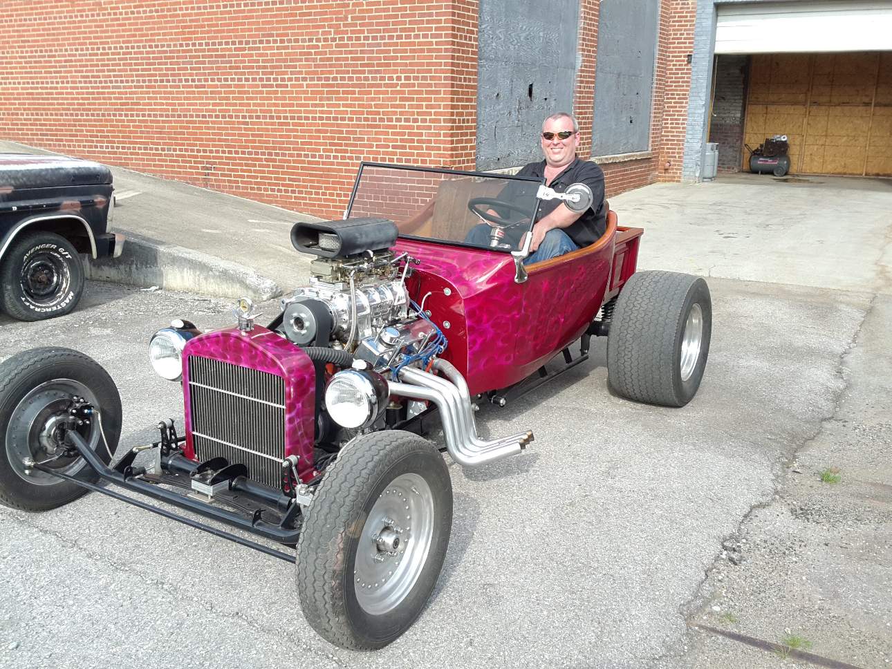

Personally, I like roots for this:
http://youtu.be/EXnkTsU3bsA
There will be more of this if Vice ever gets around to airing the piece they did on me last fall, when this was taken. Their cameraman, though brave and strong, could not hold his camera during a 0-100-0 run in half a mile - he got great footage of the sky and his feet, though.
The car (I helped build this, a little, for my good friend John) has nearly 2hp/lb. Yes, it's very fast. Getting sideways at 100 as you cross old railroad tracks in an industrial park was, well, a bit exciting - not bad. Heeeeeeeeeerrrrres Johnny!
