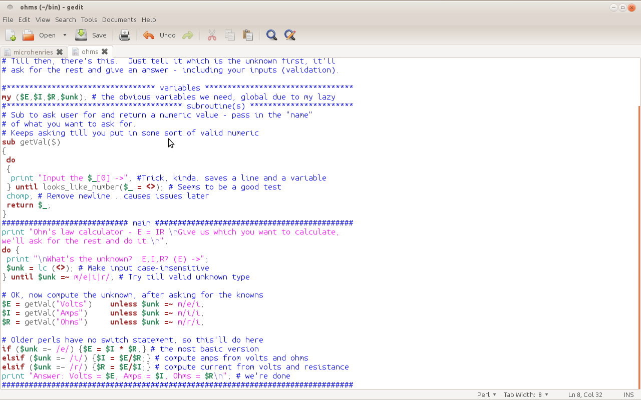

Well, this isn't the purty version - it's text-only, cross platform (tested on linux) and in perl. I want to someday make a fancier GUI version that lets you just fill in the fields you know and then it fills in the unknown, but haven't bothered so far (some of the UI design elements are sort of challenging if I don't make you click a lot).
So here it is as perl code. Note, it looks a whole lot better looking at it in something that knows how to color-highlight perl code, like gedit, padre, geany...tons of other editors. But for inclusion on the board, at least for short stuff like this - it seems better to just let you cut/paste out of a "code" block into the editor of your choice, put it somewhere on your path, and mark it as executable so you can just type whatever you named it. I just called it "ohms" here. In windows, you might need to add .pl or something to make windows know it's a perl executable. Yes, there is perl everywhere (even android, sort of). You can get it for windows via getting padre which installs DWIM or strawberry perl along with itself - free. That first funny line is how we tell linux where to find the perl interpreter - windows will likely just ignore that.

See how much nicer it looks in a real editor? In this case, gedit which is simply a smarter version of notepad.
Highlighted so you can see it purty
