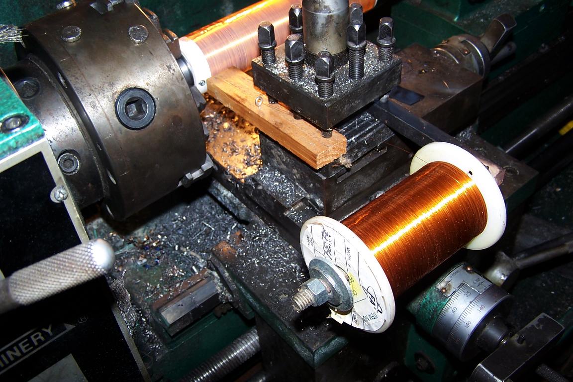

Well, it's not an official coil winder - for one thing, it lacks a turns counter. Which turns out not to be so bad in real life, at least for the stuff I do.
Here, I'm winding an inductor, or perhaps a transformer primary, for the HV line in the fusor. Since I don't yet have a clue what the desired frequency to make this "tube" oscillate at is - for most Q of course - I figured I'd start on the low end with around 4.5 millihenries.

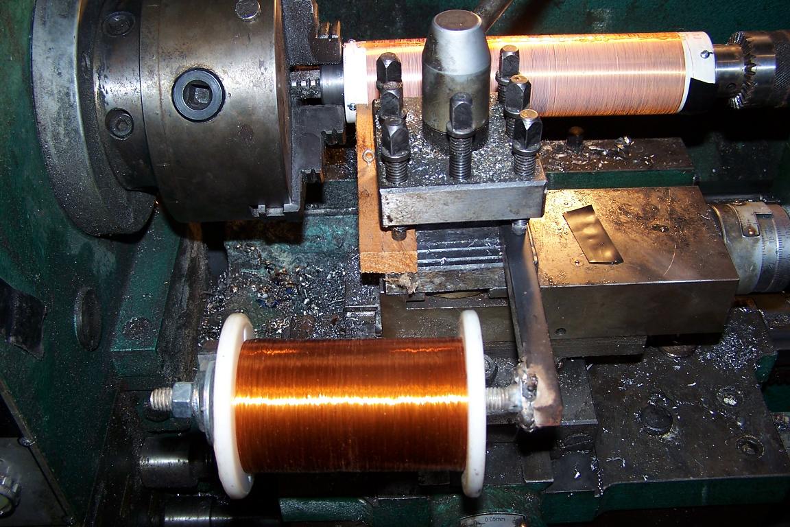

These are the jigs I use:
From a few angles. All it really is, is a way to hole a spool of wire oriented the right way (it's a very loose fit on the "axle"), and a stick of wood with a small eye (to make the wire come to the final spot going straight) and a slot in a piece of soft wood - the final wire guide. Here's some more views:

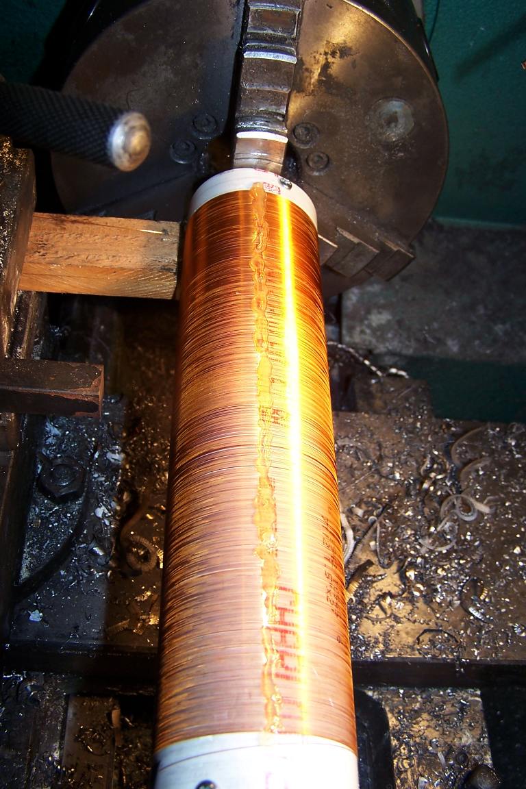

In this last one, you can see the bead of "hot glue" I stuck along the length of the form to hold all the wire in place. This isn't strictly needed, but I do it anyway.
I always do use the hot glue at each end, as having it all unwind if you "oops" is kind of a pain, and a start-all-over-again type of proposition ($).
I wind at 1 tps (60 rpm), my lathe's slowest speed. This particular coil was using the threading feature of the lathe at 80 TPI, and using #34 wire, so there's (in theory) about 4 mils in between each turn (the diameter of the wire is a bit over 7 mils). This is a fairly good number for standing off arcs, since the theory is that the volts will divide equally among the around 620 turns of wire shown here. Or at 50v at one end, arc at the other, about 83v/turn. Heck, the insulation alone should take care of that and not even need airspace. But real life says - have the air space just in case.

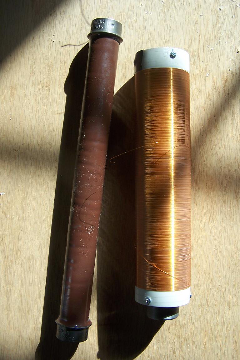

And, here's the result, all ready to stick in there and try stuff. I've not yet measured the millihenries, but it should be on the close order of 4.5 (neglecting end effects of my HV system adapters and so on), from the # of turns calculated by the effectice series resistance...and those nice wire tables.
You'll note that you can see a bit of "outie" sticking out of one end of the coil, and while you can't see it - there's a matching "innie" at the other end. These are about 1.12" diameter for the outies, and about 1.15" diameter for the innies, and I use a few set screws to hold things together in use. This way, it's all "one stick" that I then insulate and shield - it's more or less a big piece of hardline coax in use, which saves my shop a ton of EMI in arcs, and makes things safer in general.

You decide how tight you want it. For this one, since I was using pretty thin wire, I provided winding tension with a fingertip on the source roll of wire, and a pair of fingers guiding the wire between the coil and the jig - to wipe off any dirt and to feel any nicks or whatever. If you're doing this with say, #10 wire, you'll have to be pretty strong to provide enough tension....practice a little before going for the real deal.
