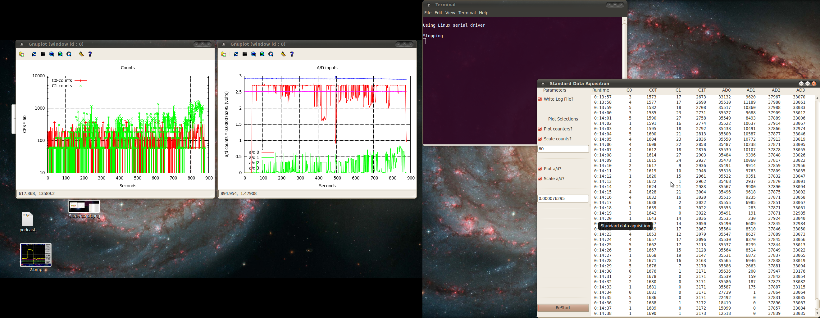

Here's the very raw data screenshot of the entire data aq.

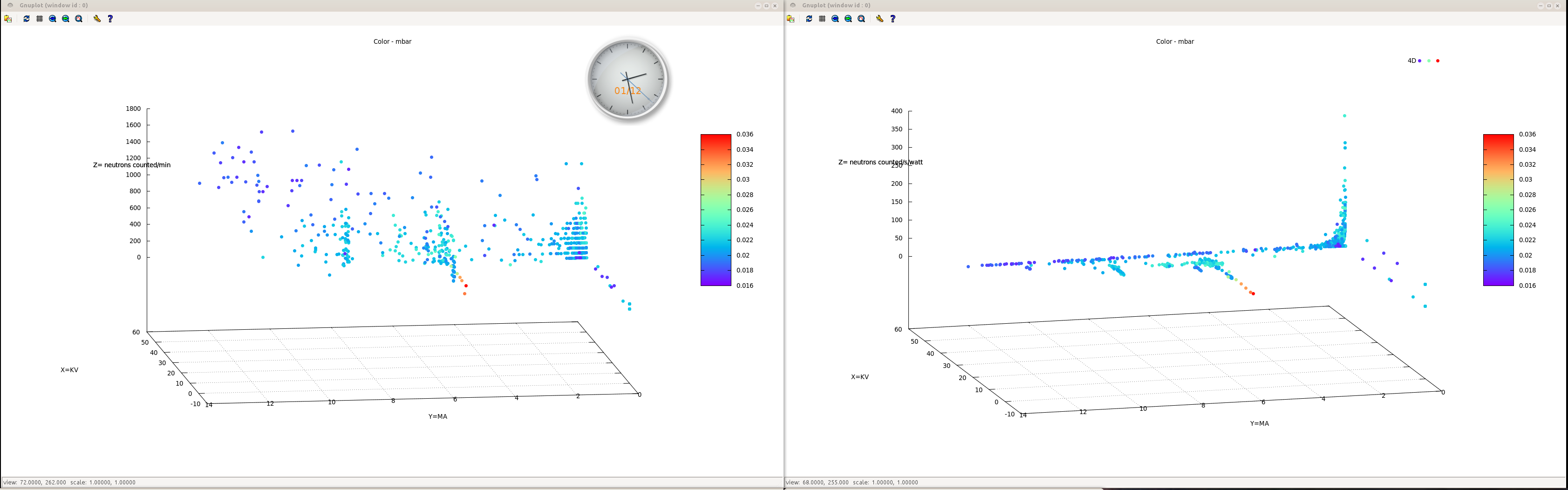

In the meantime, here's a screen shot showing raw (but in real units) data, and as my version of Q (which is neutrons/min counted divided by watts input, not a real Q or we'd be there already by a fat factor!).
Warning, this is one big screenshot...4 hd monitors worth. Oops, it wouldn't even fit here, I'll do some slicing and dicing so it will.
Here's the plots themselves. The one on the left is raw neutrons, the one on the right is "Q". The rest I cut out, as it partly is dupes or just the UI of the plot program.

One bad thing about the scatter plots. They don't show time at all. Now, I can change the code so that for instance, it draws lines between the little dots with arrows on the ends, which will tell something about the time, but makes the plots "hard to see" with all the extra pixels from those lines, and the tiny arrowheads. I will probably try that at some point, and if I like it (for this type work) I'll add it as an option in plotdat (the software) which is posted elsewhere up on the forums. At the moment, I still remember when I was doing what - for example, those red dots - that was startup with too much gas and a 5 ma current limit. Going up that line towards the full supply voltage was me taking gas out till we went under 5ma, or just went out. Then I started fooling with the ion source. At one point, I let in more gas again (the pressure was dropping due to "cleanup" in the tank) and pulled some back out - but it's hard to see on this, since it would overlay more or less the same line. Near the end of the run (as you can see on the time plot screen shots) I DID raise the current limit for a few seconds, just to see what that was like. No surprises there - the neutrons went up as Q went down, as usual.
