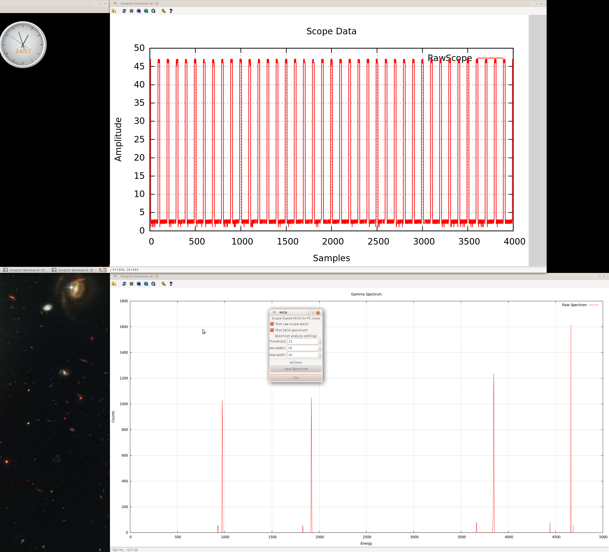

This is just a teaser - I'll publish (GPL v2) the code once I've worked out a few more bugs, but this is fantastic. I'm using a GDS 1022 DSO scope (eg, the cheapest one on the market) to acquire data (in this shot, just from my signal generator) and make energy spectra from it - as good as those multi-thousand dollar units as far as I can tell.
A few more days or so of work on this and it'll be done and a handy tool in the lab. Most of us have scopes that talk this protocol (GW-Instek and tektronix) already, and a PC of some kind. Sorry, this is linux-only at present. You could run it in windows if you have perl, the right perl modules, and gnuplot - all available for windows, but if you're going to go to that much effort, let me reccomend getting Virtual Box and say ubuntu 12.04 or Mint 15 and just run it there - VB lets you have access to USB devices, and this doesn't hog a CPU all that badly...
What it does is periodically screen grab the scope - you set the scope up for a good looking signal from your detector, and you're good to go here. I give you a raw scope plot so you can get the numbers to set up the MCA parameters for your situation, and I do some "tricks" in signal processing to improve the resolution a normal cheap DSO has, the picture tells all. Those tiny peaks are bugs - I'm working on that one, but it's after 1 am...so another day. The other peaks are simply what happens if you change the scope gain during a run on the same signal, just so you can see how well this works otherwise. Heck, I'm impressed even if it was me doing it.
Screenshot of the two plots this makes, with the program GUI on top of one of them - simple, eh?

Yup, there had to be a better way. A soundcard is just too slow - if you "shape" the signal enough for it to see it, there's just too much time-smear to handle any decent count rate - pileup kills you at even pretty low rates, and after all that low passing, it's hard to detect, it just smears everything out in the result. Not to mention the impulse reponse of a delta-sigma a/d is well...interesting (and usually over 40 samples long at a mere 48khz sample rate). Though you get fewer bits with the scope (it's about 9), you get a lot more samples, and you need no shaping at all for an NaI-class signal - you can adjust to get quite a few samples during each pulse to integrate the energy over.
While this particular scope won't quite do for a fast plastic scintillator on a fast phototube - well, those have horrible resolution anyway, since often much of the energy compton scatters out of the plastic.
Not having a nice cryo germanium detector, I have no clue what those signals look like, but if they are within what a scope can capture, this should do fine. You just need to set the sweep speed fast enough to capture a number of samples per pulse so the integration trick (which is really summing) doesn't have too many errors. Done right, you actually get more bits resolution than the native a/d gives.
Here, all I'm doing is detecting each pulse that starts below threshold, goes above it - integrate (sum) all the samples above threshold, and call that the "energy" which I use to decide which bin in a histogram to increment. The width minimum and maximum are designed to help with noise and pulse pileup situations. Evidently, there's an edge case I missed in the little state machine I coded to do all that; the capture from the scope itself now seems perfect - which turned into quite the chore on its own. It seems the GW-Instek imperfectly reverse-engineered the tektronix protocol, and the guys who wrote GDSH (a bash shell that also talks "scope") added another layer of not quite getting it. The upshot is that these scopes are quite picky in how they are talked to - too fast and they choke, too slow and something crashes - I got quite a bit of excercise getting up to power cycle the scope whilst working out that part of things. I don't bother to ask the scope about its timebase or vertical scaling, since that doesn't really matter here - you gather the pulse threshold, max and min width data simply by stopping the thing and looking at the raw scope plot, which is in 9 bit binary vertically, and sample number horizontally - gnuplot tells you the H and V numbers for where your cursor happens to be, so you can pretty quickly read that off a sample capture and set up the real MCA numbers.
I'm aware there are some theoretical issues with this approach. Pulses that just barely break theshold will add up to smaller numbers, since some of the pulse was below threshold - and it's a larger fraction for a small pulse than a large one, so the horizontal scale will be slightly "exponential" - small things will be off to the left, and large things off to the right, a little bit. I'll be testing with a real set of sources as soon as I get satisfied that I have that glitch handled on a "perfect" signal from my signal generator first - for example, the two main peaks from CS-137 are pretty far apart - one very low, one at 662kev. I might figure a way to linearize against that, we'll see - the code is actually pretty compact as of now, but then I do have a lot more freatures planned eventually.
I feel like I'm not losing much of anything here by only grabbing chunks of data - of course I have to ditch pulses already in progress at the beginning of each record, and those that don't end by the end, and I miss some data entirely during the time I'm analyzing the last record and waiting for the scope to send me the next at it's own sweet speed (not that fast). But since radiation is random as it gets, timing wise, as long as I get enough - I should get good spectra. If what I'm trying to measure has a periodic component - say 120hz ripple on a fusor power supply - I could get into issues with it "beating" so to speak, but we'll just have to see about that. I don't think it's going to be much of an issue in real practice.
