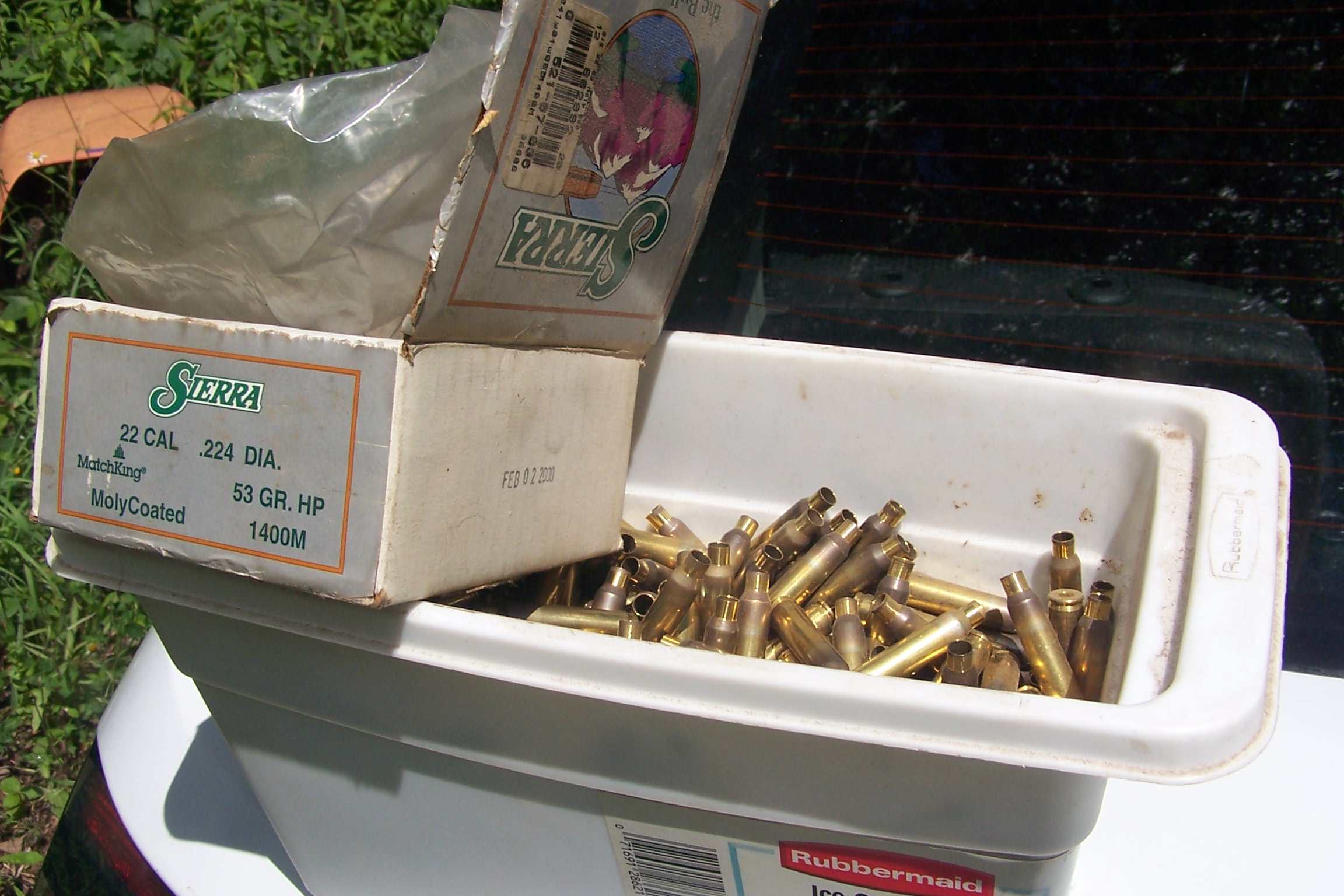

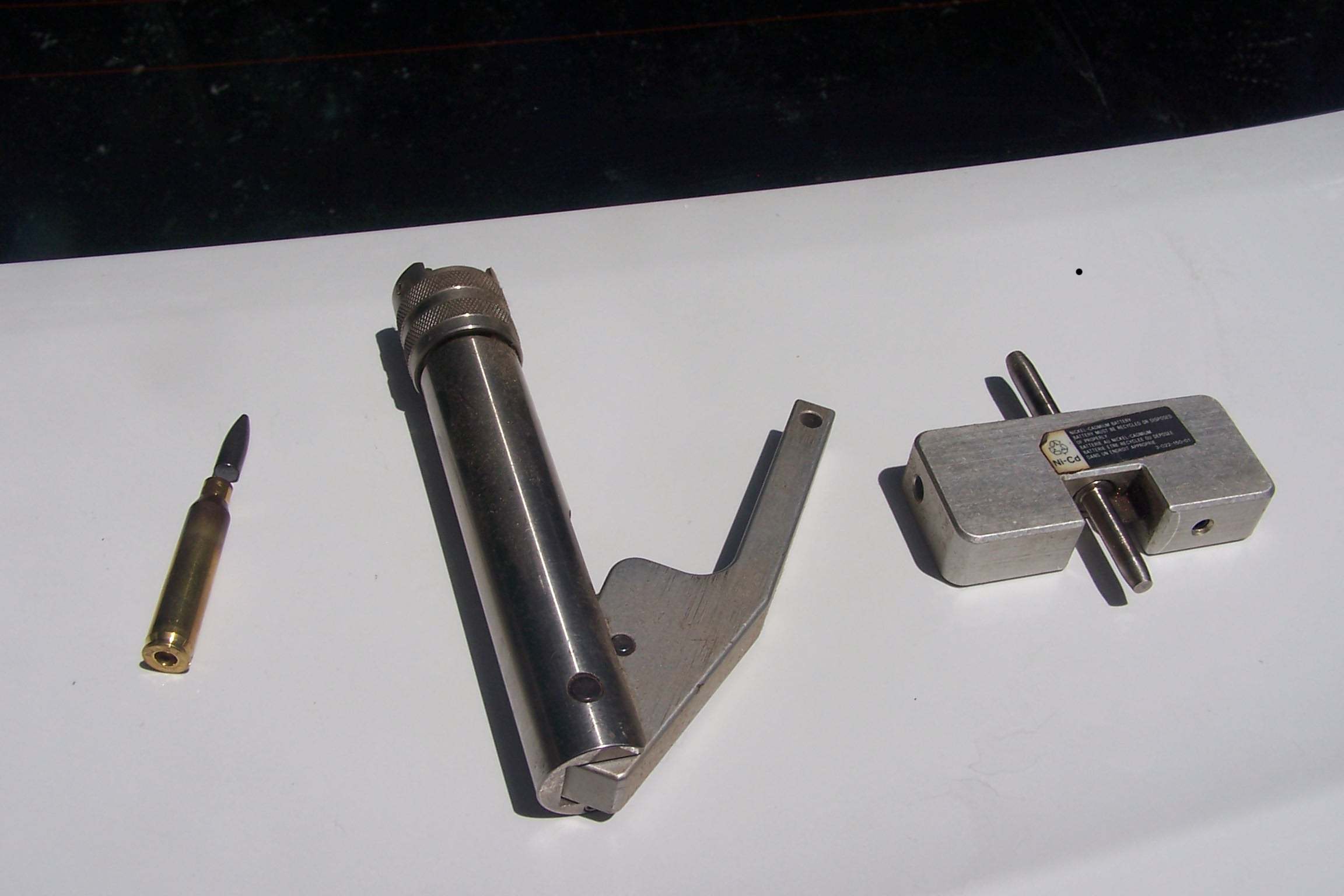

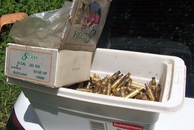

For fun, here's a little "gun guy porn" of some of the brass I'm currently in the process with - lake city in this case, you have to keep trying things to stay on top (ask David Tubb about this) - and the nifty (but expensive) Sinclair priming tool and neck turner tool I use. I chuck the neck turner into a battery portable drill on slow speed and hold the brass by hand for this, so as not to leave clamp marks on it...it's a bit of an art, and by-feel, as is the priming tool, but it's the only way to get perfection, so I tolerate the inconvienience.
If you look carefully at these (as usual, click the pic for a full size view) you will see that I didn't quite fully turn the necks, and a small amount was untouched by the tool. This was deliberate, and doesn't seem to matter. For moly bullets (I'm using Sierra 53gr flatbase moly for 100-400 yds in this gun - 1::13 twist) - you want a strong grip so I wanted to leave the brass as thick as possible for that, without compromising too darn much. I load these about 15 mils into the lands, enough so they just push back into the neck very slightly (in this case, about 5 mils) when chambered, breaking any inconsistent static friction they may have developed between loading and shooting. Did I warn you this can get complex?

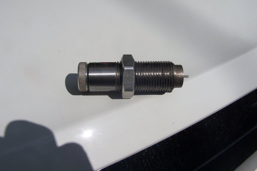

Since I've reamed all my primer pockets to uniform depth, and utterly flat (unlike the way thay came) - even if it means they are a little deep (easily compensated by the Sinclair primer tool anyway, and my guns don't care), all I need is what amounts to a perfect little screwdriver. Essentially, I take a small piece of soft steel rod, and grind a screwdrive end onto it, then grind it so it fits the pocket diameter perfectly. Chuck that baby into the ubiquitous Makita or Ryobi hand drill on low speed, and doing a perfect job cleaning primer pockets becomes easy and fast. Not all of this is that complex if you think about what problem you're trying to solve at the time. I just hand-hold the brass for this job - you don't want to push too hard and scrape any amount out, just the crud from the last primer that was in there.

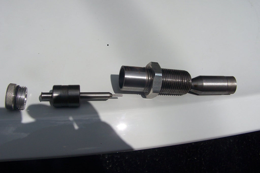

For neck sizing, I use Lee's collet neck sizer. I found I had to turn down the inside shaft a couple of mils to get just the bullet grip I want. You must use one of these in a single stage press, and set it up very carefully. Lee deliberatlly used an aluminum top screw - and if you put too much force on this, you WILL break it (I've had to make replacements here, but then, I have a machine shop). If you set it up just so (do use the lock ring and the same press and shell holder each time) - you can just run the handle of say, an RCBS rock chucker press all the way down and get really uniform results. The unique construction of this die is such that the rod the case necks are being squeezed against by the collet is centered at the top by the assembly screw, and at the bottom by the flash hole - so the necks come out perfetcly straight. And this matters more than anything else, it seems, and matters even more if you can't load to the lands of the rifling (as in say, an AR-15 with a long jump).

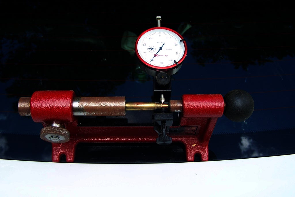

Yes, I have tools to measure Total Indicated Runout (TIR). The Hornady tool is a good one, I like it better than the other one I have. In theory, you can also use it to bend crooked ones back straight. Don't do this! They'll recover their original bentness in part between the time you do it and the time you shoot them, so it doesn't really help. Those tools are mainly to help identify process issues you then go fix to prevent making bent rounds in the first place...that's how we roll. Chamfering - I use one of the commercial tools, chucked into a special, tiny, desktop drill press running about 100 rpm, and just hold the brass up to the bit for a short time. Works great, it's slow enough that it's easy to do uniformly (and doesn't have the oops of a sloppy drill press stop you can just force). They chatter a little...it doesn't seem to matter. Of course, after all this you put the prepped brass through the cleaning process again, to get rid of any shavings, round off any sharp edges, and so forth. That's not real hard work, since all you have to do is wait for it to get done.

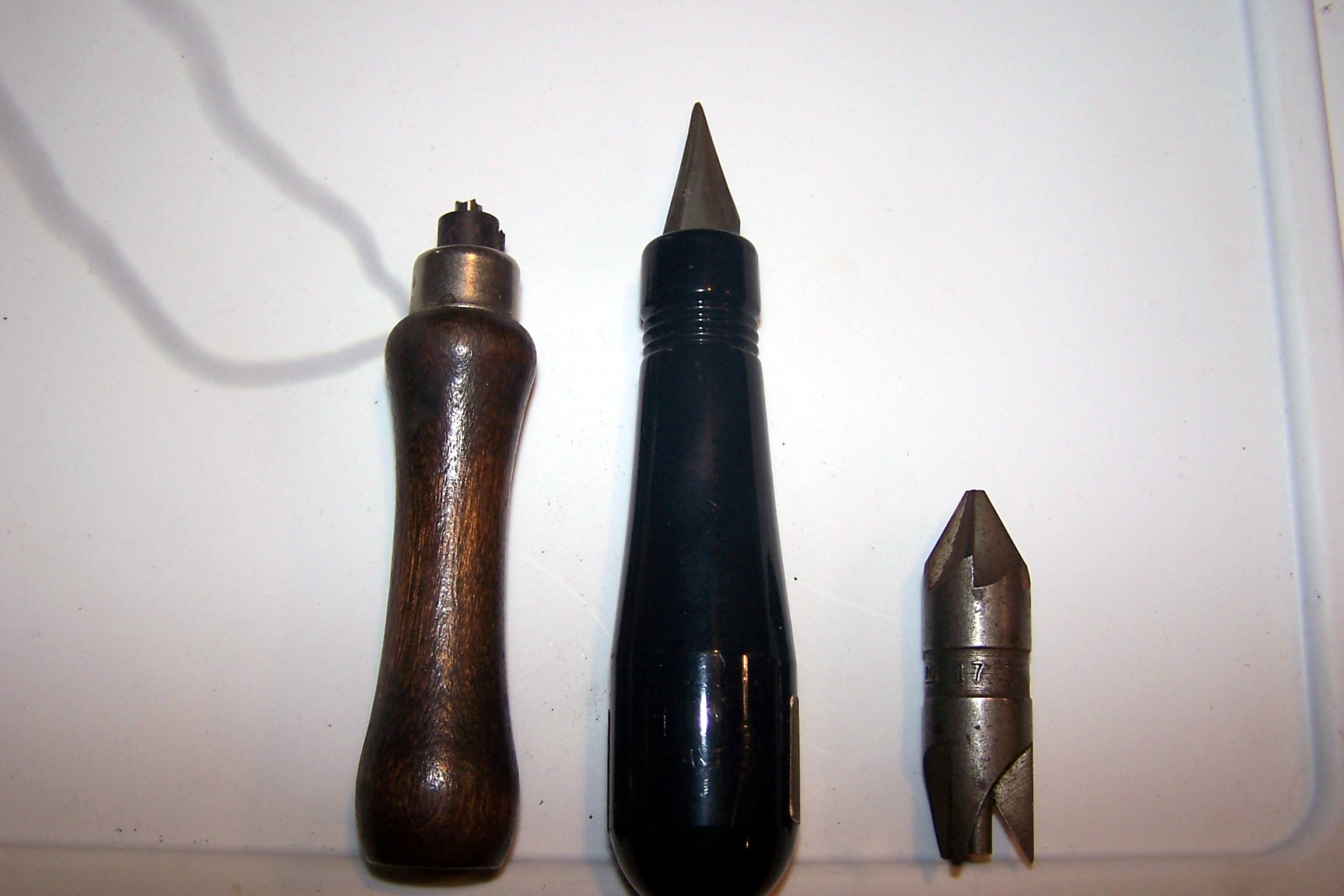

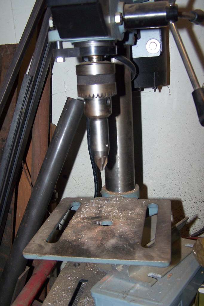

So, how do we get those primer pockes just so? Using a special tool, of course. This one I got from Lyman (via midway). It's the one on the left in the picture below (don't forget, click the pic for a bigger view). In the middle is what's called a VLD reamer, one with a shallower taper than the normal chamfering tool at right. I got this in the search for hyper accuracy, but I can't say it makes any big difference over the one on the right, which is cheaper, and drill press mountable with a special socket mount you can get from Sinclair, or make yourself.
I also set the pocket cutter a couple mils "too deep". This ensures I'll cut every single pocket perfectly flat, edge to edge, and my priming tools and guns don't mind a little bit of a recessed primer. Most guns have plenty extra firing pin extrusion length, unless they have a serious headspace issue (say a very old and used mauser is the only one I've had issues with), and those guns, well, we're not talking about competition with those - you fix the gun first, understand?
The pocket reamer can be set for a precise length via an adjustable stop. It will also remove any crimp from a military surplus brass that had a crimped primer pocket. I don't find these to be as much of a problem as many say they are. Since I always pay attention to how primer seating feels - no matter what seating tool I'm using, I find it not so hard to tease in a new one even if the crimp is still there. Slows you down a little bit, is all. No biggie. But for hyper accuracy, yeah, no variables, we cut that crimp out of there.I also set the pocket cutter a couple mils "too deep". This ensures I'll cut every single pocket perfectly flat, edge to edge, and my priming tools and guns don't mind a little bit of a recessed primer. Most guns have plenty extra firing pin extrusion length, unless they have a serious headspace issue (say a very old and used mauser is the only one I've had issues with), and those guns, well, we're not talking about competition with those - you fix the gun first, understand?
