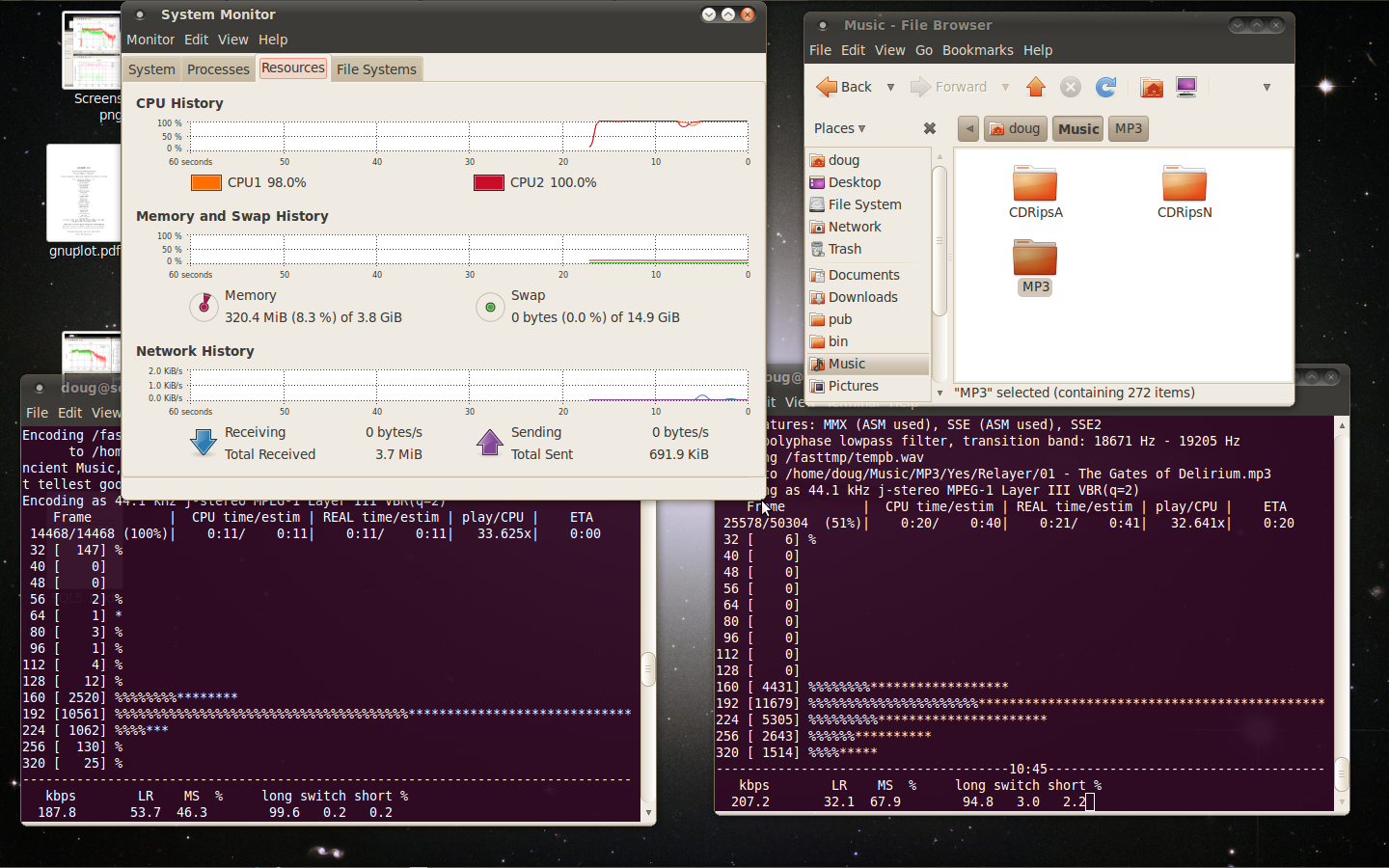

No pix, no attention span. So here's a screen shot of this maxing out my main server (not my fastest machine, just the most efficient one so it can be on more often - on solar power).
Make those cpus get hot!

Well, this ran overnight and converted 6550 and change files, with one burp when it encountered a non-flac file and one of the two instances died. I added some code to prevent re-occurrence of that, but the job is done now, and I'd posted this code to show how, not so much as a product. I'll get the newer code (basically just ignores non-flac and also now won't reconvert something it's already done so it didn't have to really start over from the beginning) up here at some point (it's on another machine here, one that has my best mips/watt ratio).
