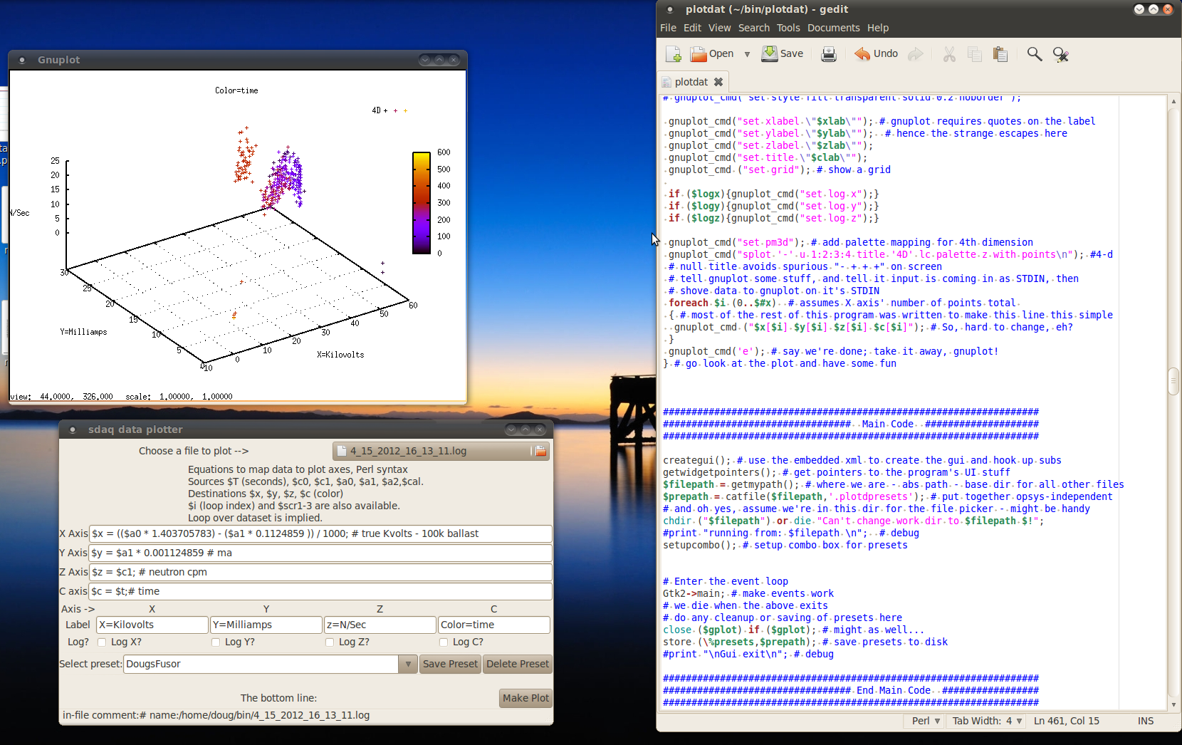

Here's what the GUI looks like.
screeenshot
screeenshot
For each (currently) possible axis, I simply allow you to type in perl code to map whatever onto whatever axis. Yes, this means you have to know perl syntax, and you have to know what the available input and output variables are. In this case, $x means the X axis data. $a0 is a/d channel zero, $c0 is counter zero - it's pretty obvious. And if you speak virtually any computer language, you can do this one pretty easily. You can even have multiple lines of code (perl doesn't need a <CR> between lines, just the semicolon terminator for each). Here, for the X axis, I have a signal from the power supply that says what voltage its putting out. Fine, but I have a 100k resistor between it and the fusor, and I want to plot the ACTUAL voltage on my grid, so I use a signal that tells me the current drain, so I can then calculate the drop.
Of course, for ohms law to work and this come out in kv, for example, I need to have the right scaling factors, which I got the good old hard way - set the supply to say 50kv, look at the raw a/d numbers and calculate a scale factor, manually. Ditto for things like supply current, and the pressure signal from the gas gage (not in these files, but I have it working now). You can then type various things in for axis labels, decide if you want log plots in various axes (haven't figured this out for color yet and may remove the checkbox) - then hit do plot and bingo. You now have a 4d plot you can mouse around in and twirl to any viewpoint to see your patterns. Since there is some setup involved in getting to a plot - I provide presets saved in a file to handle that more easily, and you can add as many of those as you want.
In the case of this plot (go run this, the log file is in the .zip so you can) I mapped time in the run onto color. You can see when in the run various events happened, and where the most neutrons came out. For fun, near the end of the run, I cranked up the power supply current limit - one gets tired of dumb kids (or adults) saying it's obviously going to work better with more power. I rest my case - go look. Obviously, the neutron production function is going almost straight up as I hit my 50kv limit. The L shape you can see is what happens if I don't control gas pressure finely - heating the tank causes more pressure (and takes D off the walls, which I want there, it turns out) and therefore more current - you can see the current limit of the supply in action - and also that the neutron production goes DOWN with current in limit, because it's a very sensitive function of actual grid voltage - we are space charge limited, and very severely so. In fact, here, running much less gas (which requires a separate ion source to make the main grid draw current) increased the Q quite a lot - less gas, less space charge, less defocusing, fewer energy-exchange (usually that's waste) collisions....
