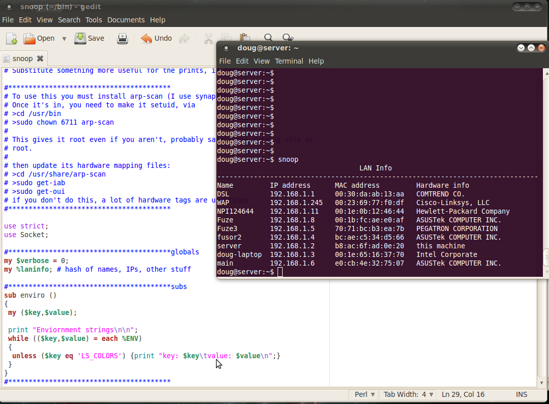

But you need the core code that finds this junk out first, and here's what the output looks like.
Output from the snoop program

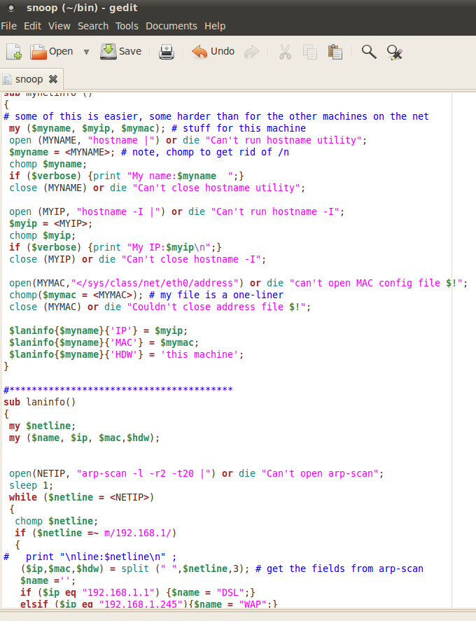

Not hard to get from there to updating a text file. Of course, perl is almost impossible to write or read without syntax highlighting. I use gedit here, but there are plenty of other editors/ide's out there (Padre, Geany). Doing this, I discovered how to mess up the highlighting in gedit, though - some perl "format" statements confuse it.
Here's what that looks like:
perl in gedit
perl in gedit
And, since I'm an open source type, here's the code itself. This took a lot more googling and book reading than typing - some of the ways to find this stuff out are obscure, to say the least - and the things that can find out about the rest of the LAN can't see the machine they are run from!
