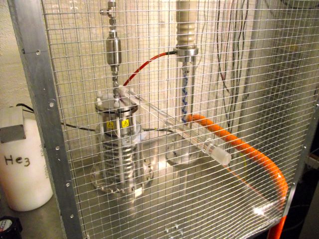

Unlike a normal fusor, the F.I.C.S. reactor has an exposed cathode and floating gas system, the whole thing was pretty risky, and I was concerned about accidentally touching the components, so I have added a Faraday cage, built from 4.5 mm acrylic sheet and bird wire. This might also shield out some RF and keep my instruments quiet.

FICS Prototype fusion reactor with Faraday Cage

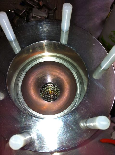

The lower half of two Tungsten hemispheres, being the reaction chamber inside the FICS cathode, note new installation of tungsten mesh over aperture. During operation the mesh gets hot and acts as a thermionic emitter, thereby maintaining a degree of ionization in the beam line, which in turn fuels the secondary ionization inside the cathode.

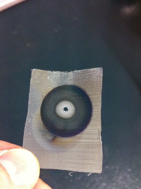

Old stainless steel cathode mesh showing spot where beam focus has burned a 1 mm diameter hole through the mesh.

This is starting to look seriously good! There's another benefit of the faraday cage (though you might want to make the mesh finer) - protection of the rest of the room from both EMI and just picking up a DC charge from any exposed really high voltage - it can really zap you if you pick up a few kv, then wave your arms (you are a wimshurst machine) and then really get hammered (ask BillF about that one).
Even tiny, current limited arcs can make quite the mess, and ruin your HV supply. I have a 50k ballast on mine - which limits arc events to an amp - at 50kv - that's 50kw and will easily fry nearby laptop computers (they aren't as well shielded as tower cases, but those have their own little problems - all the wires are antennas to bring the nasty stuff into the box). I've knocked out about 3 computers with my setup, but with the cages on the HV - that stopped happening. The risetime on an arc-emi pulse can be very quick, into the ghz and get through wide mesh, FWIW.
