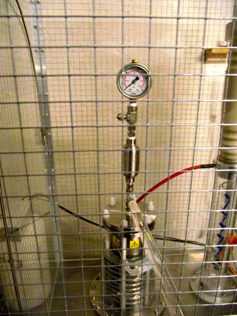

The last couple of weeks I have been busy with upgrades to the F.I.C.S. reactor. First of all the gas handling system needed improving, the laser drilled orifice with a 5 micron hole, which bleeds gas into the cathode was either too small or clogged, probably the latter, and the system stopped working. I have replaced the leak with a Swagelok 1/4" needle valve. This valve almost leaks too much when closed, but with my 100mm turbo pump, I can still maintain a steady 10 micron pressure by slightly opening the big gate valve. the needle valve can be adjusted via an acrylic rod from a safe distance (trick learned from John Futter).

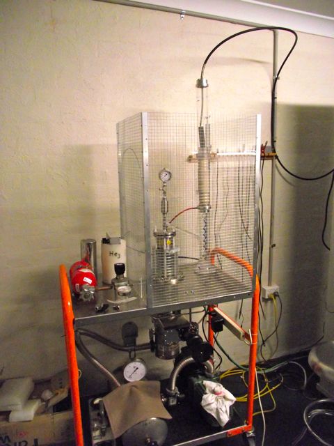

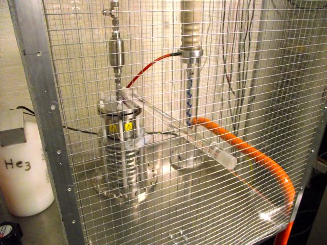

Unlike a normal fusor, the F.I.C.S. reactor has an exposed cathode and floating gas system, the whole thing was pretty risky, and I was concerned about accidentally touching the components, so I have added a Faraday cage, built from 4.5 mm acrylic sheet and bird wire. This might also shield out some RF and keep my instruments quiet.

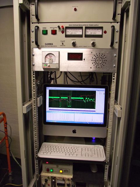

Further I have added a National Instruments DAQ, so I can record the pressure, cathode voltage, neutrons and current during my experiments using the simple version of LabView.

1) The Gamma High Voltage (RR100-6N) is on the blink, it intermittently cuts out.

Re: F.I.C.S. Gets Faraday Cage
This is starting to look seriously good! There's another benefit of the faraday cage (though you might want to make the mesh finer) - protection of the rest of the room from both EMI and just picking up a DC charge from any exposed really high voltage - it can really zap you if you pick up a few kv, then wave your arms (you are a wimshurst machine) and then really get hammered (ask BillF about that one).
Even tiny, current limited arcs can make quite the mess, and ruin your HV supply. I have a 50k ballast on mine - which limits arc events to an amp - at 50kv - that's 50kw and will easily fry nearby laptop computers (they aren't as well shielded as tower cases, but those have their own little problems - all the wires are antennas to bring the nasty stuff into the box). I've knocked out about 3 computers with my setup, but with the cages on the HV - that stopped happening. The risetime on an arc-emi pulse can be very quick, into the ghz and get through wide mesh, FWIW.
