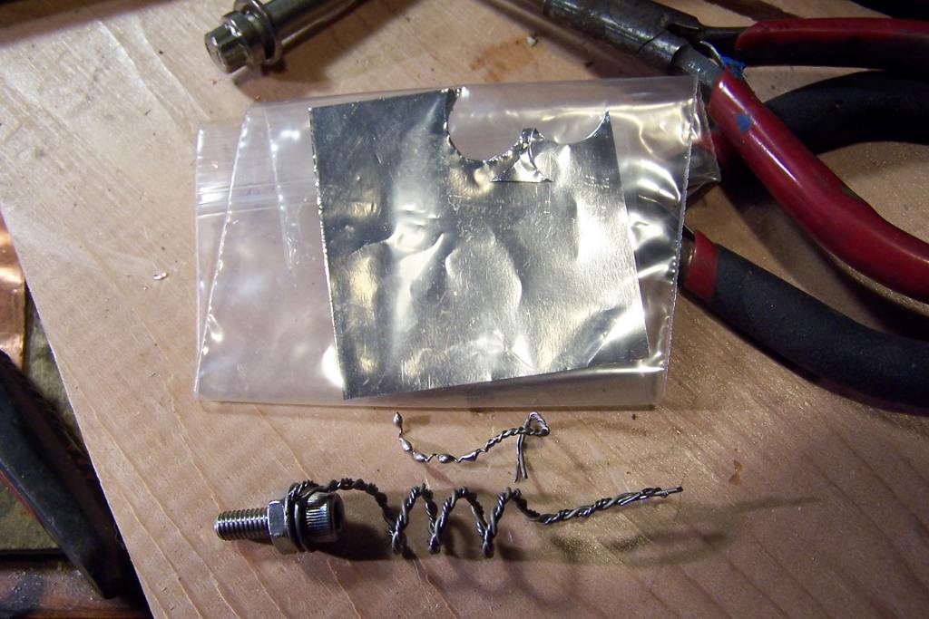

I used 7" of Ta wires, times three, .020" diameter each, and one Ti wire, .032", and this time, loaded it with a 1.5" piece of 1 mil thick Pd foil, about 1/4" wide, wrapped around the middle of this heater.
Heater that works for Ti and Pd just fine, thanks.
