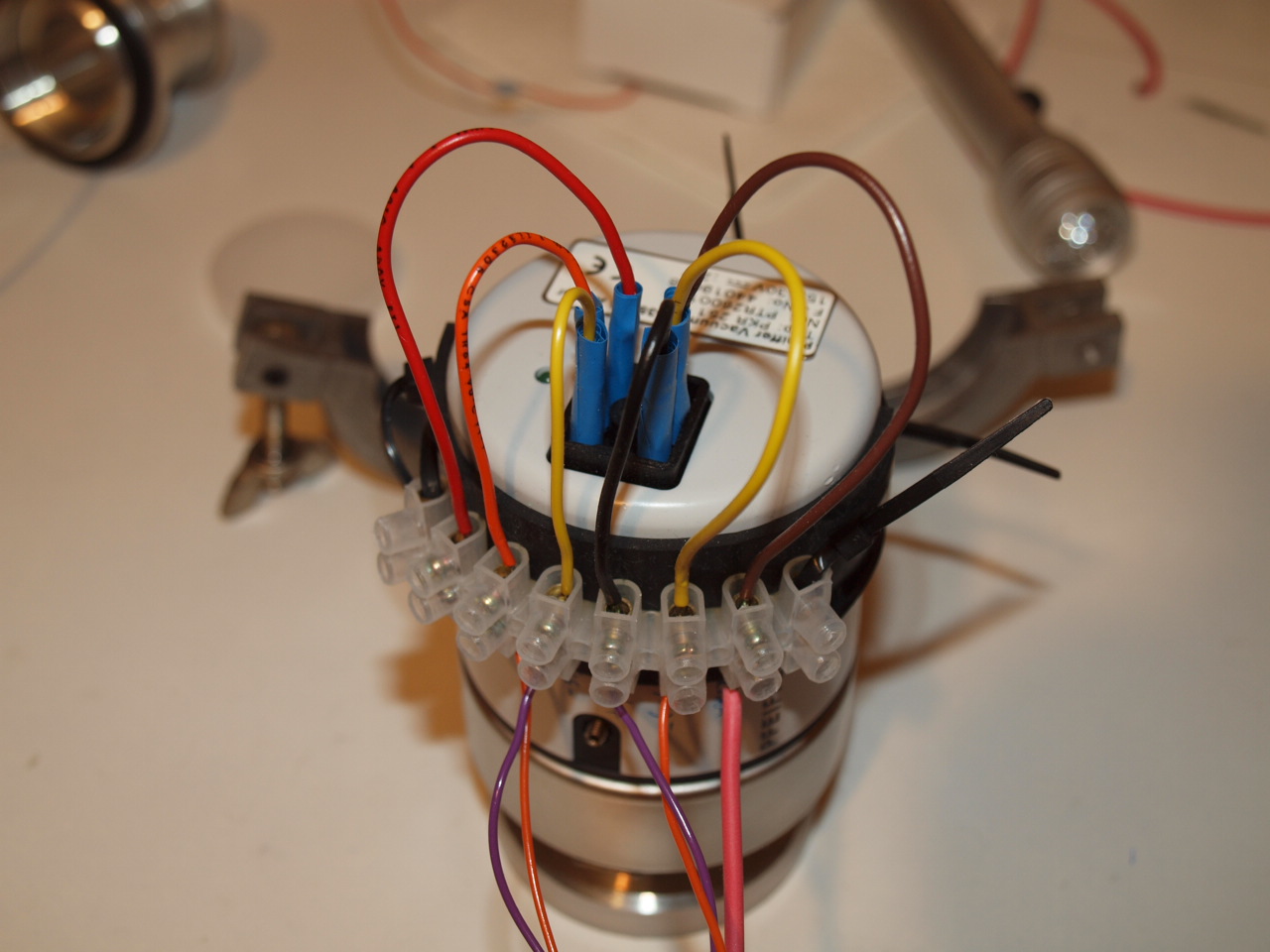

Here is the gauge before my disassembly, for those not familiar with these (the wiring is, obviously, my own as I do not have the specific connector for the pins):

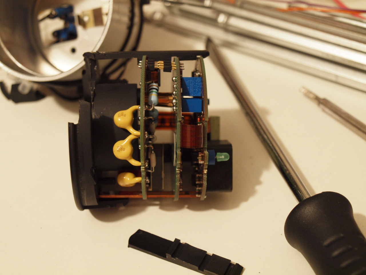

I removed the chamber off the PKR251, which is a straightforward operation for routine maintenance. You are then left with a cap full of electronics. This is a 'non-repairable' item.. but as we know, anything is repairable with enough will!!
However, 'non-repairable' means 'one-way plastic clips' and it looked like I had to break the plastic frame up to get the bits out:

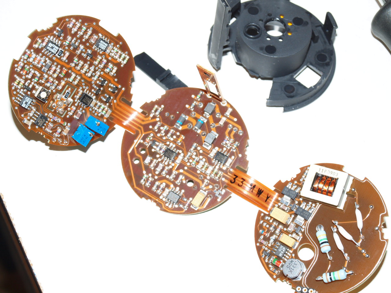

There are 3 layers of round boards that open out.

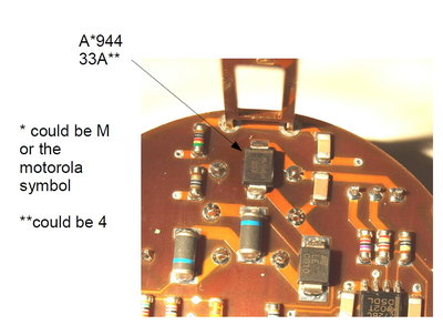

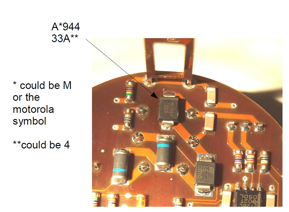

The part I suspect is indicated below. Reads 2.5 ohms, or so. Seems to be an ohmic resistance, no rectification or non-linearities. I can't quite make out the letters. Maybe that indictes it has overheated a bit?
Well, I'm looking to you chaps to tell me what you think, else I will be forced to use the 'brute' technique - apply the volts and let the high current flow until one of the components feels like it is getting hot!
Looks like it is that component, a cap and a voltage regulator parallel to that 2.5 ohms. I would presume the voltage regulator is hard to 48V for a few seconds, but the cap is likely vulnerable. Make your guess, and I'll desolder whichever is the odd-on for being faulty.

Update;
I did some searching and I reckon this is a 33A TVS. I found a line across one side of the package, which I am bound to conclude is 'cathode'. I can't see what else it'd be.
Anyhow, I figured of the components I could remove, only that one was easy enough to put back again anyway. Took it off, and it reads 2.5 ohm. It is a dead TVS. I shall buy another and it will be replaced in short order. (I hope that is as far as the fault condition got, but makes sense wrt the simultaneous transistor failure in the PSU - an excess current draw outside the SOA of the transistor during a pulse event, or an unregulated output of excess volts that the TVS successfully clamped. Either way, it makes sense.)
Re: [Attempt at] Repairing a PKR251
Best of luck with that. Sure it's not a diode? The TVS's I've seen don't have a polarity. At least, we think if it's motorola, it's not a capacitor since they don't make them (AFAIK). A little tracing back to see if it's across the power supply, or perhaps in series with it might pay off quite nicely...Always wondered what these guys have inside (I have two here myself, and yes, they're very nice to have working correctly). I'd guess the power supply went first - mine have seen some serious nearby lightning, and still work. Perhaps a huge impulse picked up on a ground loop did both in.
Whilst looking for replacements, I note that On Semicondctor (was Motorola semi deivision) mark their SOD128 packaged 31-34V/1mA unidirectional TVS with '33A'. It has a clamping voltage of 45V and 4W, so with the power supply trying to push out 48V, something was going to give, in a few fractions of a second!
Perhaps a local discharge in the plasma pulled the PKR251 to a place where the TVS saw a much bigger voltage to ground, and gave in, thereby overloading the PSU. Or either the TVS or PSU BJT could have given up for no particular reason.
If this fixes the PKR251, then I guess we shall never really know as 'normalty' would be restored... and we put it behind us and move on to the next misadventure!...
