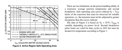

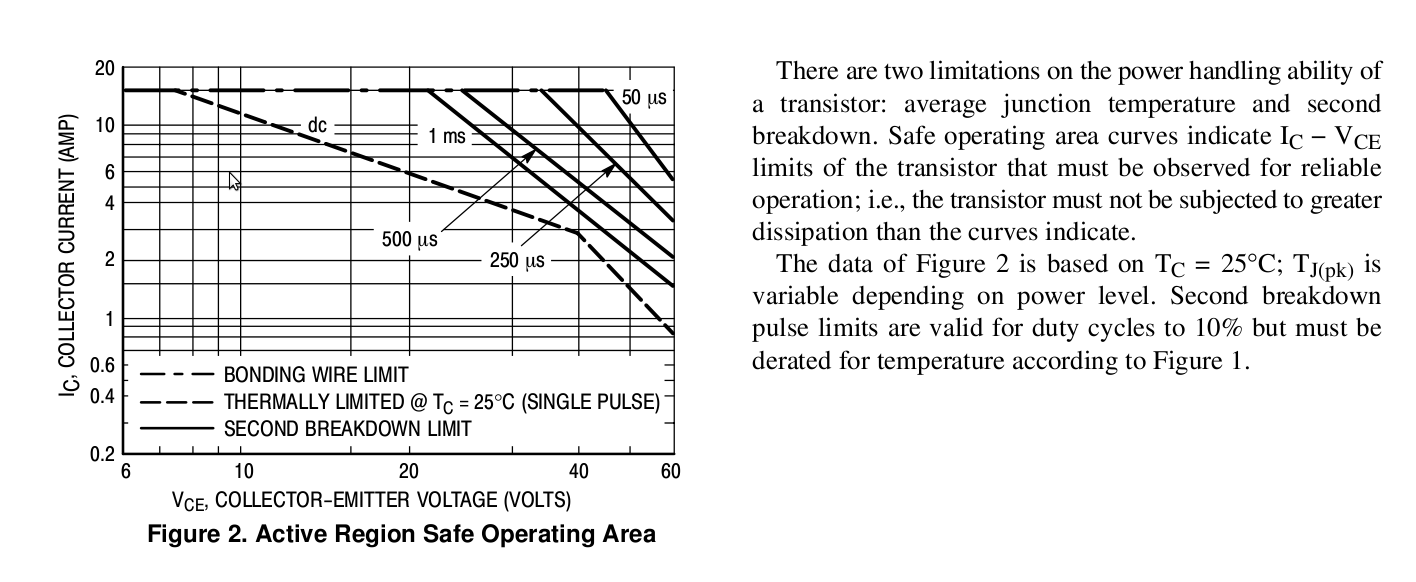

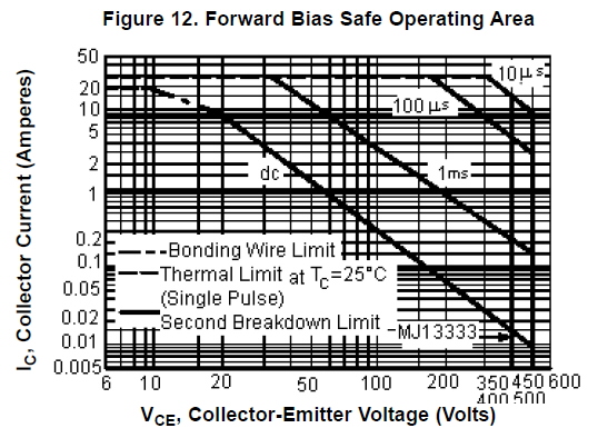

The MJ13333 has a larger SOA:
...and is listed (variously) as 2MHz, while 2n3055 (variously) as 3MHz.
(I say variously because I have seen variations on that. I guess it is either not too critical or not well controlled).
So, slower, plus a bigger SOA too?

Looks to me like any transient current draw above the regulated current setting, with that 48V on the 2n3055, is marginal.
At 48V, 2n3055 is out of its SOA at 2A drawn for 1ms, whereas 12A can be drawn through a MJ13333 for a ms.

I see 3a/40v on the 2n3055, but only 2a/40v for the MJ here. That's not bigger - it's only 2/3 as big, just to pick one point on the curve. You'd have to look at it where it actually operates, of course. Most PSU's don't have that much drop across the output transistors except in fault conditions (uh oh, that's what you had, right?). SOA limitations are what drove the concept of "foldback current limiting" in earlier designs.

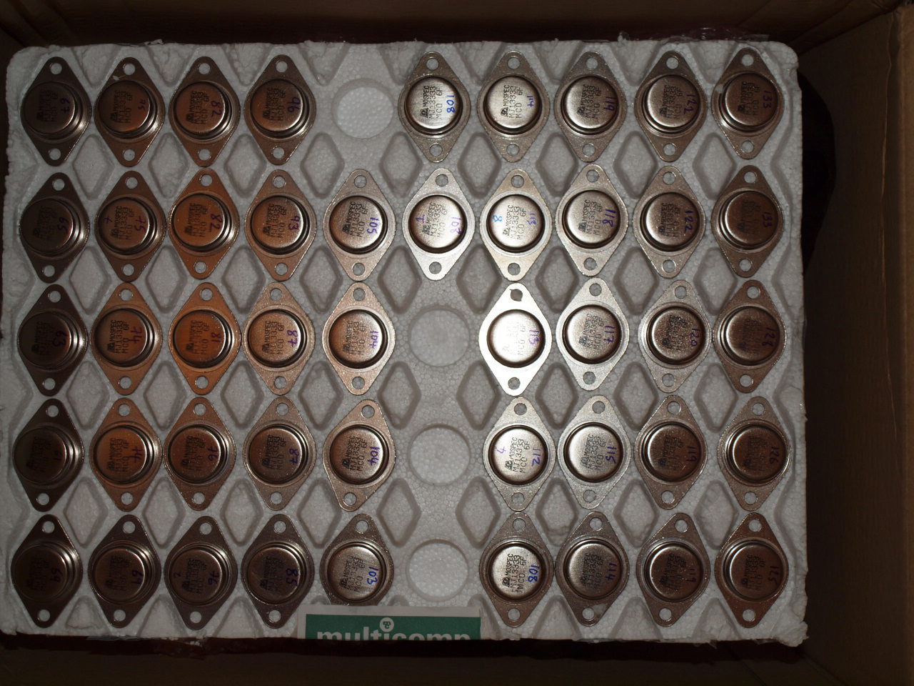

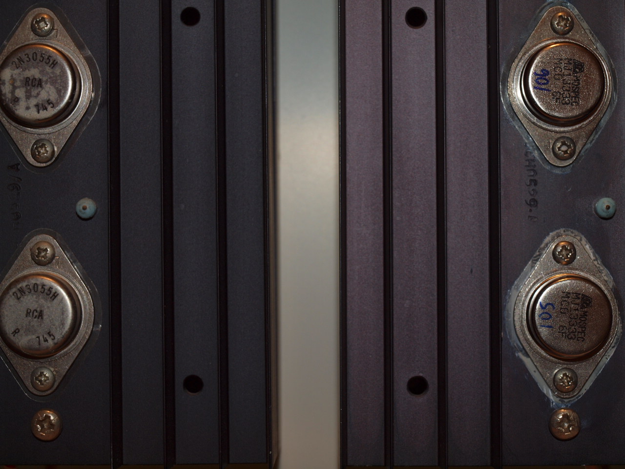

I have now successfully installed the MJ13333s and they appear to be working perfectly. I have loaded them up with full volts, then low volts and high constant current. They are running slightly cooler than the 2n3055s by a couple of degress, but that might simple be for better thermal compound.
I am very happy with these. They were on offer at 97p each, so I bought 50 of them and, as these LT30-2 farnell psu's have 4 parallel power transistors as voltage followers, I went through all 50 marking each with the hFE at 0.5A collector current to pick a matched set. The three remaining 2n3055 in the failed channel has hFE of 77, 82 and 120. Not exactly matched!! The hFE of the parts I used are 105, 106, 106 and 106! This being the advantage of buying a big batch and having the time to sort them!!
So they have 7 times the voltage withstand capacity of the 2n3055, higher current rating and higher SOA for pulsed currents. Best of all, they were less than half the price of the 2n3055 they replaced. Good result!
I did test a small batch of these first, to check they had the right characteristics, before buying a batch. So I still have 54 of them, which I will be using for an assortment of future tasks, not least of which is to swap out all the old 2n3055s from the other channels on this, and also my second LT30-2 bench supply. I am still anxious that my PKR251 blew up because of a failure on this psu, rather than caused the psu failure. I shall now move on to reparing the PKR251.... with your help, of course!!...
