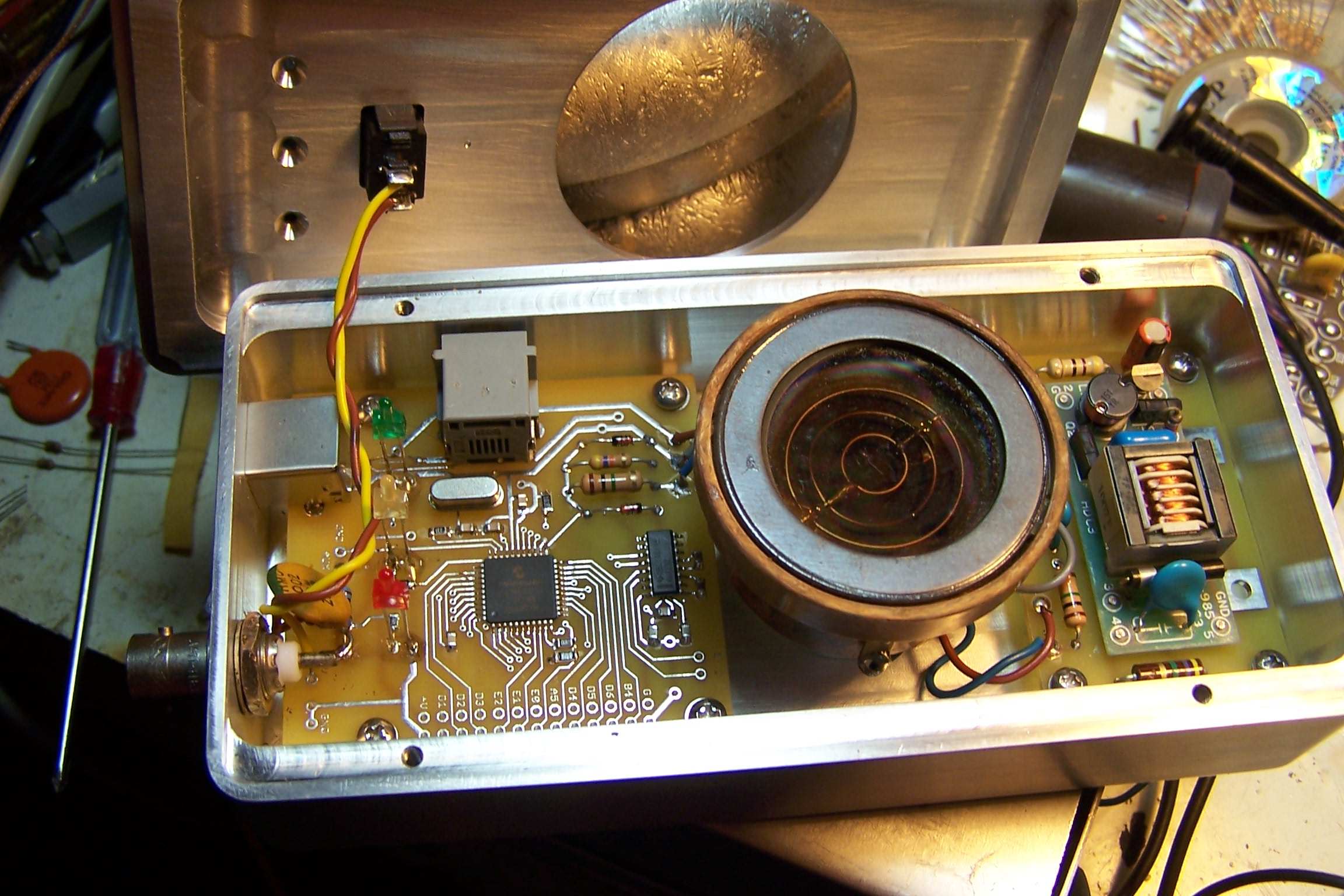

This is a pancake geiger, shown here with the protective cover (and beta stopper) on the tube. It is USB powered, so it requires 5 volts on a USB jack to run -- and it's a lot nicer when you use it with a computer and plotting/logging software which we also provide. The particular pancake tube we've managed to get 10 of is optimized highly for beta radiation over all other types, making this perfect to count silver or indium after activating it with your neutron-producing device, and that's its main intended purpose. It's sensitive enough to count background, which it counts in the low 20's of CPM in a few locations I've taken it to, well off the ground (the rocks around here are a little hot). However, the specialty of this is superior beta sensitivity. While it counts less background than the larger Geo pancake, it counts a beta source a lot higher. The gamma to beta ratio is greatly enhanced in this, as I will demonstrate on this thread somewhere. I measured this using an "official" plastic encased Cs-137 .25uC source -- something that emits one beta and one gamma per decay (no alphas, and both the betas and gammas are monoenergetic). With the beta shield in place, this counts around 1k CPM. Without the beta shield, it counts closer to 30k CPM -- so it's about 30x as sensitive to betas as to gammas, making it ideal to count sample activations against a mostly-gamma background (the usual situation).

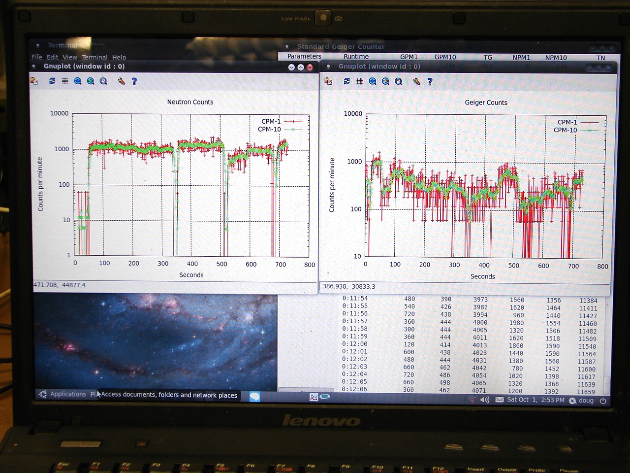

Here's what it looks like on my dual monitor setup.
You can see when I did what easily on this plot, which is log Y so you can even see the background in the presence of the 30k cpm points. Gnuplot lets you get numerical data back by placing your cursor over a spot, and the cusor position, normalized to plot scale is displayed at the bottom left (I didn't do that this time). If that's not a good enough record, then it will also log the raw data from the standard counter.

We are not using much of the PIC microprocessor here at all. It's loafing at about 1% cpu load most of the time, and most of the memory and I/O are "left over". That's on purpose. The main board we designed (I did the schiz, Joe did the PCB layout) has quite a lot of capability, and will be used in other things we make available here. Here's what it looks like inside.
Note the dual row of "spare pads" on the edge of the board. Thats' the leftover IO from the PIC 18F4550. It includes regular digital IO, PWM outputs, A/D inputs, interrupts, I2C bus, and power.
This board can be plugged onto application specific other boards, and either power them or be powered by them, providing a uP and an PC interface that can really move some data.
You'll notice that we designed this in modular fashion -- all the geiger-tube-specific stuff is on its own board, so if that should change for some reason, you only change that part.

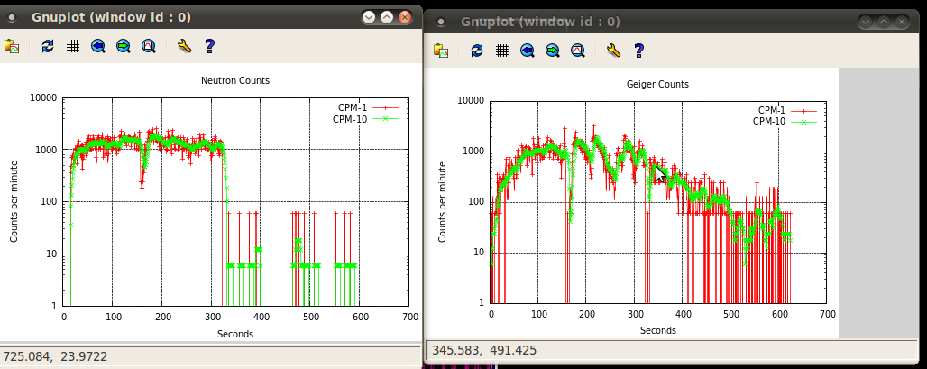

5 min timed fusor run, starting at 20 sec, ending at 320 sec. I then put the silver foil from the neutron oven on the standard counter and let it stay on there till about 500 sec, then let it count background (sadly, I'd left a thoriated welding rod on that bench, which raised the background about 30 cpm or somewhat over double my normal). At any rate, here's the shot: Fusor conditions were 2.2-2.5 e-2 mbar "old" D (had been in there awhile, had a little air too).
40-50kv, 10-15ma. Neutron oven as depicted elsewhere here, sitting on sidearm over grid.
You can see where I tried to let out some gas to get the volts higher under the current limit I had set, and made it go out, then a bit of fooling around to let in too much gas, and try to get the magic number again. This shows up more on the X rays than on the neutrons as long as the thing is running, but you can see it both places in sync. On the geiger plot, I placed the cursor over the high point of the silver count, right after putting it on there, and you can see the seconds and the counts/minute there. This appears to be precisely as sensitive as the one I'd been using, a larger 2" pancake we got from Geo, but which wasn't optimized for beta -- I know because I "baked" both my old thicker and larger sample and the new foil sample (same as will come with this counter) at the same time and counted them both. They tracked! Since this is a log plot, you see any simple exponential decay as a straight slope.
The neutron detector was the Hornyak I'm working on, also depicted elsewhere (I'll be adding posts to that to show the final build and yet another preamp -- best one yet). It's "deef as a post", but plenty good enough for this. The He3 and boron tubes were going "ssssssssssss" and I didn't count them, they'd have been way larger numbers. But a fusor is "loud" so the monitoring detector can be a little numb and still be fine. I did note that the hornyak can "see" the X rays when I hold it over a leak in my lead shielding, so for some people that would have to be shielded, or they'd have to shield their reactor (you know which you *should* do, doggone it -- RichardH)

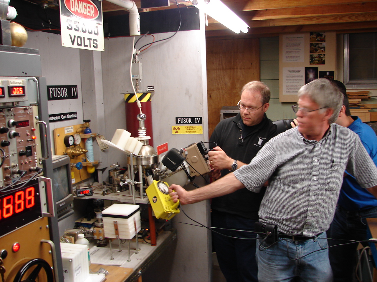

In my case, all I have to do is keep it outside the lead. Here's what it looked like for this run.

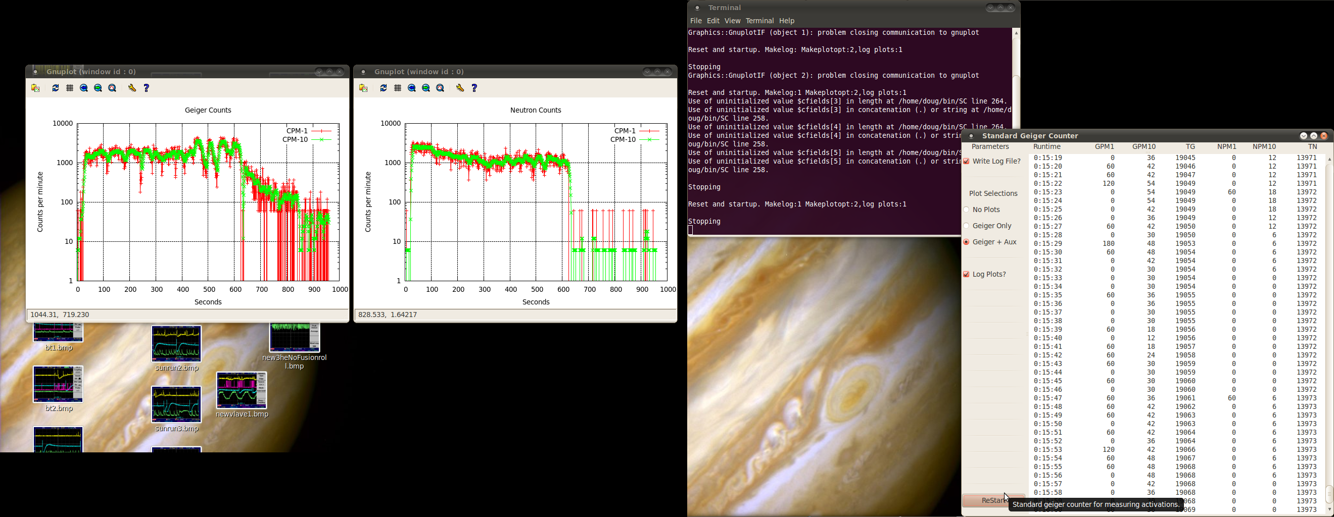

Though I didn't make it, Bill Fain and Joe Jarski went to this year's HEAS, and used our counter to document some of Richard Hull's fusor runs. Due to how tight things were there, they wound up actually holding the Hornyak up to the fusor by hand to get good numbers, and take some exposure themselves. Some good data was acquired (more of which I'll post when I regenerate the plots from the logs), and a very good cross-lab calibration obtained. Richard's unshielded fusor makes a lot more X rays in the room than mine does, according to this data, which was taken with the geiger portion of the counter a good bit farther away from his fusor than I do here. I'm suspecting some of the variation seen in the X rays (when not counting activated silver) was due to humans being temporarily interposed between the fusor and the counter. We see variations here too, but not so much, and those are usually tracked by neutron output here.
HEAS was another big success this year, with a lot of other good things happening. I wish I could have made it, but...life happens. More here.
I'll regenerate the plots from the logs they got, and post those too. My takeaway from this is that an optimized fusor has both a certain Q and a certain output given the basic sizes and power.
Watt for watt - Richard's and mine give fairly similar results. I put in perhaps twice the power, and usually at a little higher voltage, and get about 3 times the neutrons. This all makes sense since the cross section for the DD reaction goes up very quickly with energy of the D's, and due to my running lower pressure and higher voltage, I get somewhat less collisions with stopped neutrals, and somewhat less issue with space charge canceling the applied accelerating field. So the differences are not really surprising - what's more surprising is how much the same things are despite our different geometry (his is a sphere), and different power (his is unfiltered, rectified X ray transformer, mine is from a very nice Spellman, filtered and regulated).

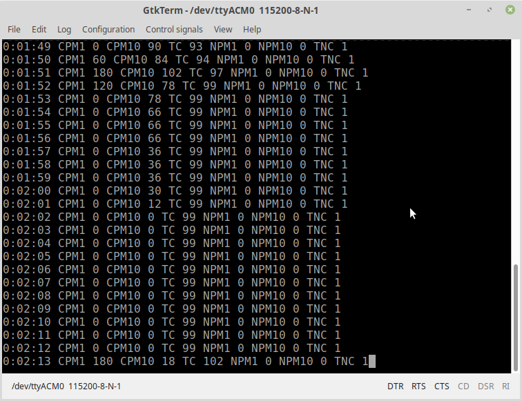

Someone asked for the output format for this, so here it is.
It's a USB serial port, 115200 baud, 8n1, and uses linux line endings (not crlf like windows). Most terminal programs will do the conversion as an option.
Here's a screenshot of some output I just took here. The first field is uptime, as H:MM:SS
Then the label CPM1 - which is "counts per minute for this sample" - really it's counts this second times 60, since everyone uses CPM but often doesn't want to wait a minute.
The next pair of fields is CPM10 as a label, followed by an average 10 seconds - useful as low level radiation is really random so some smoothing is nice for the human to read.
TC is total counts since powerup. So if you really want to know a long term average, you can use this and the time to compute it.
The next set of fields, which only occur if something has put some input to the BNC connector (TTL-like levels, a low pulse counts - it's not real picky but don't blow in 100's of volts).
They're the same format, but the N means "neutrons" as at the time, that's what we were hooking up to it - some sort of neutron counter. It's able to handle pretty fast counts.
