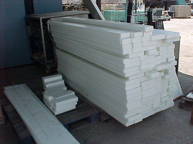

I need to learn how to cut the long pieces shorter.
Panasonic makes a circlular blade for plastic with the teeth on backwards. Only saw one once, but they exi$t.
Paid only $2 per pound but shipping was steep ( by truck)
Geo

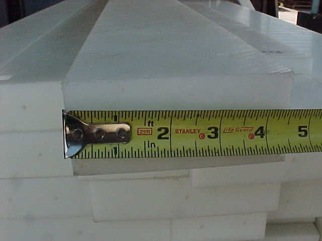

2" stock
2" stock

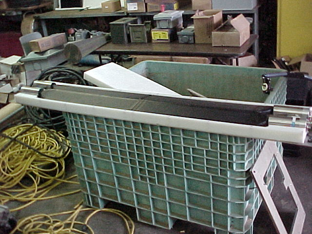

Long pieces
Long pieces
