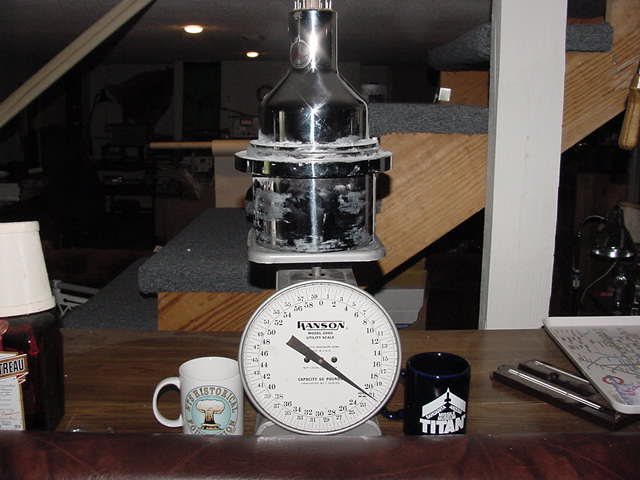

Yeah, I live too far out for cryo stuff to be worth it. I did see someone was making something self-contained at one point (peltier?) but it was one of those hopeful press releases from a university about something they were going to commercialize...which I suppose failed to happen (as always - academics don't understand business -- you can't vaporware your first outing, you have to actually have something to sell). I'd love to be getting spectra like JonR gets...
That picture looks a lot like the ones I've got here, and boy they are nice for non-cryo. Yes, they're heavy, though I've not weighed one, they're about 20 lbs give or take. I'm guessing the smaller ones I've managed to get (BillF always gets some credit in this - he's the master at finding cool things) were for something like a PET scanner, where all they really needed was to discriminate between 511kv and "all else". Not that sure how useful they would be for real forensic measuring and discovering what something was made of. Better than nothing to be sure. One interesting thing I've seen on those is a line in the 2 mev range when running the fusor - not sure what exactly makes that, but I see it on them (the big fusor is lead shielded 1/4" all over, more on the operator side except for one tiny deliberate leak to look at stuff like that). I won't be taking one of the big gems near a hot neutron source!
I just left the 100 meg HV probe on there the whole time, so taking it off wouldn't change the volts -- that's how I monitored it to see it not drift while the spectrum was drifting. The power supply is 12 watts worth...shouldn't care much anyway. I'm sure it's not that, it's something else -- just gotta figure out what. Maybe I'll try one of my fast optimized preamps with lower tube voltage and all else the same on the URSA. Yeah, that fan is a pain. Paul said it was only needed for charging, things get hot for that. I don't run it off the batteries anyway.
Maybe I should just make a phototube simulator off a pulse generator and test with that.
