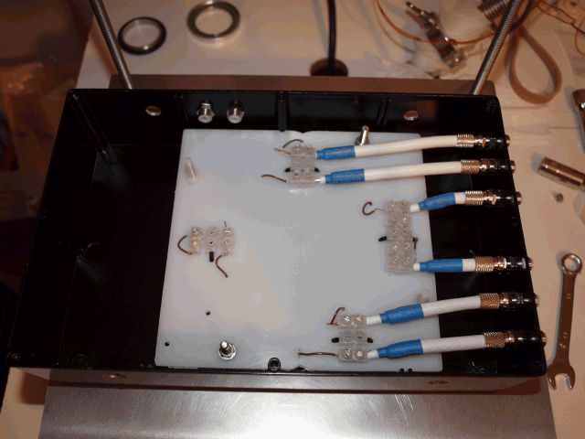

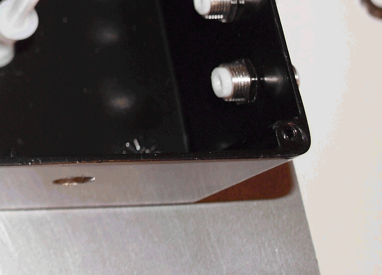

Re: BNC DC voltage limits?
adapted female f-f connector, installed as a 'bulkhead' socket.
How the chamber feeds currently look, as viewed in the underside 'junction box'.

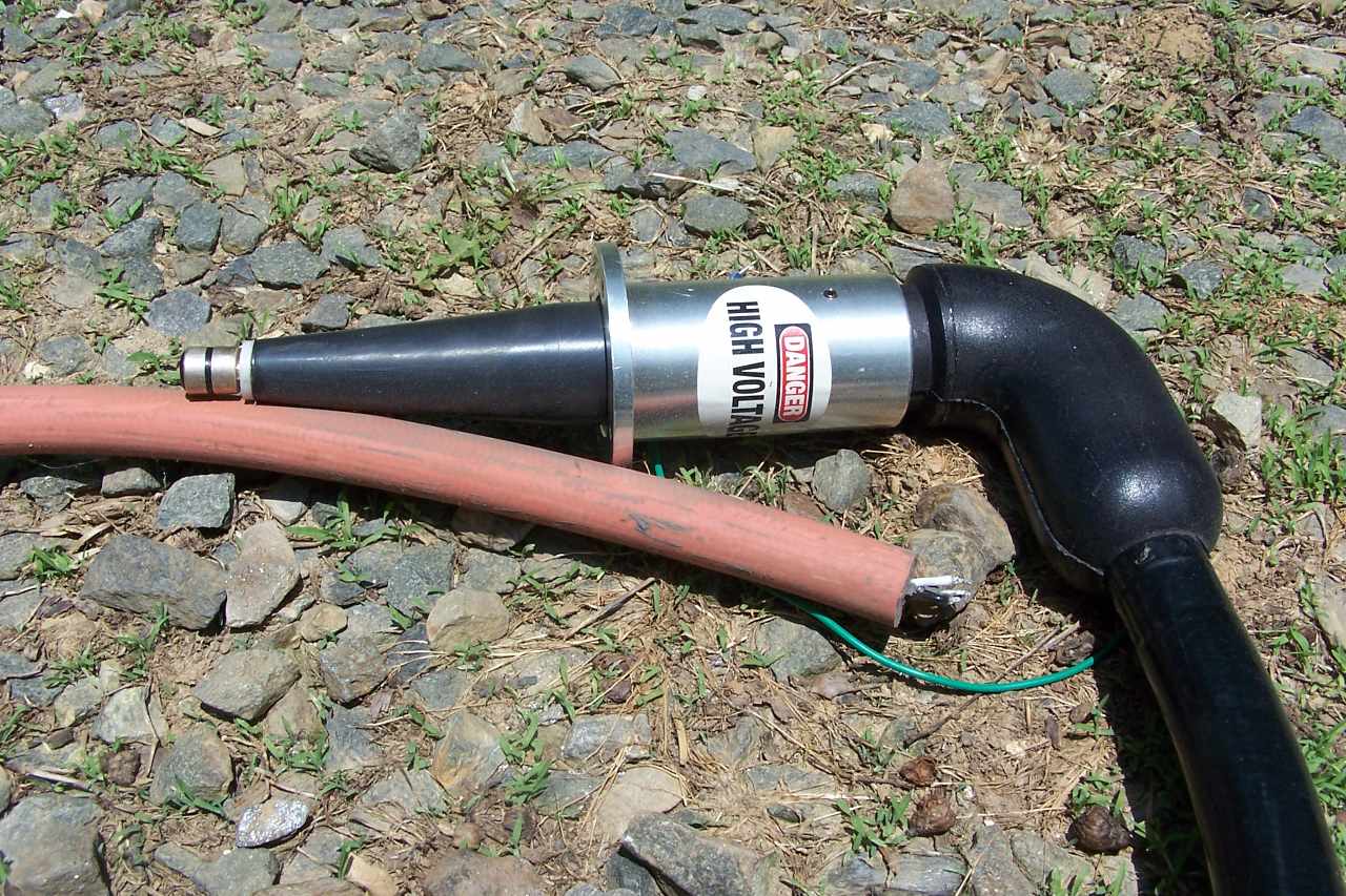

For grins, here's what a real HV connector looks like -- no amateurs need apply. This one is 3 pins, two for filament power and one for the HV. They're not cheap. The cone is some silicone that has a little give and fits airtight into a cone in the HV supply, being clamped in there with considerable force after greasing with some silicone grease. Which works -- but I hate that stuff. It has a huge tendency to creep out of anything not perfectly hermetic and make a mess (not to mention getting lost from where it belongs). If anyone finds a non creeping formulation, I'll be all ears.
