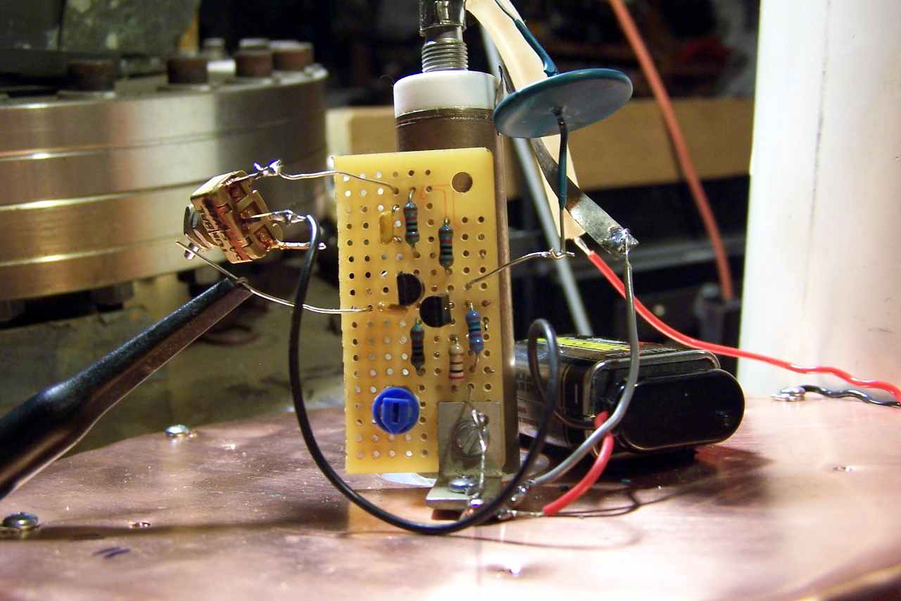

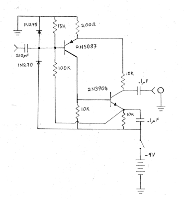

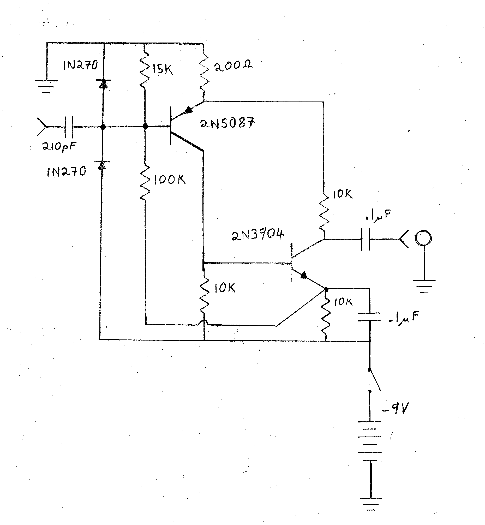

Still working on the "ultimate preamp" design, with some success. This is a two transistor asymmetric risetime low quiescent current design, 700 uA on a 9v battery that makes 5v or so pulses without clipping, and has feedback for great linearity. I will probably be using this on phototubes as well, as it's really fast. In this design, both transistors are biased barely on, and the incoming pulse turns them on further. This gives very fast response, with a slower turn off time, perfect for a signal that does the same thing. The signal gain for AC is roughly 50, set by the ratio of the npn collector transistor to the emitter resistor on the pnp input stage. Input transistor is a 2n5087, npn is a 2n3904. I took some care in design and testing this to have it work decently over the whole voltage range of an alkaline 9v battery -- from about 9.5v down to about 5.8v or so.
Here's a sketch of the preamp design. It's neater than I usually post, because I didn't draw it, Jon did.
New preamp schematic, thanks Jon.

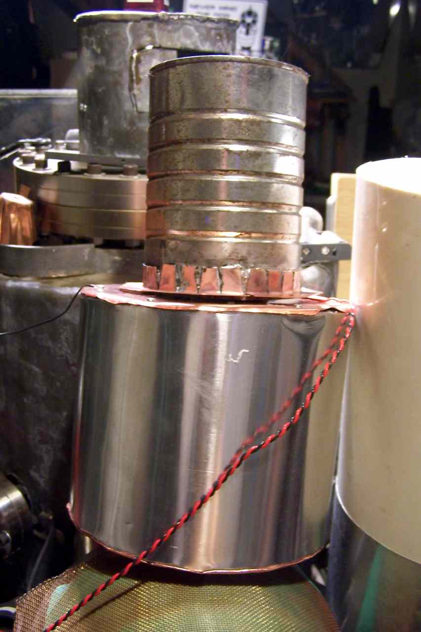

Here's what the assembly looks like. We tested in the same moderator as used for the CHM-14, which is a little short for this, but it works fine anyway.
Whole assembly
Whole assembly
And here is what the top looks like with the coffee can shield removed. We'll punch some holes in the can for the connectors for HV and signal, and the power switch of course (and paint the thing).
The preamp and wiring

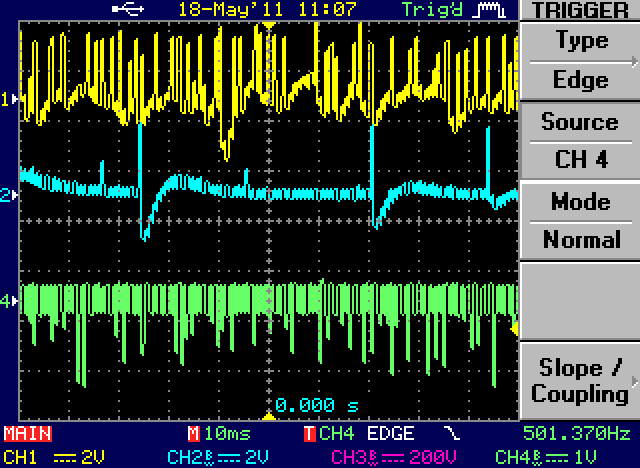

In a test on the main fusor here, this tracked our 22" 3He tube quite well -- at about 90% of the same count rate, when positioning the new one where we usually put the neutron oven. That's only a little bit closer to the action than the big guy, so sensitivity is more or less equivalent. Here's a scope shot of all three of our detectors going at once.
Top is big 3He, middle is big B10, bottom is the new Russian tube with our new preamp design.
The new preamp in combination with this tube gives much shorter pulses. We took this shot without the can shield, because the radar wasn't hammering us so badly, but did pick up a bit of noise on the baseline due to that -- and this scope sees that due to sampling at 2.5 ghz in peak detect mode.

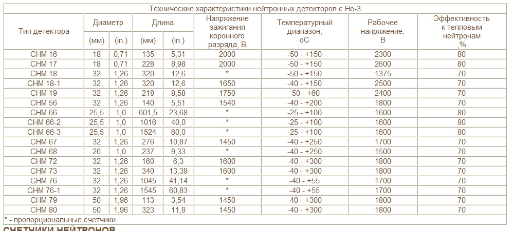

FYI:
(The 3He tubes with * are regular proportional counters.)
Re: First light on SNM-17 3He tubes
Post by chrismb »
Doug, I have two of the SNM-18-1 tubes [lucky me!] which are much the same electrical settings as the 17, I think, just bigger. The issue I have had is, simply, that I do not [yet! :) ] have a 'known' neutron source. So in testing it, I have simply looked out for background neutrons. Frankly, can't see a thing in the noise, so kinda gave up.

Depending on the amount of hurry you're in, I do plan to do a PCB for this preamp, and another for power supplies as time permits. The board layout for the perfboard version wouldn't need jumpers on a single sided PCB - it's pretty tight. The CCFL supplies radiate a lot of 50khz noise, so they have to go in their own shielded box - packaging is key on these kinds of things.
For those sharp-eyed who didn't see the input protection diodes -- they aren't there in this prototype, due to my junk box lacking *good* ones -- the ones I tried were leaky and noisy so I cut them back out (for now). Without them, the first transistor will inevitably go pop at some point when someone hot-plugs power or on some odd other event. The trimpot was in there at prototype time to get that bias resistor value quick and easy, but wound up at a standard value -- nice. Due to the large emitter R in the NPN, it's not so critical as it might otherwise be.

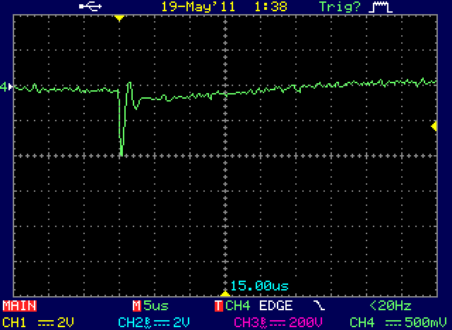

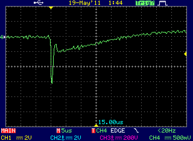

So, first, some cosmic ray responses. We didn't have a big amount of these, perhaps every few seconds, we didn't time it. They come in all different pulse heights, just as the real neutrons do.
Cosmic ray hit w/o shield can
Same setup, different time
You'll note the shapes are the same other than amplitude. We see that with real neutrons too. Someone asked if these see gammas...here is what we saw with a chunk of torbermite that counts our standard counter at ~147,000/min.

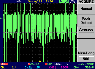

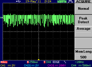

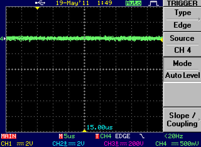

Now for the fun part. Here's what this looks like with the scope in "roll mode" and with fast sampling (peak detection). This "gets" noise that your electronics can't see up to 2.5 ghz...which is why I'll show you a baseline with no fusion first.
No fusion baseline
No fusion baseline
Now, with the fusor running:
Fusor running
Fusor running
But of course, "you had to be there" so here's a movie.
