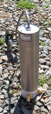

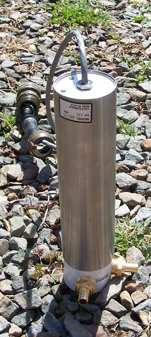

Bill scored a detector for low energy betas, a Victoreen, plastic scinitllator, preamp, insanely thin Al/Mylar window -- and we've even found pinouts for it and the preamp built in.
So this suggested itself like water going downhill.
Parts for detector.
Parts for detector.

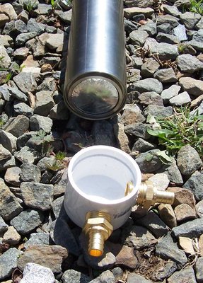

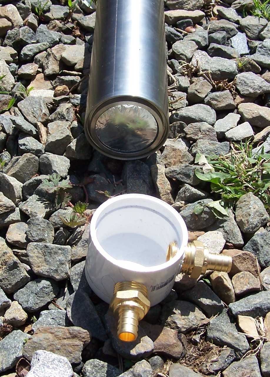

I found a "slip in" pipe cap that could be bored a little to fit the detector face, turned off the 8 sided "head" so I could chuck it the other way in the lathe and bore to fit over the detector window, and inside the detector outer shell. My big system is already plumbed to send the exhaust outdoors, via Qest/Pex plumbing (which is fantastic stuff for its intended use as well -- freezes without breaking, FYI). So this was pretty simple to make.
It fits together like this:
Now, the total gas in my fusor for a run is a pretty tiny amount -- fraction of a cc at STP (I'd have to work it out again, but I think I remember it's about .05cc or so, it's a big tank). We generally run for quite awhile without running any gas at all out of it, and due to the way turbos work, most of the gas that would come out when we pulse the exhaust valve wouldn't be hydrogen, but heavier gasses. But at the end of a run, we take it back to hard vacuum and it all comes out. I'm assuming that letting in a little fresh D during that would flush the original tank contents out, and by arranging things right, any light gas would collect in this detector by convection, which is why I show it in the orientation I do. Obviously, it will go utterly nuts during a run from X rays and neutrons (plastic scintillator), but that's not when we'll be using it anyway.
Could be fun....we will see sometime down the road, I've got to drill a hole though the shelf in the rig for this long thing to project up through as it's going to be plumbed right at the forepump output, which is just under the shelf.

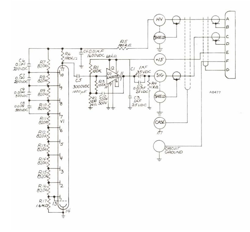

Edit: Contains this schematic. Obviously no money spared, an LH-033 is pretty expensive for this use and much faster than needed as well. Note they even bootstrapped the input bias!

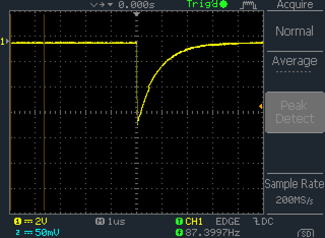

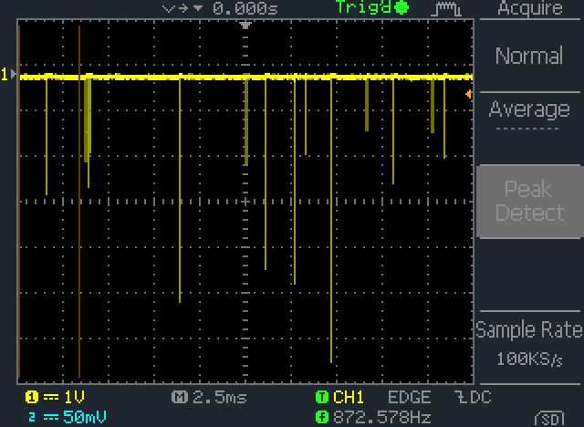

Ok, finally got that horrible military circular connector cut off the thing and got it fired up. It works! It's sensitive to all of alpha, beta, gamma, with it seems a slight preference for beta, as when I tried a hot beta source, the big counts dropped off quicker with distance than the ones I assume are from gammas, well past the range of any alphas from the "hot rock.
Here's some waveforms from it. This is with a Cs-137 source, but even though the prime decay of that is beta, what this is showing are gammas -- the Cs-137 is in thick enough plastic to stop all the betas from it, so we only see the gammas from the metastable decay product. Good enough to test the thing, and nice to know.
Lots of pulses with scope in &quot;peak detect&quot; mode.<br /> so you can even see them on this timescale.
Lots of pulses with scope in "peak detect" mode.
Still in peak detect mode to see noise.  Not much!
I'm guessing this will see the amount of T I predict just fine, thanks. Background (by eyeball on the scope trigger) seems to be about 1-2 per second, with some seconds no count.

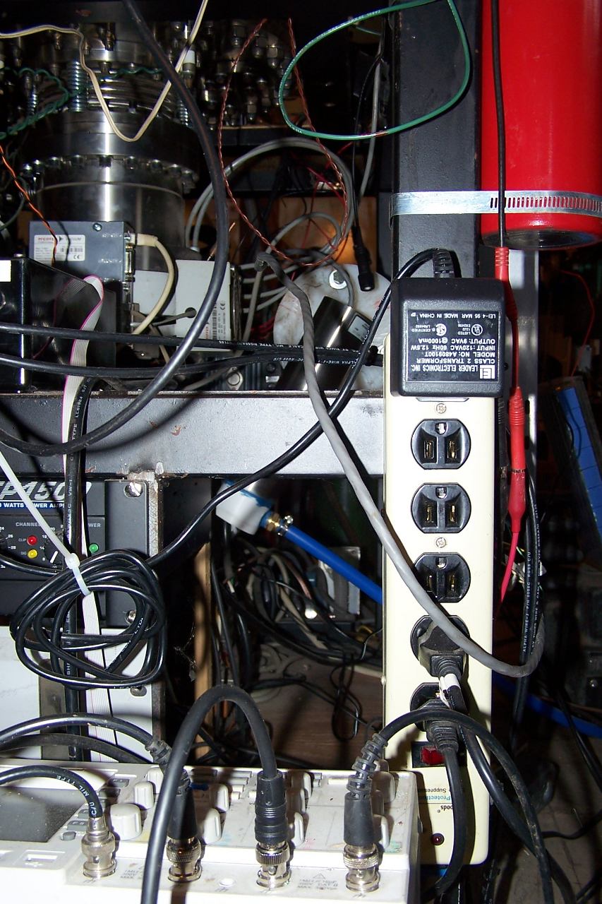

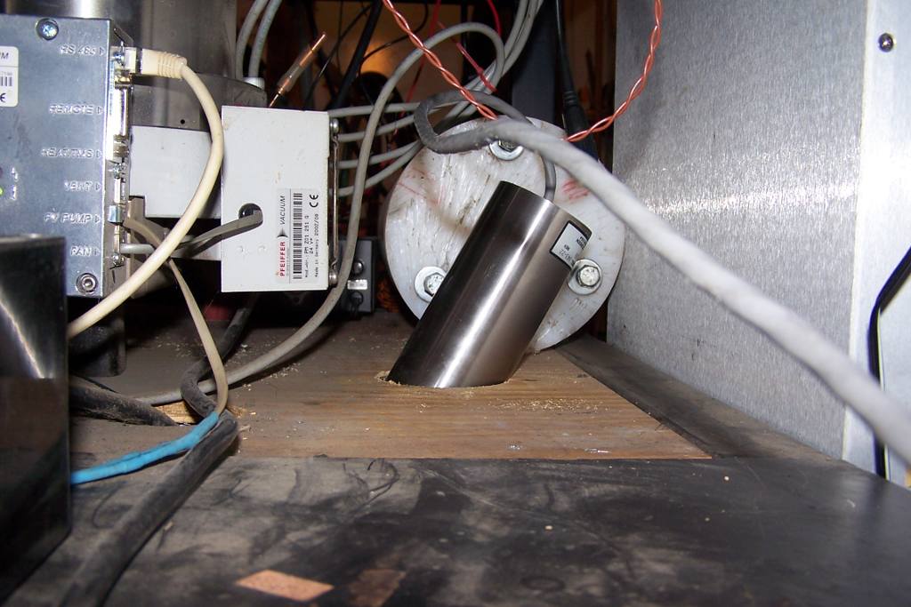

OK, it's basically in place now, and almost ready to smoke test. Due to the layout, this was a little tricky to get installed, as you can see in the pix, but now that it's in there -- it should stay where it was put fine.
Overview -- the thing had to go through a shelf.
So I had to make a hole in the shelf between the forepump and the rest of the rig. A little tweaking and it fits. The round white thing behind is the lower neutron detector moderator.
The top sticking through the shelf

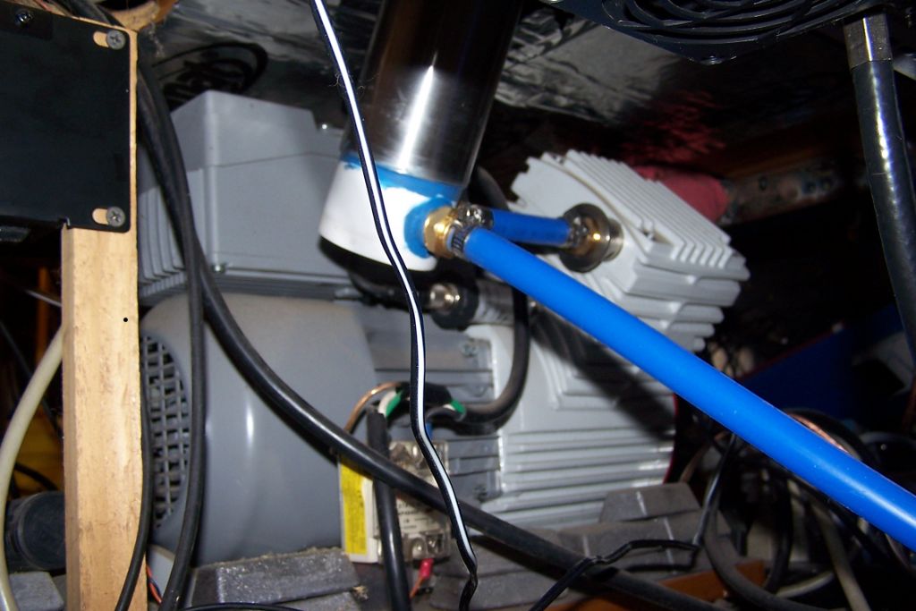

Underneath is the plumbing, since that's where the exhaust out of the "Harley V twin" forepump is. The blue pipe is the Qest stuff, on which I used hose clamps instead of the crimp rings so I can take it apart later without violence.
Bottom plumbing
Bottom plumbing
You can also see the SSR I use to switch power to the forepump, based on either a manual switch or a trigger based on the turbo pump power drain -- saves power and hours on the pump.
The lead ingots are to help damp vibrations (the pump is on rubber mounts), and the shiny stuff on the underside of the shelf is DynaMat for acoustic supression -- same idea, this is the expensive stuff pro car audio guys use and it has a number of uses (I use it to damp vibrations in benchrest rifles also).
So, I'll be testing this soon, probably just with a scope at first, but the plan is to hook it through our PIC multi-geiger data AQ front end. It's getting tight down there and I'll need to add some power supply stuff as well for this.
