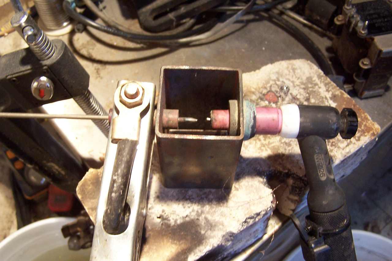

But for the case where you just need to make a junction between two twisted wires, there's an easier and better way. Set up a jig that holds a TIG arc and contains the shield gas, and just stick the wires in the fire -- done, works great, it's easy.
TIG furnace jig
TIG furnace jig
This jig, made of 2" box steel, is the trick that makes it really easy. Nothing special really. I made a bushing on the lathe that fits the ceramic tip on the welding head to hold that end of things, and another out of copper that clamps a fat TIG rod, which gets the ground clamp. I also drilled a small hole in the side to introduce your thermocouple wires through. Just put them in the arc for a second or so, and pull them back out (but keep them inside the box till they cool off).
I suspect this toy could also be used with a crucible to get things really hot as well. You could use this upside down from the way it is in the picture and put the crucible down in the pipe where it would be in the shield gas too. Haven't tried this for any length of time -- I might have to replace some of the brazed in bushings with something else that will hack more heat for that to be really practical. It will definitely melt quartz -- stat.
