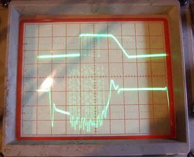

But lets discuss that scope shot in the first link. Anyone who can actually explain various parts of that correctly is probably in line for some kind of award, because there are a few things going on that simply don't make a lot of sense, yet they happen, are repeatable, and lead to huge Q increases.
Here's the image again.
Reposted image, neutron detector on top, voltage on second grid bottom trace
The upper trace is AC coupled, which is why the first couple of pulses don't show correctly till they charge the cap in the audio amp the scope was hooked to. Oops. But that's not enough to wreck the analysis value here.
This is in a two grid setup. At the gas pressure I was running, the main grid can have 50kv on it and draw basically zero current -- it's past the Paschen's law light off point. But even a smaller voltage on the second grid (see the picture/movie at the link) will light off and make ions at that point (which "turns on" the main grid too), due probably to it being able to "see" much longer path lengths out in the main tank area. Note, we had already seen some "interesting things" in various free running pulse modes earlier, and this experiment was partly an attempt do do on purpose what we'd seen by accident with various conditions before -- and to do it the easiest, dumbest way to get a feel for things.
So, for this, the 2nd grid (which BTW is not shaped right to make neutrons, never makes many at all under any conditions) is tied to one leg of a neon sign transformer through a coupling capacitor. Note that we have a rectifier -- when the grid attempts to go positive, all the free electrons in the tank head that way and draw current. One of the huge questions though -- why in the world does that take milliseconds -- see that overshoot? It's real. All the theories I know on charged particles indicate that microseconds should be more than enough time, but yet we see what we see here. Secondly, during the negative half cycle, we see these pulses in the grid voltage (the NST is a pretty high impedance) that go well above ground, while the NST is trying to push it negative -- they can't be much current though, because they don't discharge the cap -- note after a pulse a return to the NST basic waveform. Further, and this is of course the interesting part - note when the neutron detector (3He tube), fires. Also note the timings -- you see a jump down in the waveform with some overshoot when the NST polarity flips -- then some time where nothing happens, even though the volts are fairly high (negative) then some pulses at a rate that's pretty slow compared to any reasonably calculated particle transit times.
Now I have a kind of half formed set of notions in my head on some of the whys here -- but to me, this is the most significant thing my lab has yet produced, and it's replicable as can be. The free run version is not so much so, but it did show us record setting neutron outputs and out of this world Q figures, as in that case, the main power current was a mere .1 ma -- the lowest the digital meter can even read! So in truth we don't really know what it was drawing -- most of that could have been corona loss or meter error for all we know now.
(we got the other pulse mode BTW with an inductor in the ballast, that resonated with the tank/grid system at about 1.8 mhz)
One big question -- do we need to sweep the electrons out first, every time? Maybe not, since we get multiple fusion pulses after each sweep here.
Second -- why does that take so long?
Third -- why does it then "free run" at about 2 khz? Can I make that go much faster with the correct drives?
One of my notions is that stable fusor operation in the normal mode is what a math guy would call an attractor -- it's a dip in the energy surface that "attracts" the most stable operation. But, it's not the best place to make fusion -- from what I can tell, it's nearly the worst, actually, but just off that -- it gets really good. Trying to balance the thing in a steady state off the local attractor seems as pointless as trying to stand a pencil on end on the desk. You might do it with servos, but the case is such that any perturbation -- or initial error, makes it fall.
So far, just about everything we've tried that perturbs a fusor off this attractor makes it better, which leads to yet another question - can we design a perturbation that is best for fusion, and if so, what do we need to learn to know how to do that?
The fusor II link is an attempt to think about that one a little harder. Not sure that's exactly what will do the job, but it's something reasonable to try I think, and along with all the other things on my plate, I've been building out the gear to make that attempt possible.
A regular fusor seems at best to be a dimly smoldering fire -- it seems that any poking we do with any stick makes it burst into flame. I got tired of that other place because no one would even think of trying this sort of thing there (even though it's disgustingly easy to try), so they became useless to my efforts here.
Some seem to avoid any measurements that might upset their pre-conceived notions, they have too much ego invested in those notions, I guess. I'm the other way around -- I like surprises like this! I deliberately do some off the wall "cowboy science" just to see what I see, and I'm trying to do that old "expect the unexpected" or at least notice and analyze it when it happens. Seems to be the way forward.
