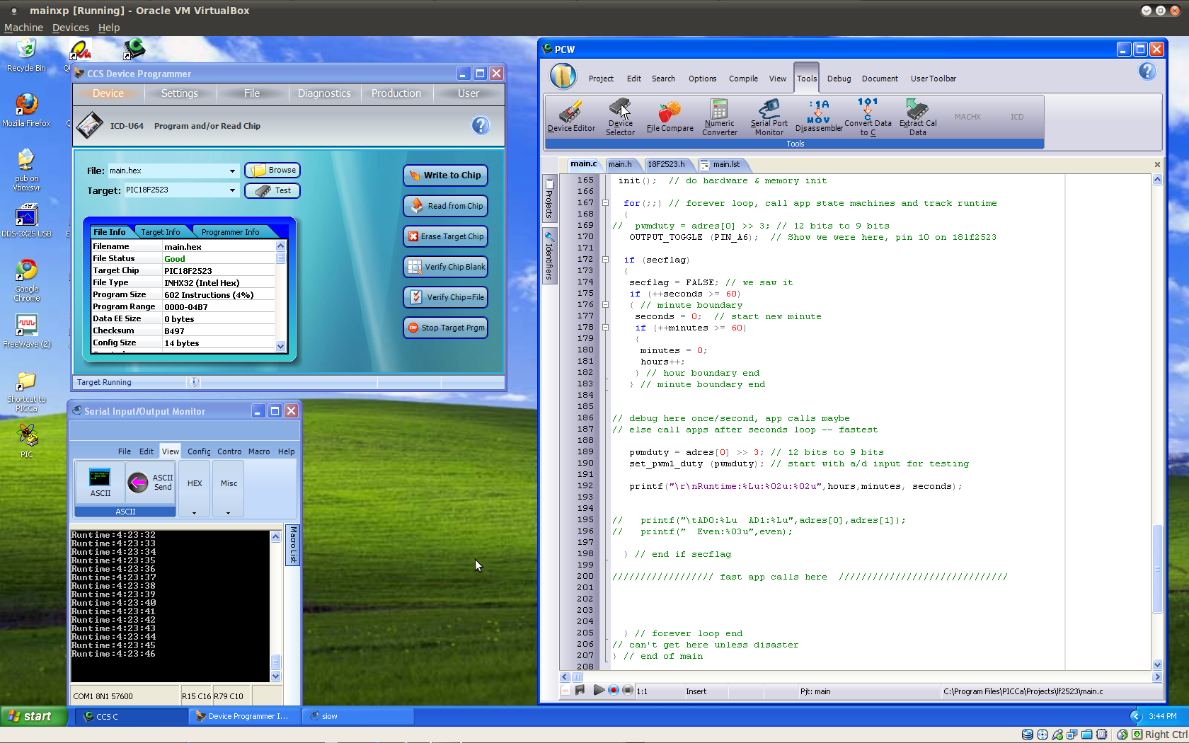

FWIW, here's what my dev environment looks like at the moment. I'm running windows in a window, in virtual box under linux. I plan to move this over to pure linux at some point, but this works, easy and fast. And most of the things wrong with windows go away if it's in a sandbox and not allowed on the internet much. For what it's worth, this gets around the main loop at 630 khz as measured by a scope on pin 10 of the pic, which means it's really twice that (it just toggles the line once per roundy round, which means two roundies per cycle of sq wave). That's except for when it hits that printf -- where it slows town to sub khz speeds till the characters are all out. So that's going to get fixed stat! Can't have odd 5 millisecond delays in something that can otherwise do Mhz response times -- a 5000:1 level of stupidity the way it is. Could this be why people think hard realtime programming is hard?

OK, here's a new "release" of the basic PIC 18fxxxx opsys, with some serious improvements (see changelog.txt in the zip file for detail).
This release no longer needs any external timing parts at all (but you can use them by changing a #define if you want)
I've now added interrupt driven rs232 ascii both ways to this, which is a 5k::1 speed improvement on sending if used, and which eliminates character by character polling for input as well.
Blocking code ain't for me! And it makes doing things in real time very difficult. You can still use the blocking printf() call if you want, and are careful, but...this is far better.
The protocol for sending is to call SendPC() with a buffer pointer to what you want to send (null terminated string). You can check a busy flag first if you're a good programmer, otherwise it will, and it will stall while busy -- there are always trade-offs, and in this small space, you can't make it stupid-proof. You can of course avoid that by the intrinsic timing in your app code as well, so no waiting need ever actually be done. Any non-null characters will go out.
For receiving, it groups input into lines/messages with one of the terminators \r, \n, or \0 -- any, or all, work, and it will ignore any after the first one it sees (many ignorant windows programs send all three). This buffers input, sends it to a "safe" (some new meaning of the word "safe" for you HHGTTG fans) buffer for the background, and sets a flag that background loop can check. I have a very minimal input parser going that just sends any input back out for now -- TODO is add some code that does things based on what is input, sets, gets, commands and such. Some will be the same for every project (the debug stuff) and some will be app-specific of course. The background has to "eat" the buffered input before the next message is complete, or it will be wiped out, but it can overlap parsing the last input with a new message coming in, the buffer copy to background doesn't happen until the new message terminator. There are always trade-offs in this sort of thing.
One is, isn't so good for maximally efficient binary comm (no nulls), but I can also add that with a scheme I've thought of, should it be required.
For now, it works well with any terminal emulator on a PC, including the one with the CCS toolset, if you know to send a hex "a" (or other terminator) at the end of a message.
Hyperterminal works as well as it ever does, in windows.
Another trade-off is the size of the comm buffers -- whatever you set (via a #define) there will be 4 of. The current ram usage is about 17% due to this -- only 5% is other variables. Rom is now 8% or so.
I am using 64 chars per buffer now, hopefully it's enough (and for a slow PC, you should cut to 16 or you can overrun it easily). Remember, this is one of the "big ram" chips, so it has a whole 1536 bytes of ram. You learn to use single bits for booleans and things like that, and use the PC to store anything big...right tool for the job and all that.
I added a message output in the init() function that tells you why it booted up this time. You can boot from power up, a reset, a watchdog timer timeout, and various other errors.
I did this for less skilled programmers who are real likely to forget what "cooperative multitasking" is all about and get into some spin loop -- the watchdog will time out and give the appropriate "you're doing something dumb" message in that case. And oh yes, the watchdog is now turned on, but currently set to "stupidly slow". In most real apps you'd want to set it quicker. Further, depending on the reason for boot, you may or may not want to go through various init steps, as they'd be already done (and you wouldn't want to wipe out some variables in that case) -- it's up the the user/programmer.
Various other improvements and additions, this is nearly ready for real release as the basic boilerplate for all future apps on this chip family. Mods to other 18f chips will be trivial in software, and in fact, I'm using a hardware PCB layout developed many years before this chip family even existed (2002) -- PICs are nice like that, they make transitions easy -- almost any chip the same number of pins will at least work at all in the same PCB layout, though you may not be able to use the new features without a little work (for example, ethernet or USB might need repurposing of those I/O pins in hardware with the extra stuff to connect to the world). Further, they keep making the real old stuff available so manufacturers don't have to do expensive "NRE" work all the time -- for these, it really is Non Recurring Engineering.
Enjoy! Probably the next release will be the last one that isn't application specific, this will be the basis of a lot of embedded designs around this board. Hard part done, just add application code at this point, or after I add some debug parsing to help those who need that (it's always nice to be able to peek and poke, set eeprom setting and such, and it'll be easy to add, but it's feet-up time for now).
