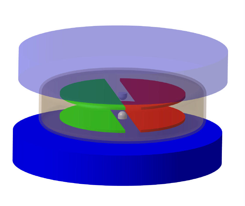

Here's a very rough sketch of what I had in mind. Blue being the magnet poles, tan being the chamber, red & green are the D's and the white buttons would form a virtual grid. Ions would be injected tangentially and accelerated in the gap like a traditional cyclotron, however, at a certain energy level they'd get to the outer edge of the D's and find a steady state orbit just beyond since they no longer cross the gap, but are still well away from the chamber walls. Then the accelerating field stops and the grid switches negative. After scattering there'd be a random mess that would eventually cross the gap and accelerate again.
OK, I think I'm done with this one, move along now.
