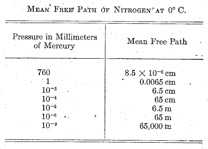

Vacuum people define a quantity called "mean free path" which is very useful as a guide. It's the mean distance any one gas atom or molecule would travel without hitting another one in your vacuum. This is usually a more important measure than pressure is. Assumptions are that N2 is 3.1e-8 cm diameter. You can kind of think of this as the pressure vs system size where things are transitioning from a fluid that uniformly presses on tank walls, to a bunch of little balls moving mostly ballistically. One upshot is that it's very easy to pump to the point of mean free path being commensurate with the sizes involved, but it gets harder fast when the atoms are in ballistic mode, mostly clinging to the tank walls. The old joke is water will sit on a tank wall, fly off, go across the tank and interfere with your process along the way, stick to the other wall, and stay there from attoseconds to weeks before repeating. Once you get to long mean free paths, it has to randomly find its way to the pump to be removed.
Here's a table of mean free paths in N2, as calculated by John Strong. This came out on the large size, but that matches how important this is,
so I didn't edit it. This ties in with the way Paschen's law works, so is important in plasma work too.
From John Strong
From John Strong
The equation is: mean free path (cm) = 1/sqrt(2*pi*n*d^2) Where n is how many per CC and d is the diameter of what is there.
So for smaller molecules, the mean free path is larger, and the opposite.
