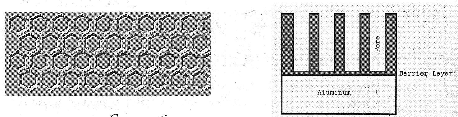

Not sure where this best fits in the org scheme, but here's how I do it, and it's great for vacuum parts as well as decorative stuff. I made all the window frames in this place and colored them nicely using this technique.
Anodizing makes a honeycomb oxide layer on the aluminum. You can control the size of the pores in it by process variables, and the results you get for a given application require changing to suit what you want. If you're working for decoration and dyeing, then you want mid sized pores -- hold enough dye to see, and hold it tight. Too big and they dye easy, but lose it too quick with time. Too tiny, and the dye molecules don't fit in the pores pre-sealing and the piece won't take the dye well. But that latter is perfect for vacuum use, and gives really good insulation which tends to cut sputtering (aluminum is already good there, this makes it really good) too. Since this picture isn't that great (scan of a scan, a couple generations) here are some drawings too.
The really key variables are current density, and temperature. For small pores, current is high, and temperature low, and controlling that is a pain -- as the power heats things up and it takes tons of ice or a proper solution cooler to keep things cold. For decorative purposes, room temperature is fine, and lower current density -- just don't let it heat to 80 or 90F and you'll be fine.

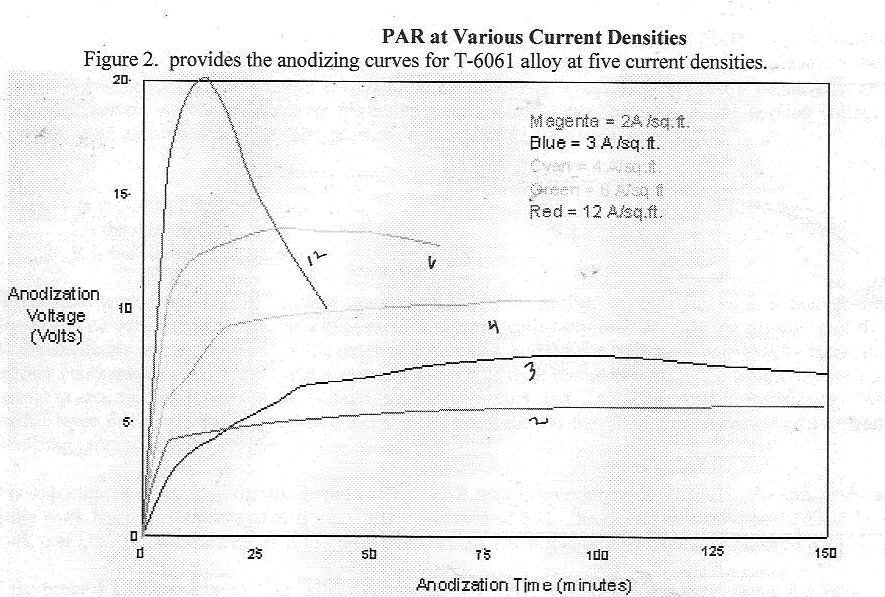

Here's the big secret. Parts reach what one guy calls "peak anodic resistance" at a certain time in the process, and that's when it's the best. After that, the resistance goes down again, and the coating is gradually destroyed by a competing chemical reaction. This is where your constant current supply comes in super handy -- you can watch the volts rise, then begin to fall again, and know when to remove the part right on the good spot.
Note, this curve is messed up, as is the coating, by letting bubbles sit on the part -- they are produced by electrolysis, and under a bubble there's no current flowing and the process is stopped there, while the current density goes up everywhere else as the surface area is lessened. You can just shake the parts, or use an aquarium air pump and plastic stone. But whatever you do, make sure it works. Dye some practice parts and you'll see what happens if you don't get this right -- it's ugly.
Here is a curve one guy got on one setup. Here I find the volts don't go quite as high, or the peaks come as fast -- that's life when duplicating an empirical process, but this is in the ballpark. If in doubt, leave the part in about 20% longer -- as you can see from the curve shapes, you're not going to lose much if you overdo this just a little bit. The main trouble you have is that bubbles affect the measurement, as does any dead time with power off, and probably the phase of the moon. Temperature is critical and can make the volts drop before you're really done if it's going up -- and it always is some -- you're putting power into the solution that comes out as heat.

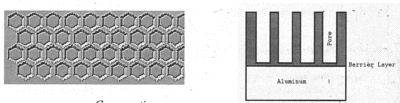

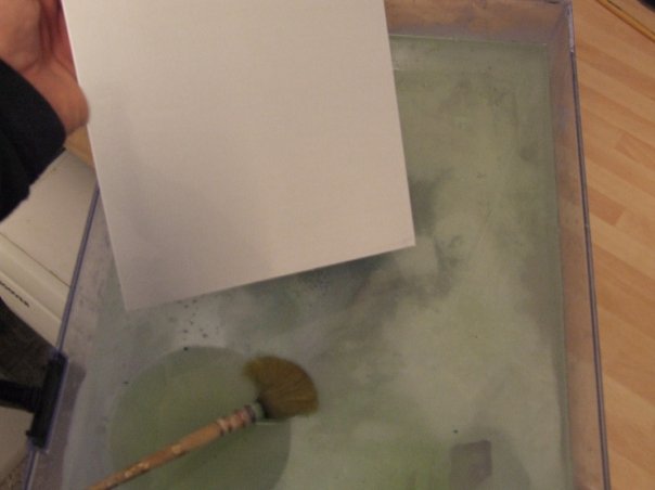

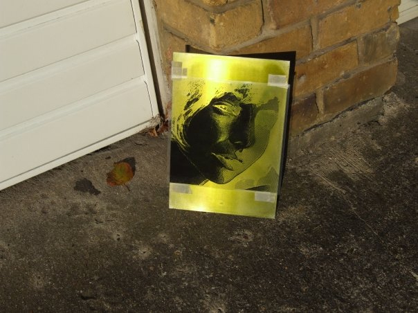

Re: Anodizing aluminum

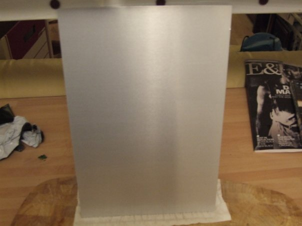

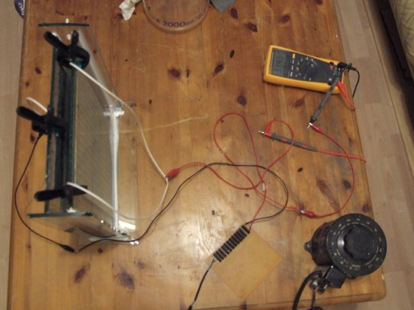

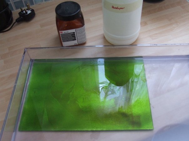

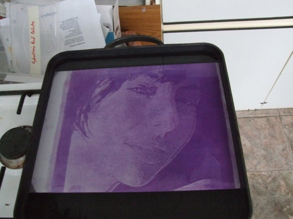

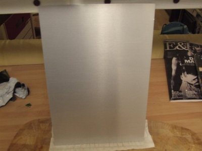

Fantastic thread here - I wish I had some of this information a few years back! When I tried to do this I found some of the details really tricky and a 'trade secret' attitude out there.
This is 'wood cut' that I did with photoshop for a friend:
