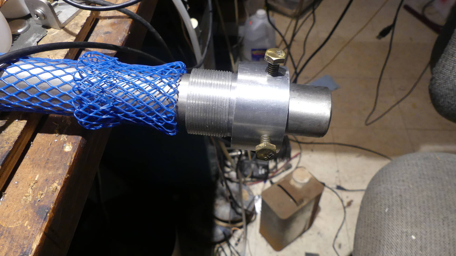

Project for today - and it took most of the day, I'm slowing down a little. While I did have a kinda workable solution to hold the back end of things sticking out of the lathe spindle bore...there were "issues" like those screws would come loose and then not really clear the back cover and ... bad things. Also hard to get at to adjust due to that.
So I made a "real" spider - threaded end is 1-5/8x16, and I used 4 1/4-20 brass bolts for the clamps, in 2.125" (roughly) OD 6160 Al.

So I just took a couple of pix. My main use for this is chambering rifle barrels with the chamber not just concentric with the bore, but also angularly aligned. Maybe there are people out there who don't know that blanks often come with the hole not in the middle, not straight, and not the same offset at both ends. And that's the good high pricey ones.
if you're trying to make a hyper accurate rifle (what other kind is interesting?) on the cheap - because, you know, cheap - getting this part right really matters a lot, and it's the sort of thing that's really hard to go back and fix later.
So, this amounts to a 4 jaw second chuck for the end of the barrel not in the main lathe chuck so you can adjust all of that and just cut things perfectly after that.
