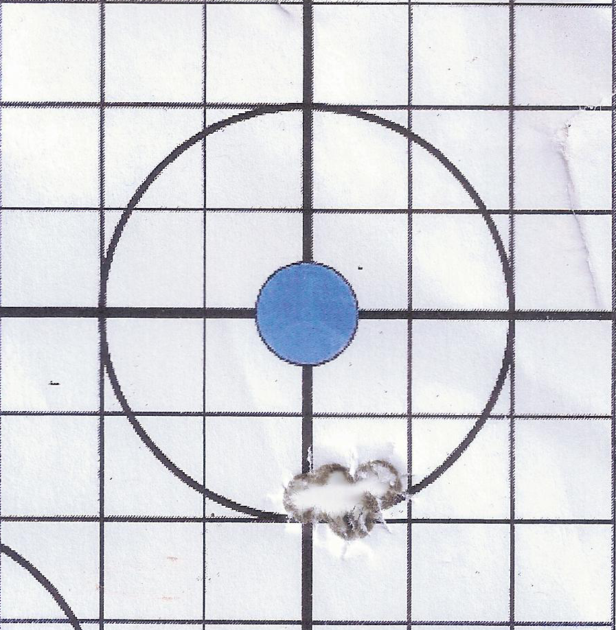

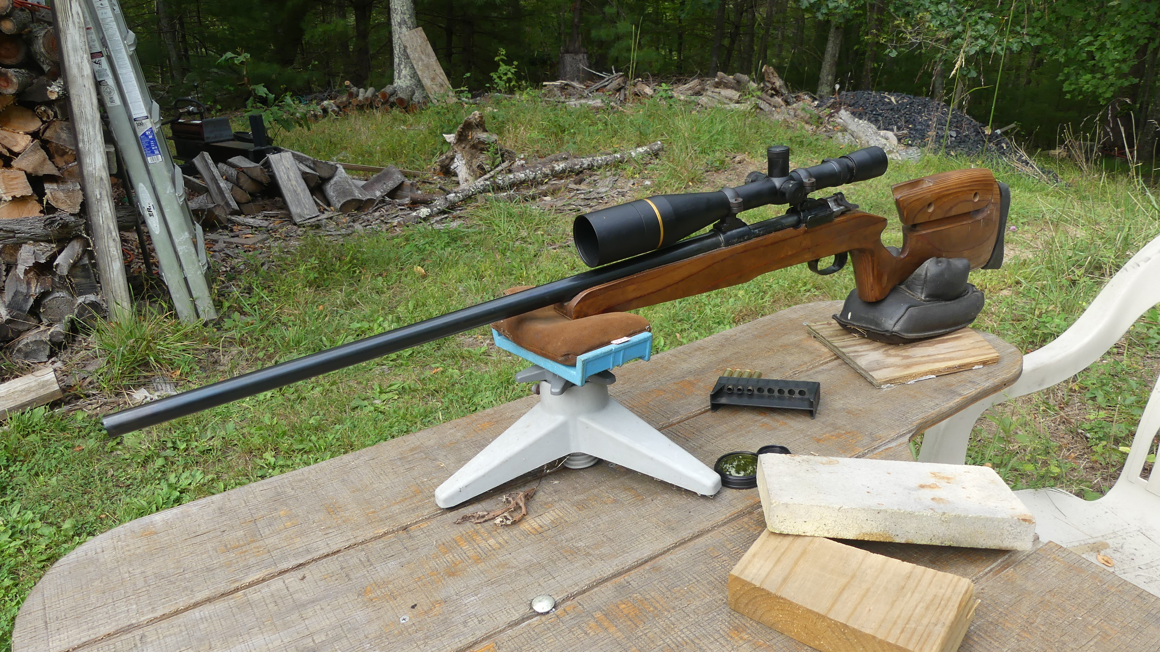

Well, so far the first part could be called "little girl", as in "when she was good, she was very, very good".
Heh. This was its 3rd 5 shot group. First was the lead load and fairly rotten, second was a "throwaway" load with 39 gr Varget, a 95 gr hornady (with ~ .1" jump to the lands - it's a tiny bullet for this caliber) - I moly coated them...all FLR brass which barely expanded and with no flattening of the primer. Probably ~ 3k fps, but I didn't crono - next nice day, I promise. I didn't think this would shoot, just kinda doing the shoot some and clean some breakin dance here. But.
Bore scope still shows lots of tool marks, and more copper gets on the grooves than the lands...Not so bad I want to use abrasive and fire-lap, I'll be patient - that's been working out so far, even if the anticipation is hard on me.

This is almost as accurate as you'd need to collide two bullets midair, or hit a bullet at around 1/3 mile. (I do have two guns with the requisite accuracy, FWIW - better than this one, so far)
