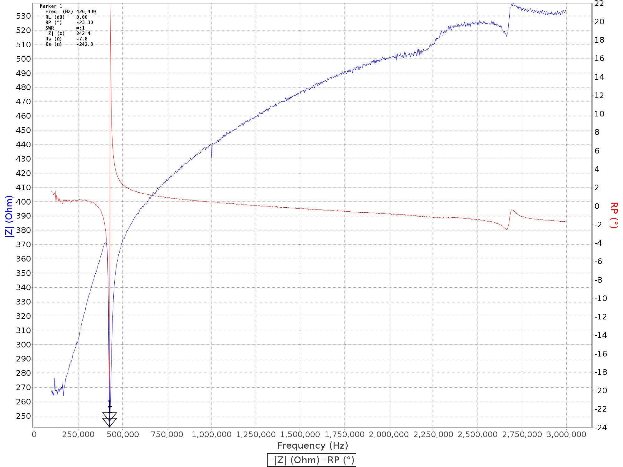

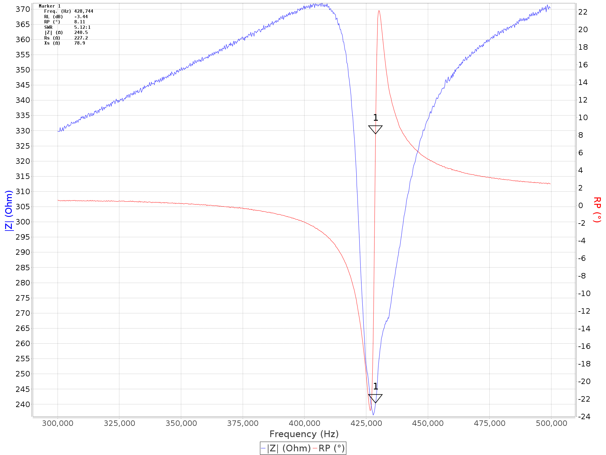

On a narrower sweep it looks like this: The marker here is 428khz or so - it's hard to hit on the head.
This is all looking into the power supply end of the inductor, being series resonant with the capacity of the tank and feedthrough.

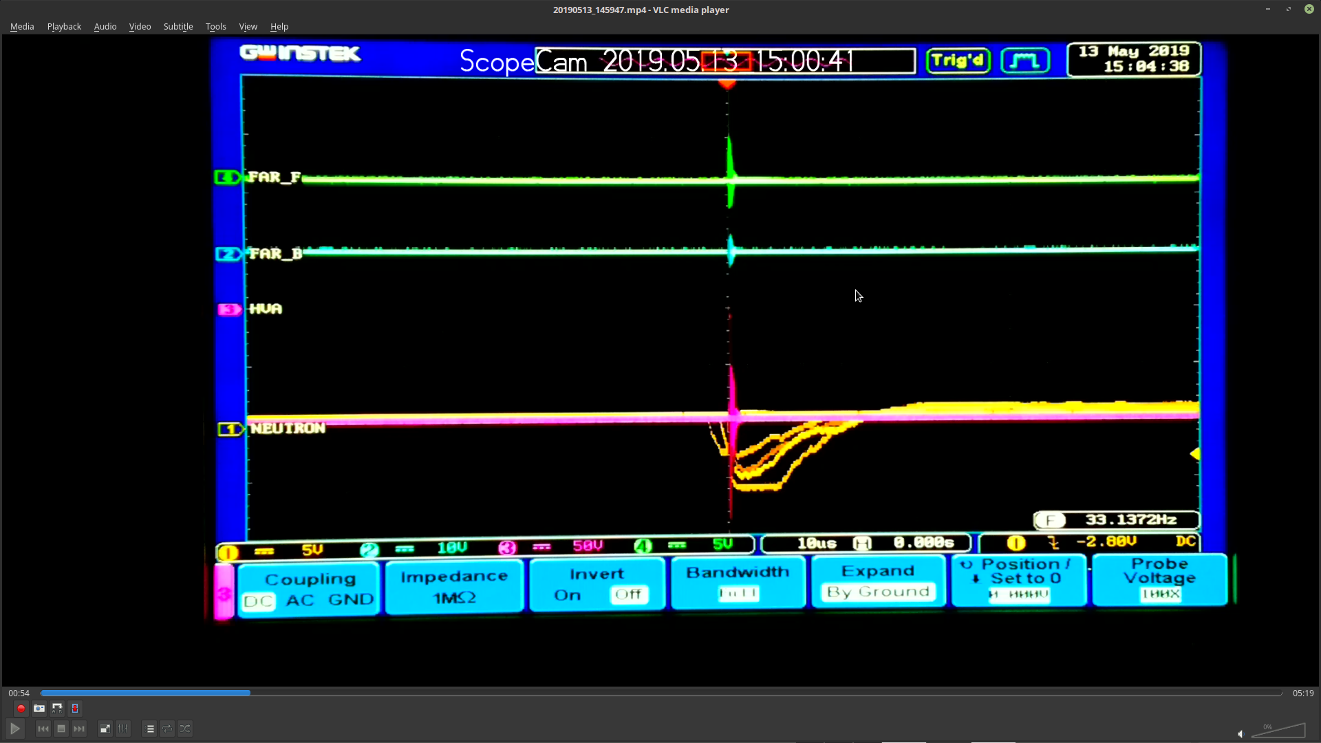

But before getting into those plots, lets look at a frame from the initial run from the big scope. Nothing really changed from the time I was trying to measure transit times, except I slowed down the sweep a bunch to see the hornyak detector waveform as a relatively narrow pulse. In retrospect, I should have sped it back up and adjusted the faraday probe gain up again - I had it way down for transit time measurements - interesting that with the RF on the main grid, I had to turn the gain way down, and with ions present, the faraday probes got LOUD - which is why I didn't bother to say anything about capacity coupled feedthrough there - it was clearly swamped by the delayed signal due to stuff flying around in there.
But here we are, kind of full circle: Now, these little disturbances and ringing on the various inputs other than the yellow neutron detector (the hornyak, so it's fast-onset) were happening lots of times with no neutrons detected (it's not a very high quantum efficiency detector FWIW- so there's added doubt) but it was very noticeable that, triggering on neutrons detected, you saw this almost every trigger. It's unfortunate that the purple trace happened to land at the same spot as the yellow one during "resting" or we'd know more. It's interesting that the fast arc-spike usually happens just after a neutron detection as well, and nope, don't have a clue why.
FWIW, this detector clipping on the negative (true) part of it's waveform means more than one neutron hit it in a burst.

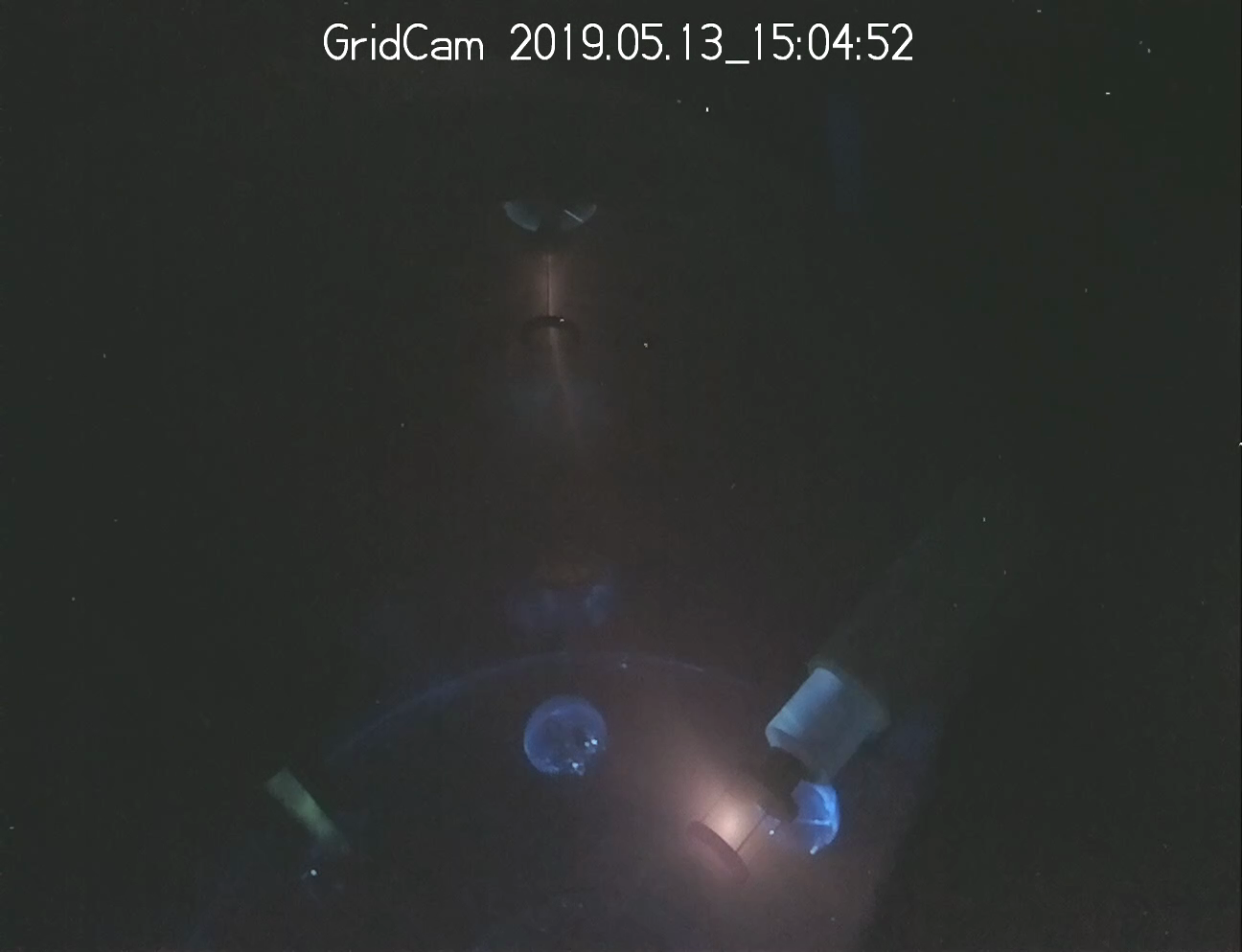

A capture of the tank innards. In the foreground is the ion grid, out in the middle of the big area (14" diameter, 26" tall). In the back 6" sidearm, roughly ending at the boundary to the big space, is the main grid.
The sparkles are X rays, hard to shield and let enough light through, and of course, a raspberry pi camera hunts around looking to reproduce the spectrum of D, and mostly fails - but we know that.
The neutron detector hornyak button is right against that sidearm, around a foot from the ion grid. I'm pretty sure what we're counting is from the main grid, due to inverse square, and due to the fact that it more or less stops when we turn off main grid power. Here, though brighter, the ion grid is at around 15kv and 2.5 ma,
the main grid is closer to 40kv at 3 ma. Being in the larger space makes Paschen's law kick in better for the ion grid, but for making neutrons, it seems that
less density - less scattering outside the attempt at a focus - is better. We don't want our ions to hit until they're moving fast at one another. The lower pressure seems to contribute to that in a couple of ways - one is there's just less to hit when the mean free path is longer, and the other is that it's more likely to generate copious new ions further from the main grid, at a better place in the electrical potential well, so they get accelerated more.
Remember, visible light is a loss here - it's a sign of ions recombining into neutrals at low energy, which is a fail. It may be happening "near the action" but it's not the action we're after at all. Those X rays, which the camera can't focus are a little more indicative, but neutrons are the real sign it's working.
Oh, the green glow in the lower left is a piece of a quartz stab-in heater, and the blue is from some ZnS:Ag I spilled in there years ago. It's hard to clean out a tank!
It's mostly electrons making the ZnS glow, dunno about the quartz for sure.

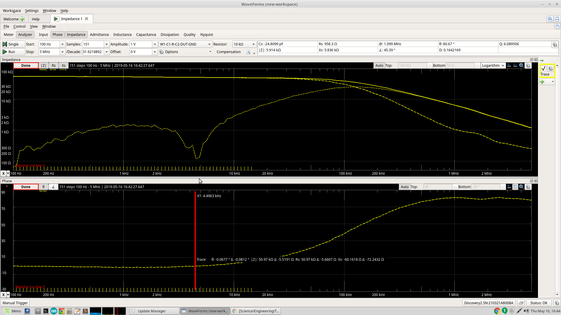

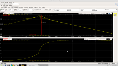

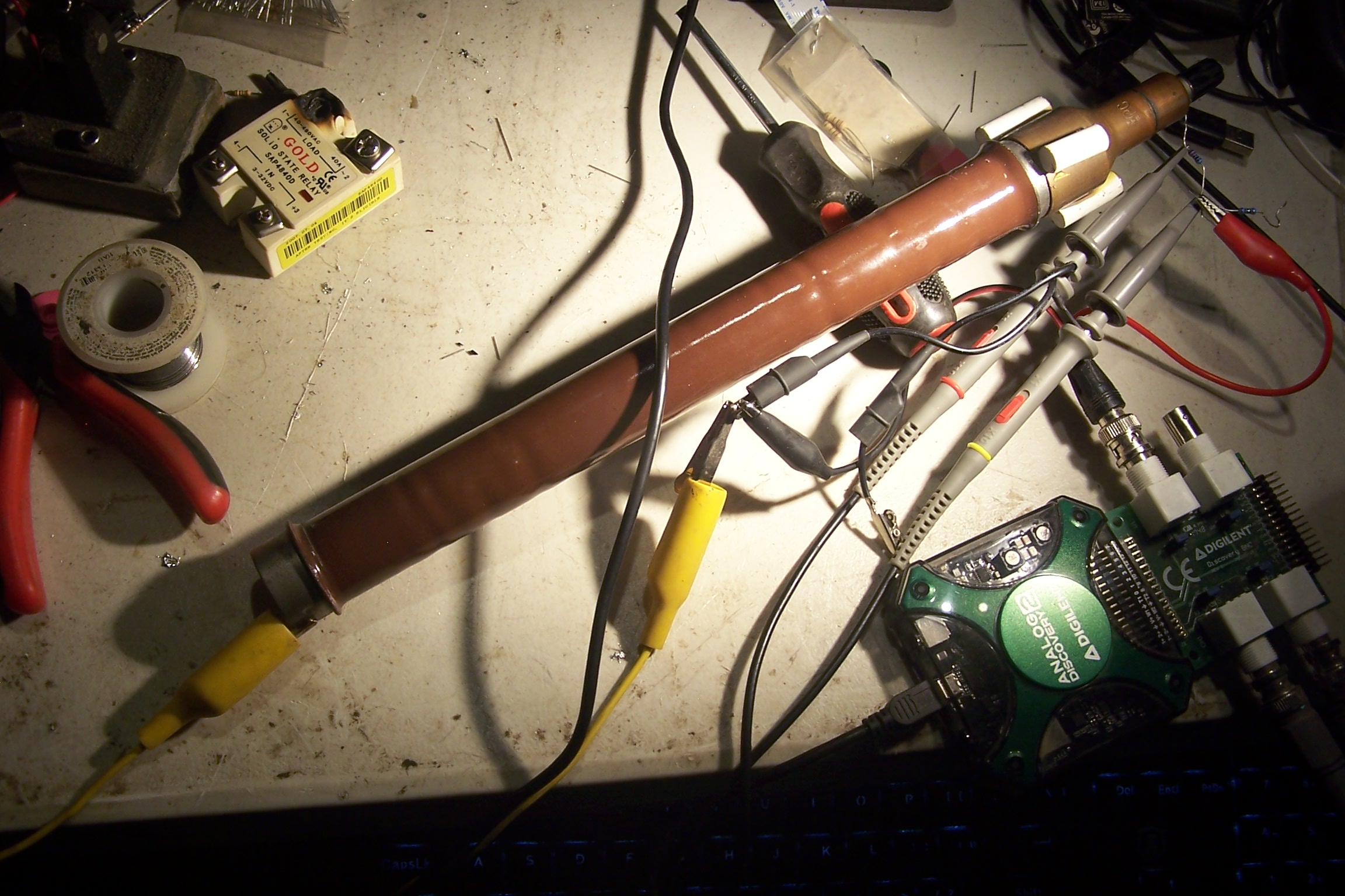

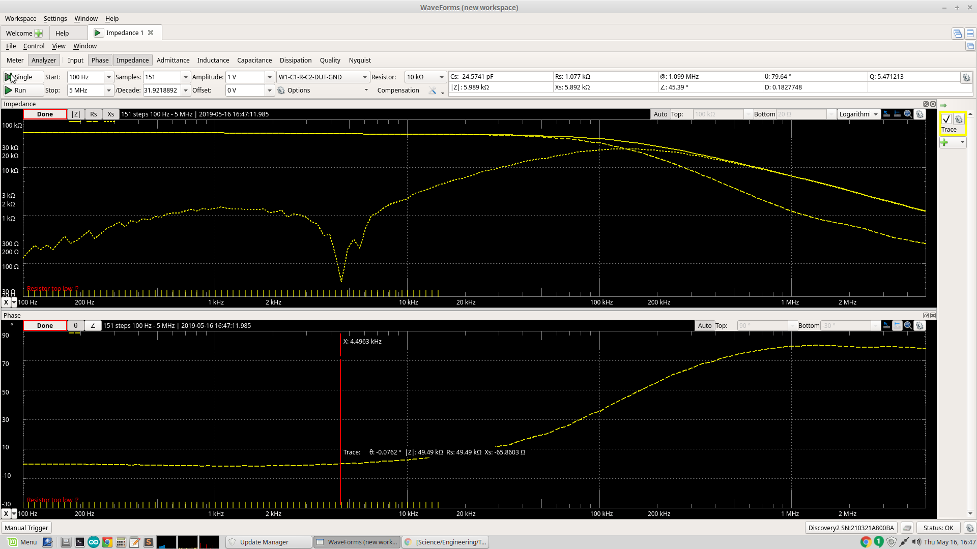

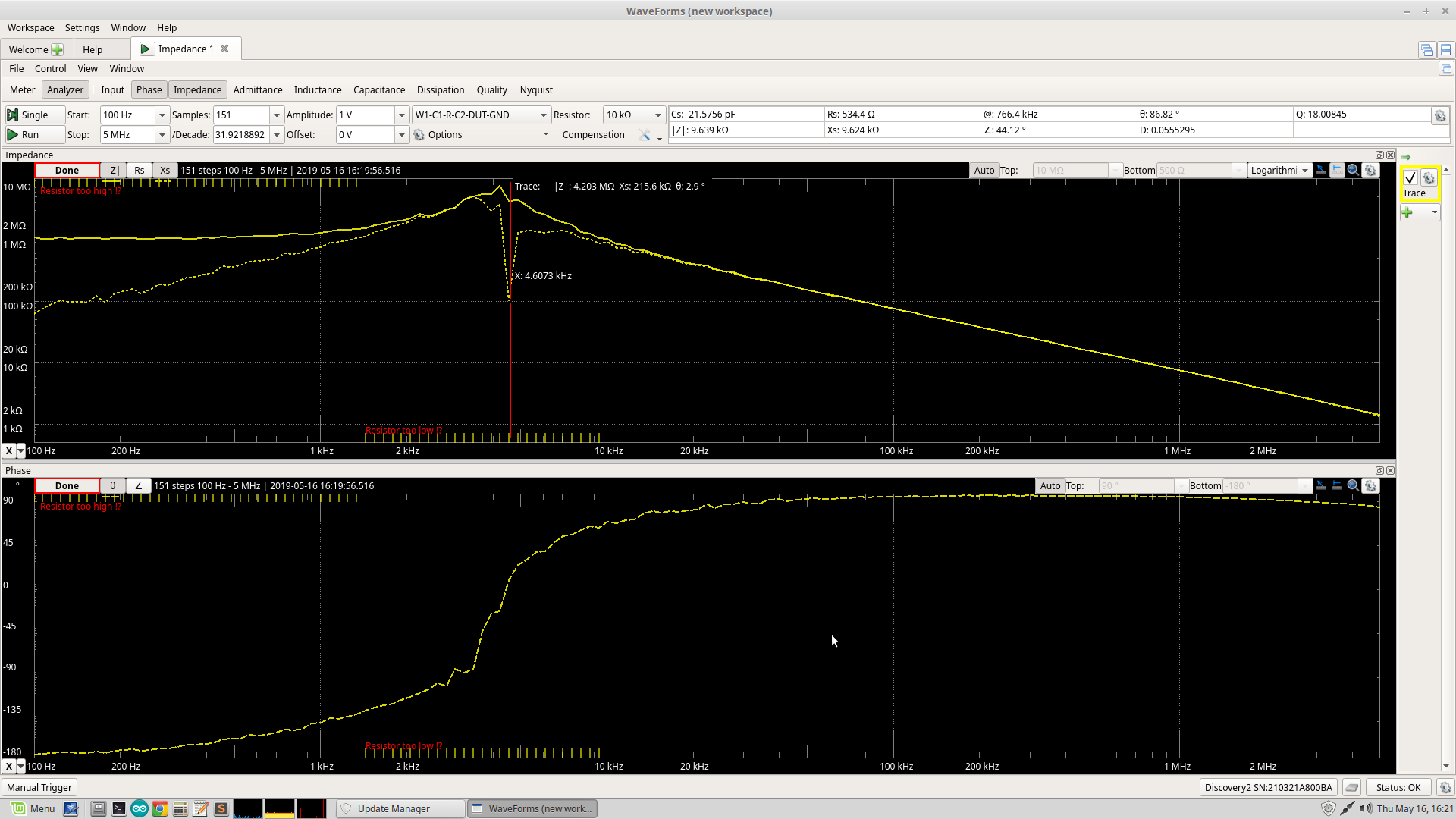

As promised, here's a measurement of the nominal 50k 225W cartridge ballast I was normally using. It's pretty horrible..
All pretty close to the same. I'm using a Digilent Analog discovery 2 to do these measurements. It's OK when you can double check another way that it's not telling you a lie. Here I used a 10k precision series R.
Open circuit at DC, a brown cartridge one they do go bad, and I hadn't tested this with the ohmmeter first....in use, it would probably have kinda worked, just arcing across the break.
