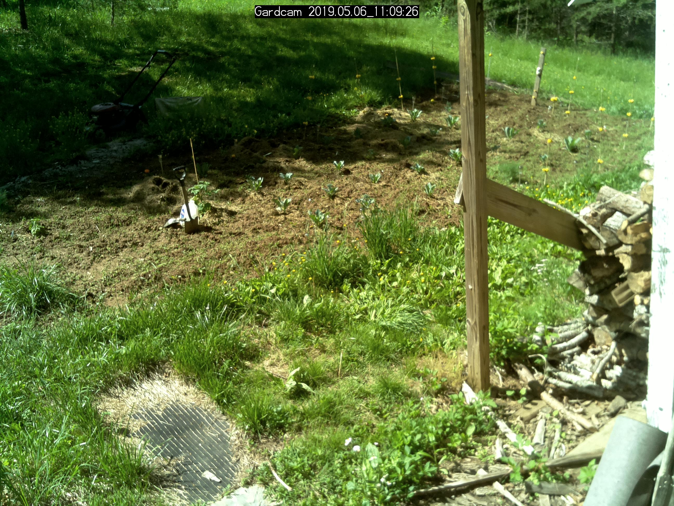

So the situation was this - I have a camera watching my garden (someone nicely came unasked and tilled it, so what's a guy to do? Plant stuff!).
There is also a passive IR long range detector there that radios to my living quarters (a whole building away and a long walk to the garden). It false alarms a lot.
I have an electric fence charger that will put the fear of death into any being - but thick enough fur and it won't jump through, and deer, well, anyone who does a garden knows that unless you put a cage over the entire thing, they're just going to jump over anyway. It's a puny effort this year but this is for the fun of it anyway.
View of the garden, the IR detector is on that post at the far end.  The computer controlling scary lights and sound is on the other end of the building.,

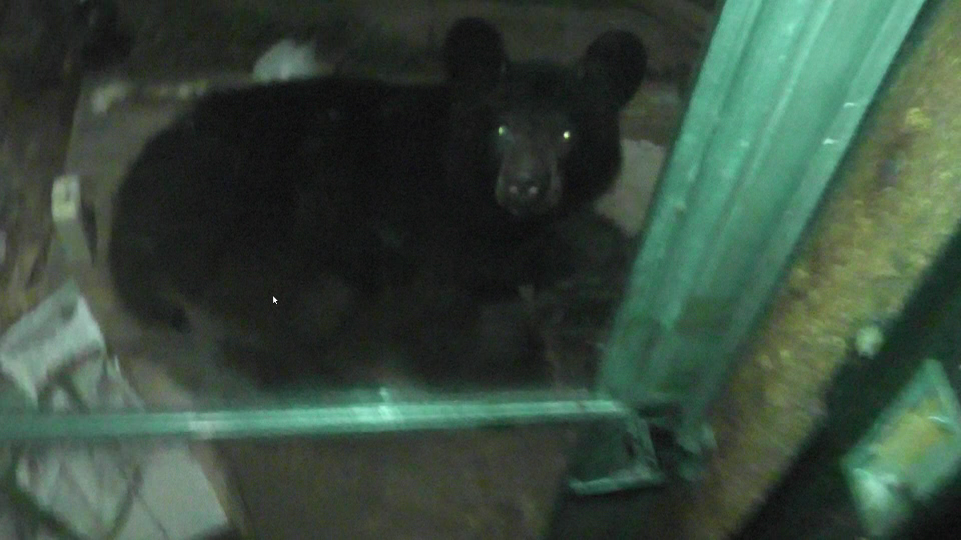

I've had bears here too - the cat food dish (no longer out there, I'm catless right now) brought in all kinds of critters, one even curling up on my porch as if asking to be adopted. Yelling worked at first but they got bolder, and mama even stood up against my front door and it pushed open, leaving her and me, both very shocked, in my living room. Shooting nearby (not to hit, but to scare) worked, but really the thing was getting rid of all the free food. I did wind up shooting one possum and one racoon who just wouldn't respond to the usual chasing away with a broom. But that leaves you a mess to clean up. And any "real" gun (eg not the .22 LR rifle by the door) needs hearing protection - I value my ears.
Cute despite bad photography through the door - mama at 500+ lbs and ~7' was in the shadows outside the field of view.  The cub is cute - but things that could kill me by accident do put me off a bit.

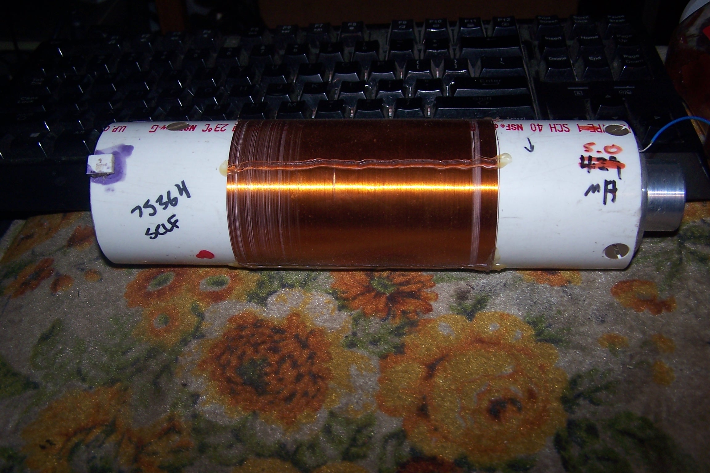

I had a medium Q inductor in series with the supply - I still have it and one or two others that produced results much more interesting than the usual ballast R (which I'd stopped using once I got rid of all feedthrough arc issues anyway). The measured resonance with no gas/ions tended to be in the 1.6 to 2.2 mhz range for some, but the "magic" one was much more inductance but lousy electrical Q, pictured below. (having a coil winding jig built for your lathe and tons of wire will encourage one to try stuff!)
I was running my full 50kv or very nearly, running an ion source (same one I'm using now - just a reduced size grid out in the big tank with DC on it - current limited to 2.5 ma and usually in the 10-20kv range) and running system gas pressure on the hairy edge of what would work under Paschen's law - and in fact in "the event" I had what seemed to be some kind of relaxation oscillation going on - huge kick back from the inductor re-accelerating a few ions might explain some things? But the (electrical) Q wasn't that great, even unloaded! Don't know, the numbers were "too fantastic" by normal fusor standards, though when thought about, still way not over unity either...just enough to be an issue to be in the room with. I've since re-instrumented with stuff that won't fry or blank from high count rates, and been slogging away trying to get this going as a driven thing....rather than as a lucky chance. hopefully I don't obsess too much and go alcoholic like that other Philo guy...
I've kind of tried to look at what it could possibly have been - and still fit within the standard model (with only explains after the fact, it's a terrible predictor).
And slowly working through the numerous possibilities. And that's about all I know so far, it's frustrating. And in some sense a risk. But giving up is a sure-thing loss.

Here's the inductor. Several I built gave very roughly similar results, but this one hit it on the head. All resonated with the grid/ft somewhere. This one, at around 5 mh, should have been resonant at around 250khz. Another one that gave really good but not as spectacular results (in what looked like stable running) resonated at 1.8 mhz. I tried a couple in that range of varying (electrical) Q but never went anywhere much with that. They helped some compared to nothing.
The inductor in the main feed.  I might have had a chunk of ferrite in there, but probably not.
