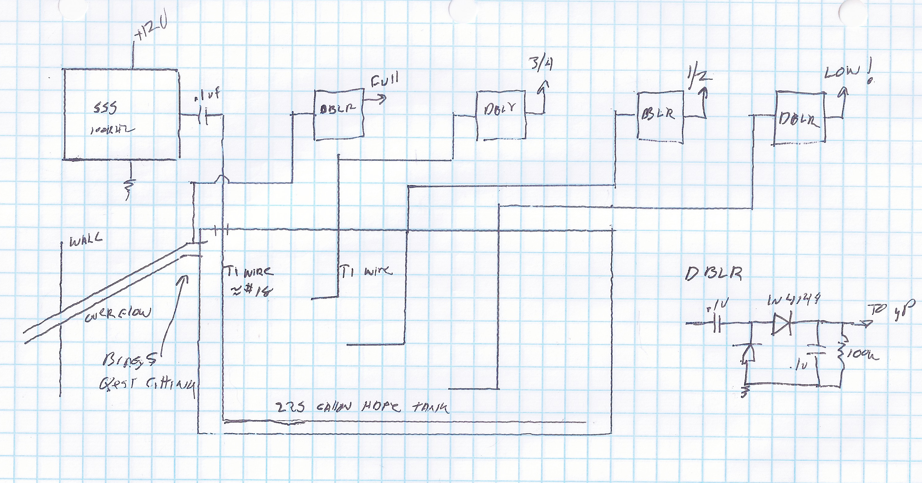

While you'll have to tune this for your own application somewhat, the example I'm using is good for a lot of things. Some cases might need re arranging the block diagram compared to what I did, as you can't drive something grounded with a signal very well - but you could instead make sure the grounded thing is well grounded, and then couple a little bit of the driver signal into the electrodes instead, and when they "see" ground, the output goes to zero, instead of going high as my current lashup does (my water tank is insulated from ground, so I drive the water itself with a Ti wire along the bottom of the tank).

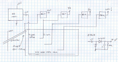

What you need is a fairly "stiff"(or low impedance) source of some AC signal - I'm using the old 555 chip setup to make almost-square waves at 12 volts in my setup.
That's capacitively coupled to the drive electrode in my topology - I just used a generic .1uf cap as I had those lying around - it's much lower impedance at 100khz than needed, but hey, those are ubiquitous in everyone's junk box.

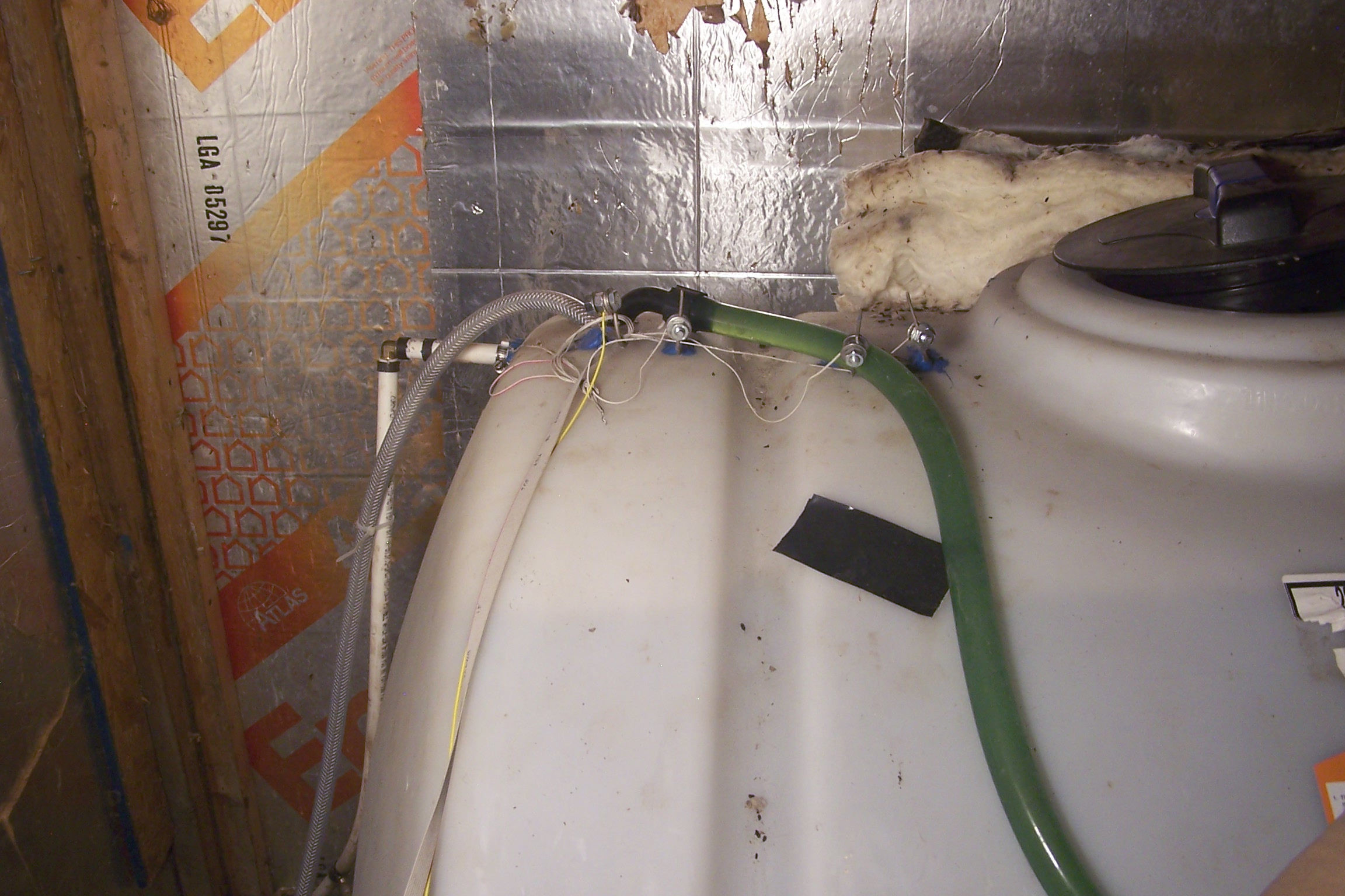

Elsewhere on the tank, I have in my case, 4 pieces of Ti wire sticking down from the top - just glued into holes drilled into the tank top (it's a big tank for agriculture use but makes a nice cistern) and sealed up with silicone gasket maker (eg not the type that makes ammonia when curing). I just bent the wire ends into circles outside the tank to make a lug on each.
The sensor circuit is super-simple - it's just a capacitor input voltage doubler - 2 more .1uf caps and two 1n4148 diodes, with a 100k load to ground on the output. When this signal goes "high" (and it works with either 5v or 3.3 v logic, it's very robust) - you have water reaching that electrode. So 4 sensor wires give me 2 bits worth of level resolution, which is enough for my management needs.

Here's a block diagram of what I actually implemented for my particular case - the concept is actually the important thing here.
Nope, no schiz for the 555 oscillator. If you can't do that, you have no business on this board at all. Any source of medium HF will do here, if it'll drive the load,
it doesn't even need to be 50% duty cycle - that's what the capacitors will take care of to prevent ANY DC current in the sensed system.
Block diagram
Block diagram

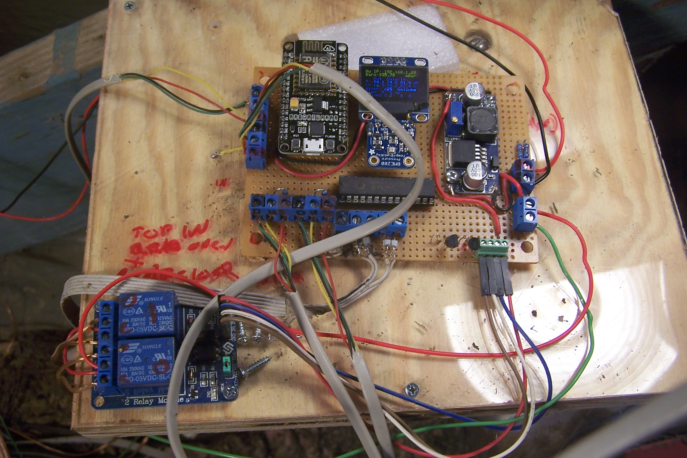

Here are some gratuitous pictures of my setup, including the ESP8266 board (which controls plumbing valves and also senses weather indoor/outdoor) - it acts as a slave to my LAN of things, where a raspberry pi runs a web server (NGINX) and has CGI's to make plots and let me set things like valves.
The sensed object - a 225 gallon tank

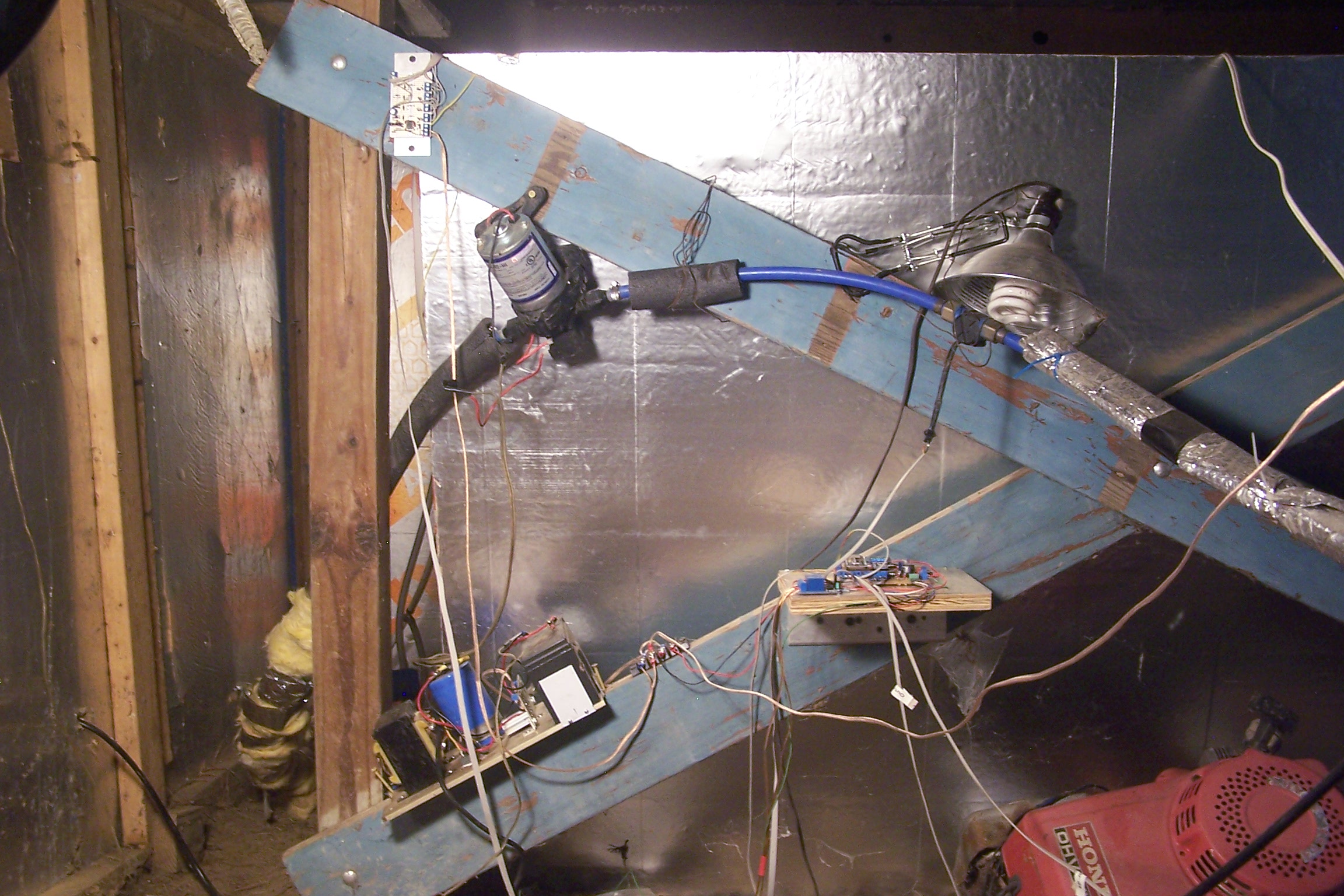

Electronics overview, including the UPS and water pump

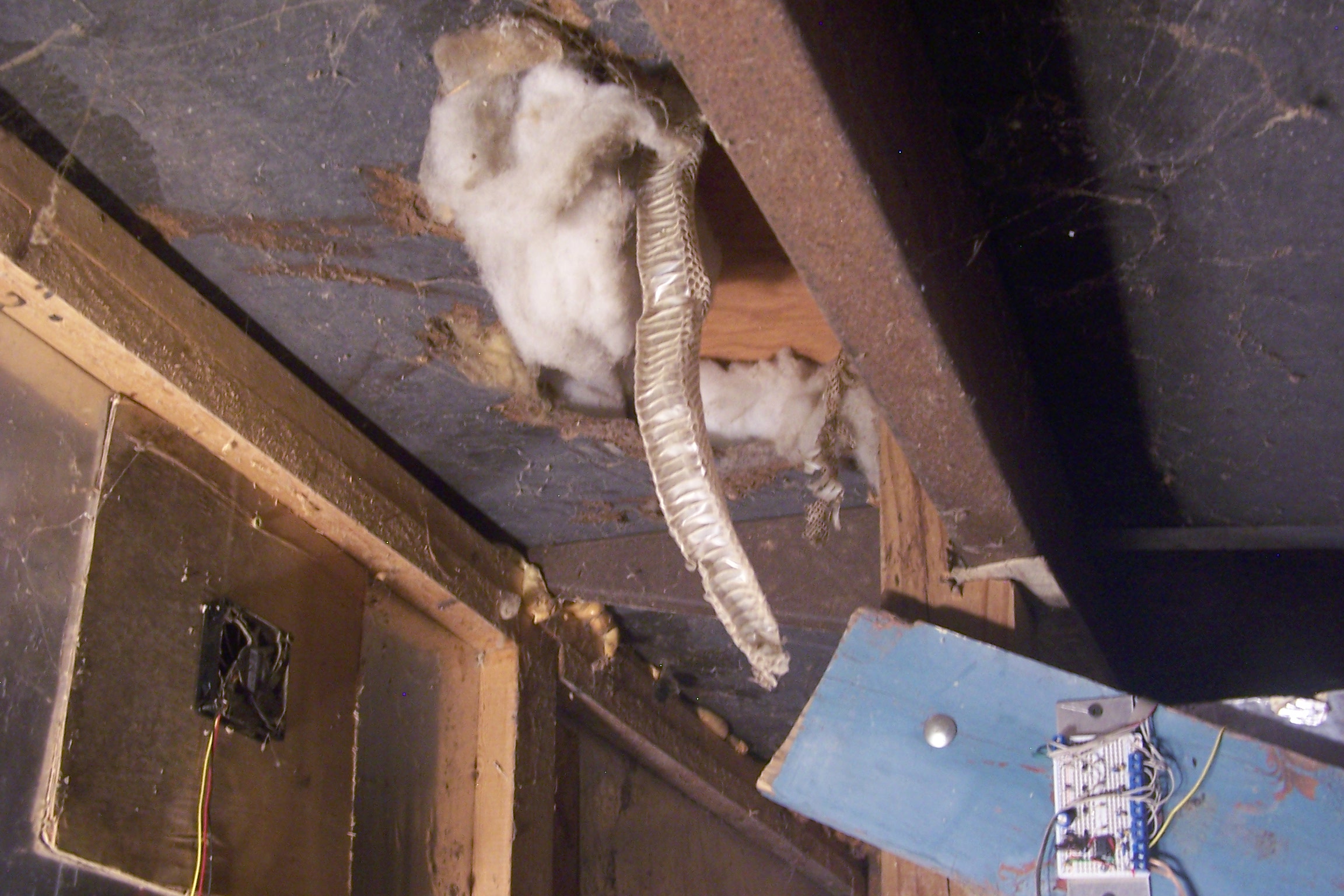

Why'd it have to be snakes?  Board in lower right of pic
ESP8266 LOT slave/sensor/controller
I used an MCP 23017 i/o expander on the ESP-8266 to get more IOs for this and valve control. This part doesn't need to be fast, so an I2C interface is fine.

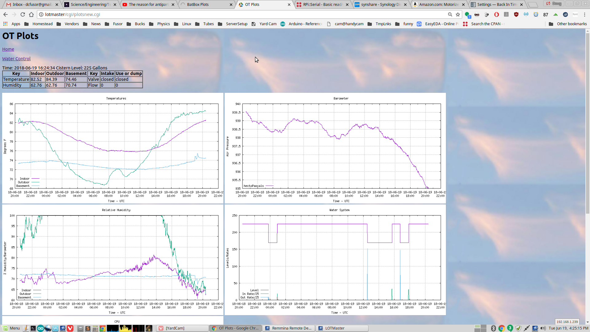

Here's a shot of what I see when I go to the environment page for this building in my LAN of things. There are other pages to control things, and to monitor things like the solar system as well..another day, another post, maybe.
Screenshot of what I see when I surf to this part of my LAN of things.
