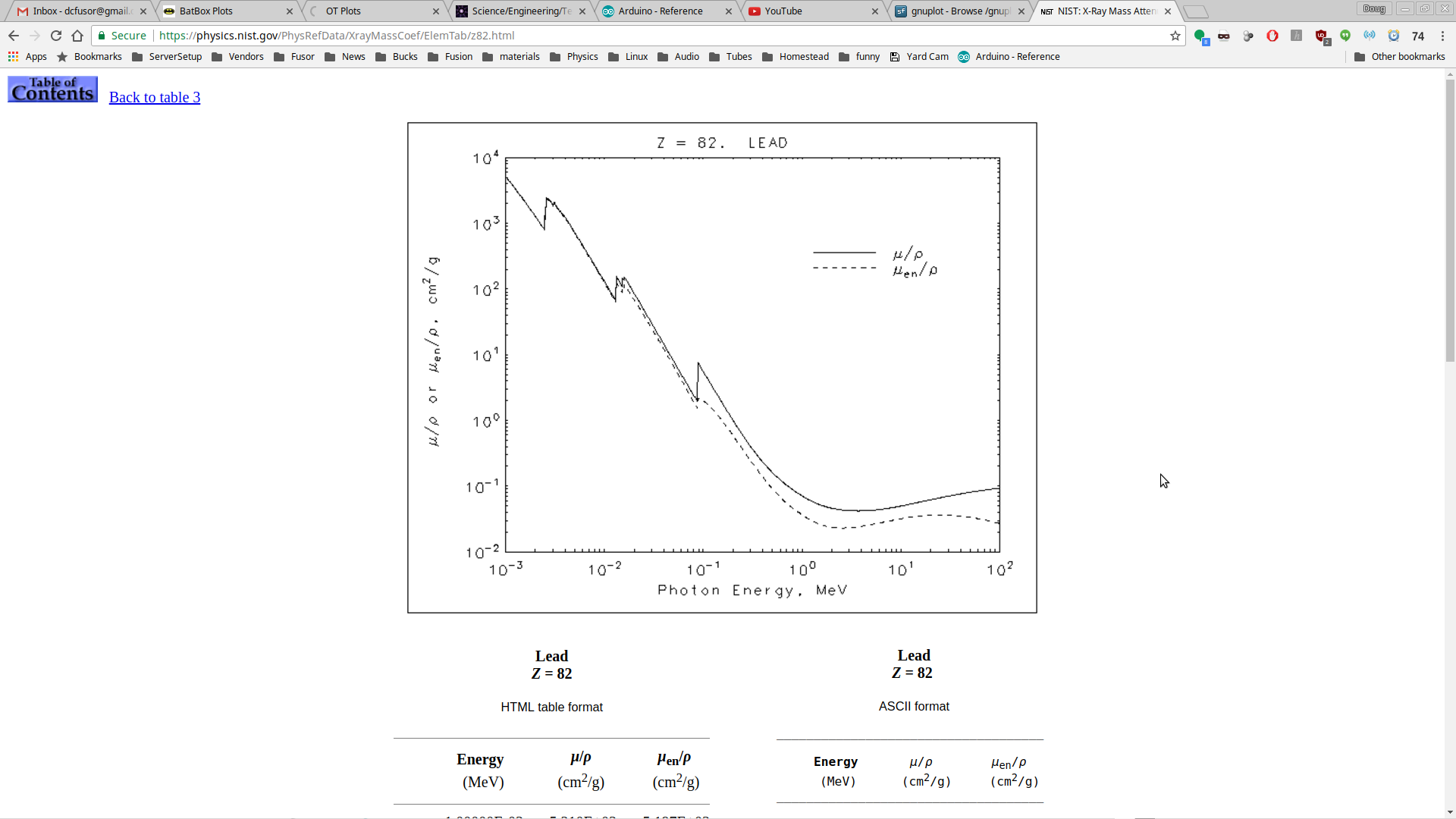

I've been getting some static about "why are you taking so long doing all this remotely when you could just use a buncha lead and be safe?".
Answer - because the amount of lead my floor will hold up is useless against high energy gammas, and of course, neutrons - remember atoms are mostly empty space, and it's like spraying neutrons between widely spaced bowling balls - little neutron energy is lost, they are just scattered a little - for that, low Z stuff works better.
Anyway, I gathered up a little data so I have something to point the static-givers at.
Note log scale - good for hospital energy X rays, horrible for all else.
So, what's that? 5 or so orders magnitude drop between low energy and 2 Mev or so? So it's not exactly linear (would be if that line were horizontal) with energy, right?
