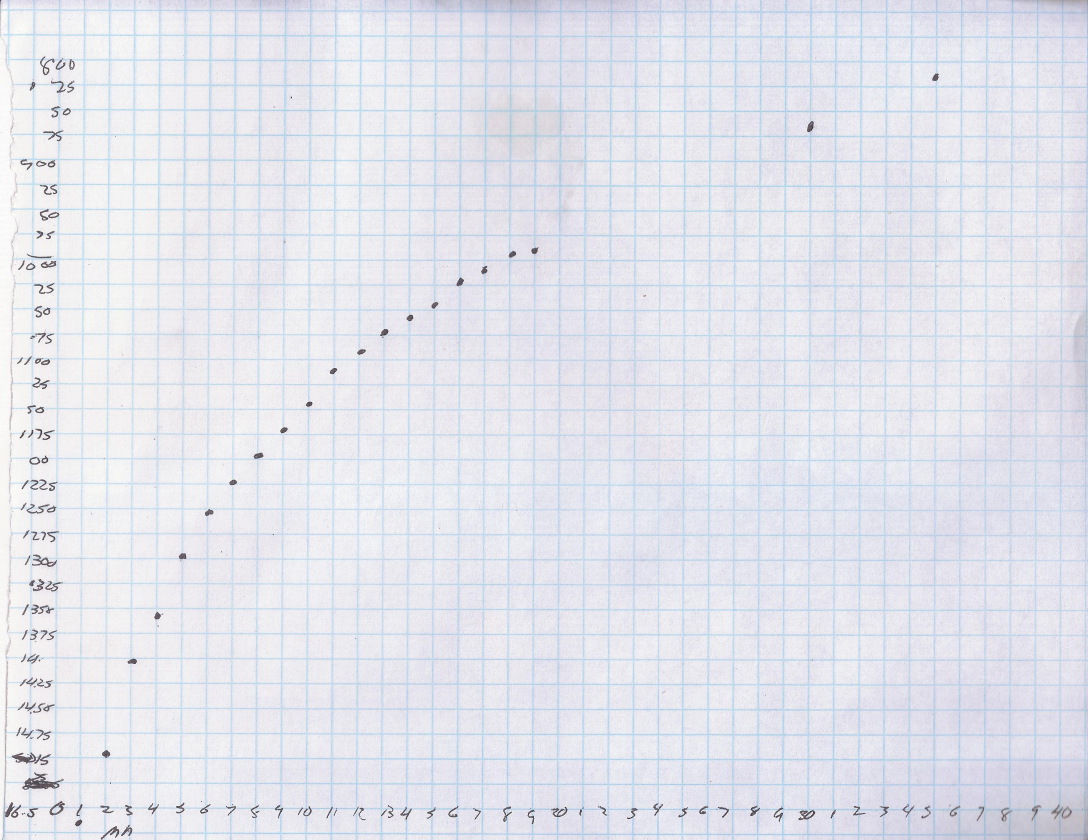

The result has a rather amazing plate current vs grid bias curve, or at least, I've never seen anything quite like this before. In doing a little curve plotting, it was rock stable and never hinted at oscillating, even though the plates output lead does go under-chassis with the grid stuff. Bill and I didn't run this up to high power where there'd be big dissipation, we just wanted to find the lower end of the curve on this, so I could design a driver to go between an arbitrary waveform generator and this thing (which in turn will drive a homebrew wideband stepup transformer to the main grid, with separate DC bias for the grid via the secondary winding).

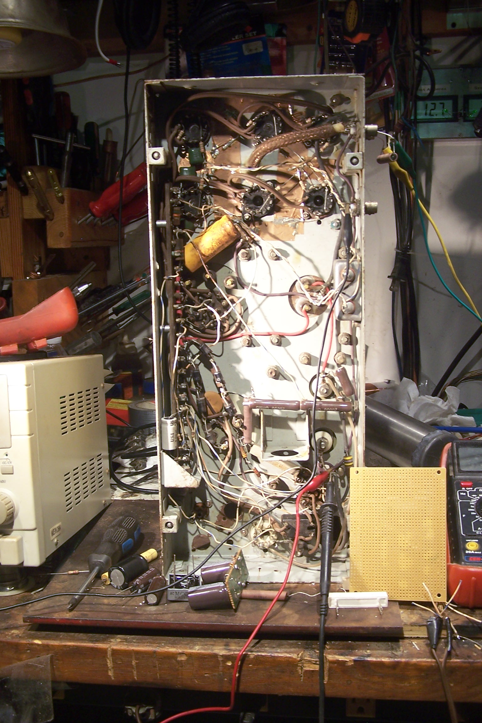

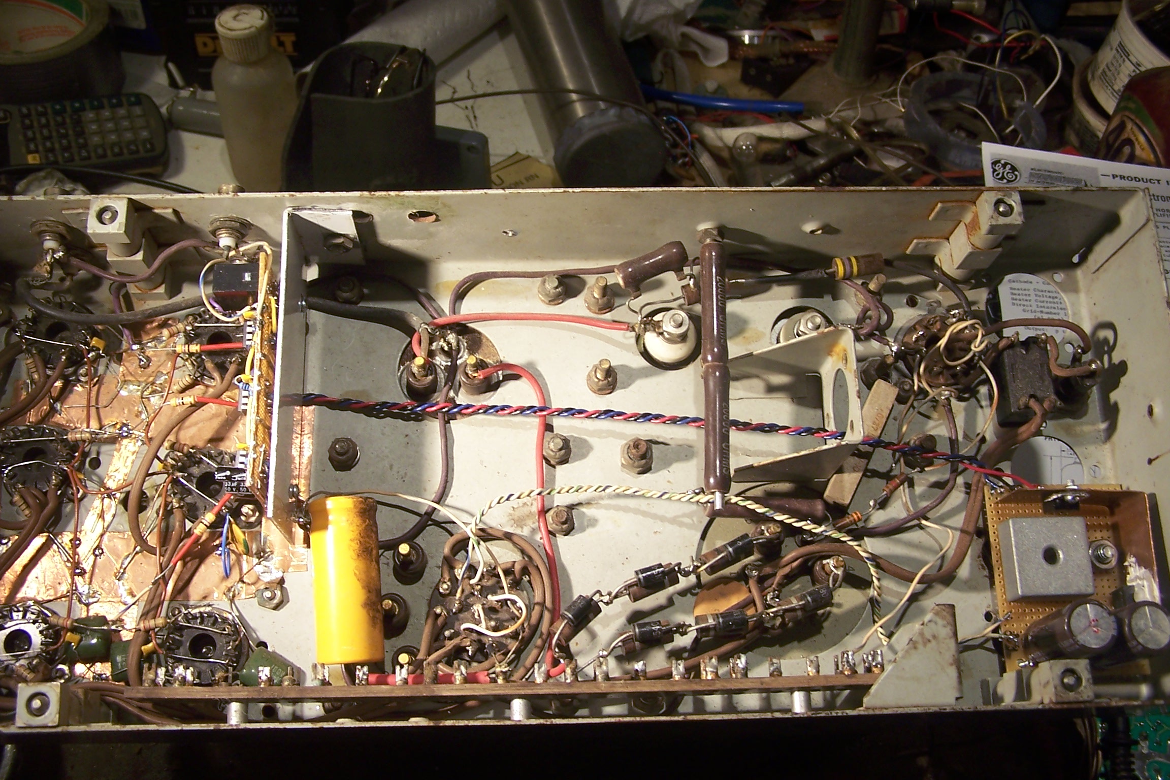

Having built this oh, 40 years or so ago..there was a bit of trepidation firing it up again, and it looked like I used good parts for the time, but was also in a hurry...at least I used a copper foil ground plane around the tube sockets. As luck would have it...it all flew. Looks like this under the chassis. There is an adjustable supply to the left to run the curves with, and various meters out of picture on the right to get the data. And that data, again not to full power or even close, created this unusual curve - I didn't plot every point once I realized we got to straight line land. Wow! I can drive this with modern fast opamps! I bought ADEL 2020's, one per tube as the input C is kind of high for one opamp to do them all. I don't think I'll need more than 20 MHz.

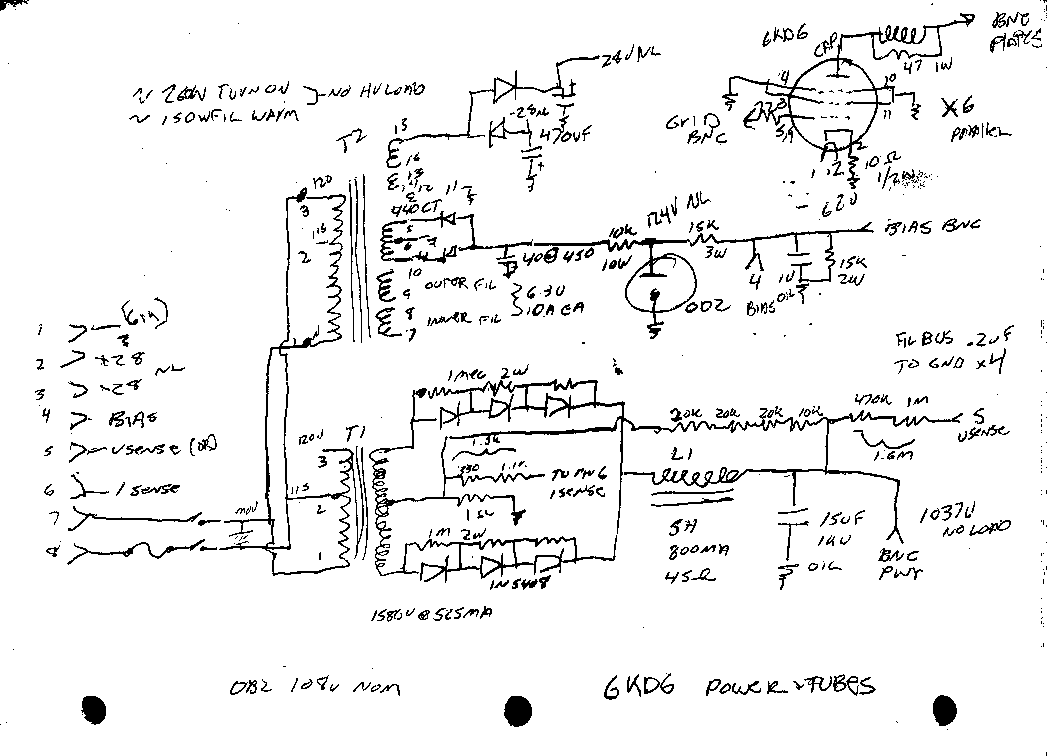

I can DC couple this all the way to the output if I want to and am careful. The supply is around 1kV at around 1 amp continuous, but will do a LOT more (Navy destroyer radio supply stuff) for awhile, and the tubes peak at around 1.1 amps - each - cathode current, and will easily take 10kv or so peaks on the plates.
This is why I resisted all the comments I should use some crappy old skool ham amp tubes. The're not even close to this kind of (well, ICAS) performance - opamps vs 100w driver, I'm in!
Here's what was in the box, more or less. I don't guess I'll need the bias supply, but I will beef up the half-wave rectified +/- 28v supplies (from spare filament windings) to run the opamps, so making that power supply and figuring out how to fit that in are next. Also, for reasons that will be obvious to anyone with some experience here, I want to move the plate connections fully above-chassis and make a new bottom plate to shield the input side of things.

This is a funny config - screen and beamforming grids grounded - you'd never turn this mess off at a mere 16.5v bias if there was screen voltage. Cathodes 10 ohm 1/2w R to ground - fuses, kind of. They'll go first in a catastrophe, but in a long slow overload won't do what's wanted.

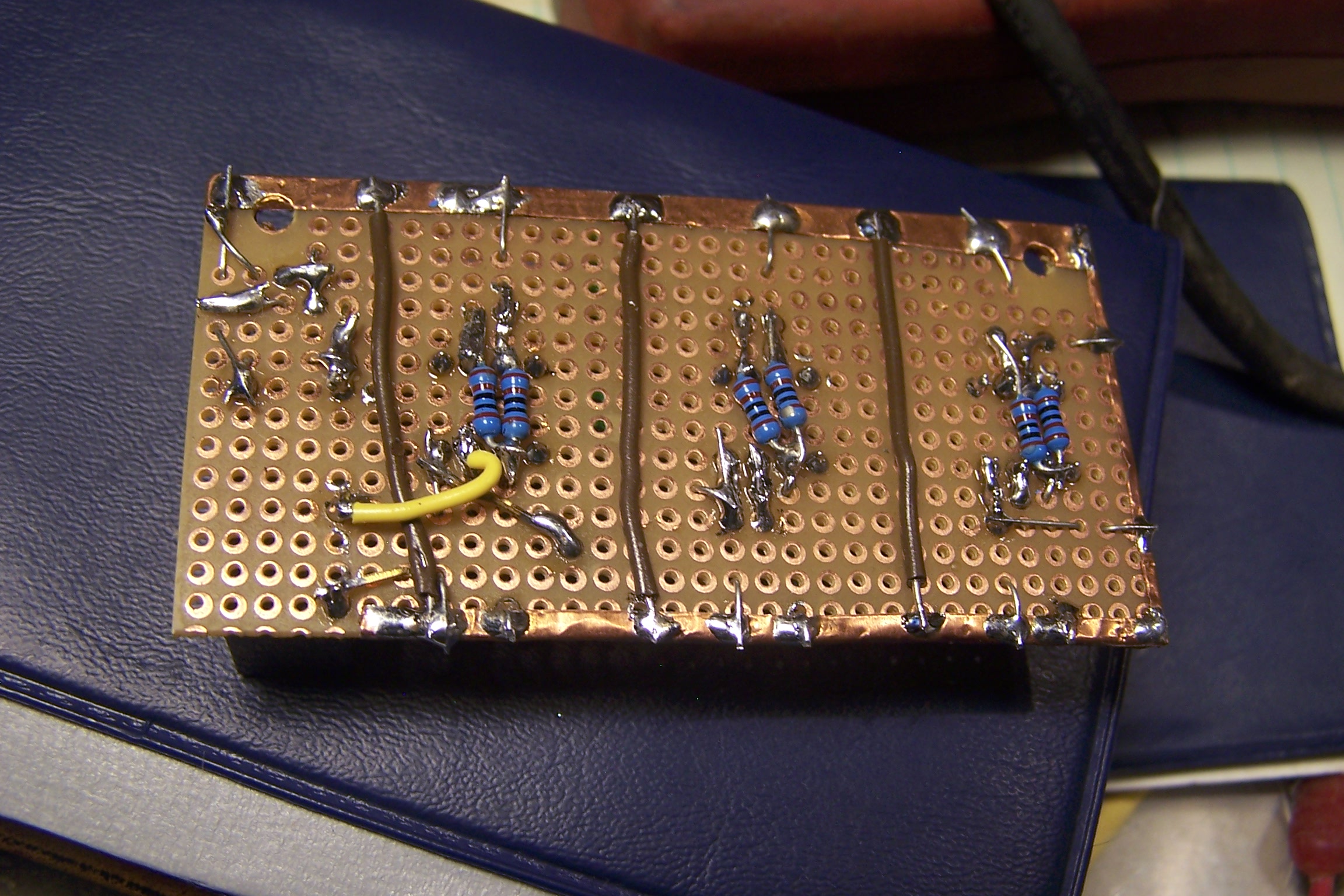

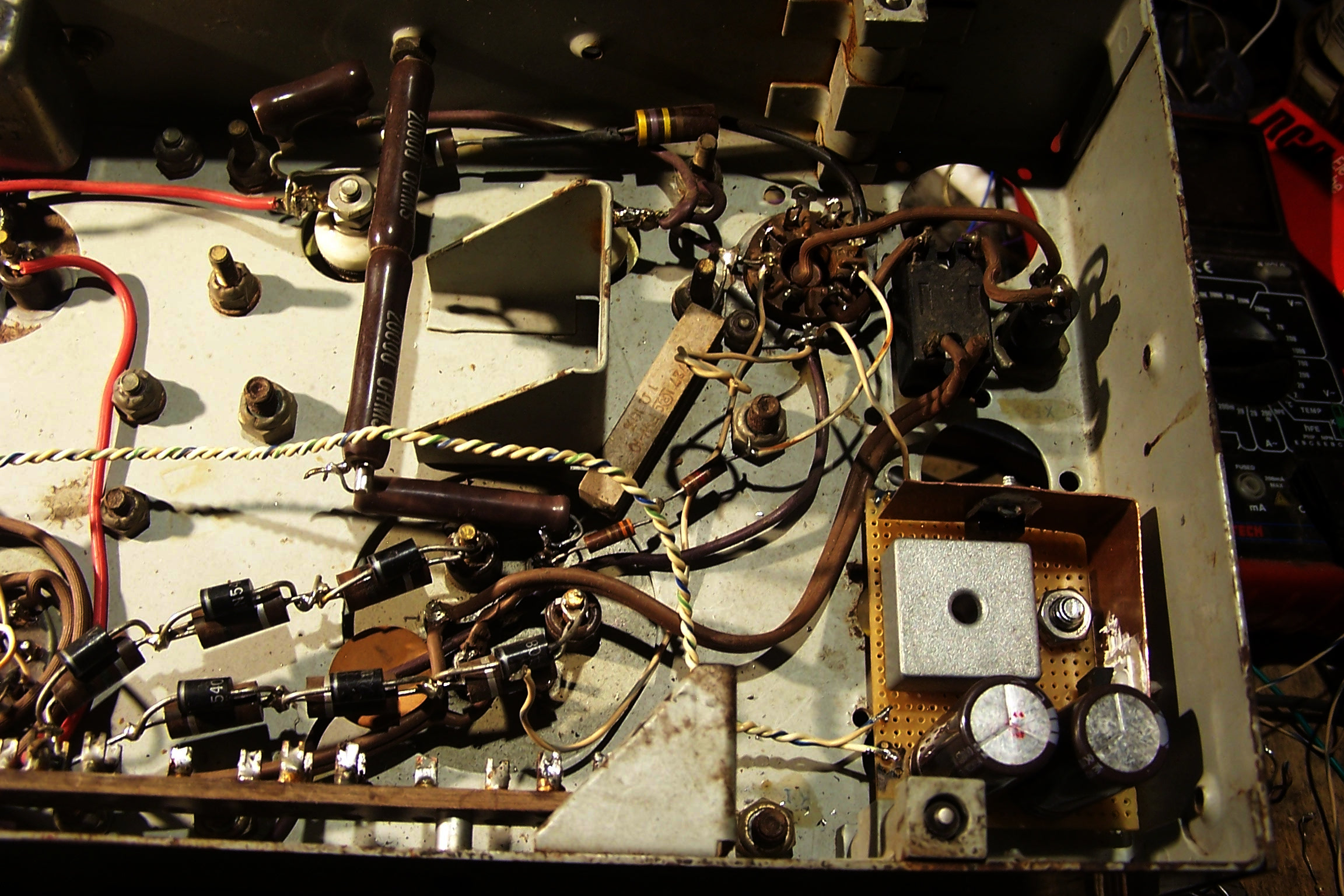

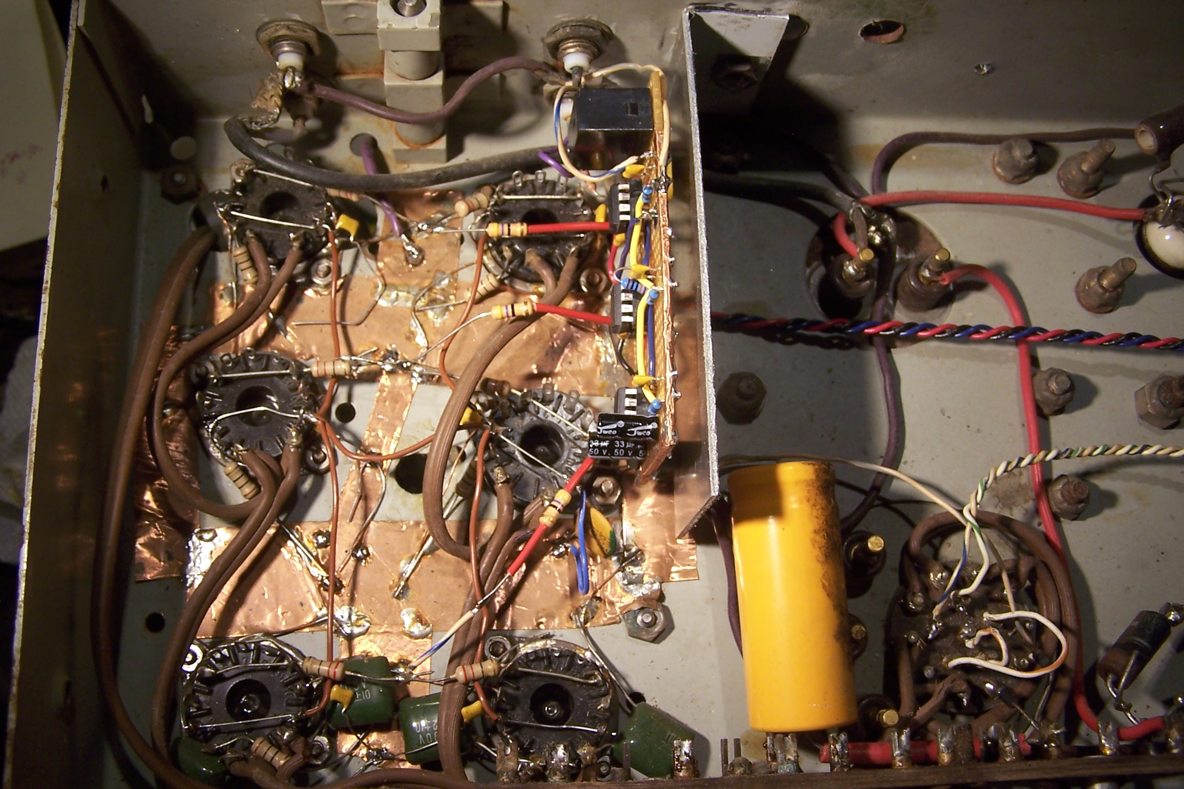

I didn't like the really cheesy +/- low volt supply in the amp, so I built a slightly less cheezy one and put it in there, hope it's enough for this: It's still half wave, the bridge is likely a lot more ampacity than I need, but is nicely its own heatsink. The 7815 and 7915 I hope will do...
Bigger capacitors but still only half wave (but +/- 28v no load).

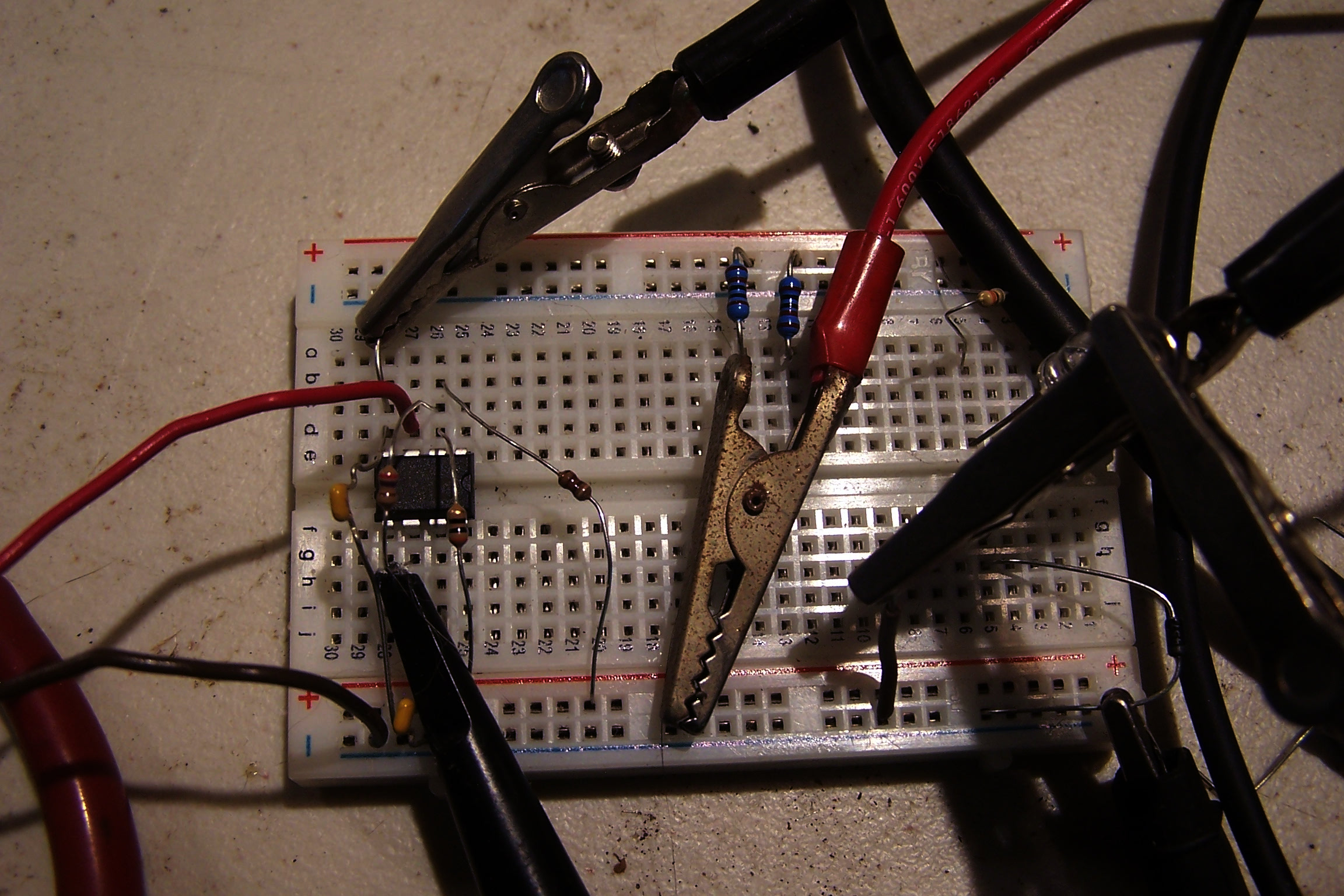

This is meant to run 6 of these, one per tube on each tube's control grid. here's the prototype, using the circuit from the datasheet above for gain = +10.
I added a resistor from the - input to the positive power supply to bias it for a dc coupled input that only goes positive from ground, eg with ground on the input, the output of this is at the negative limit (good for resting the tubes). Now, those teeny 270 ohm resistors get kinda too hot...and the waveform is just about perfect (clipping a little on the negative half is intentional for this test), so perhaps what I should do here is increase all the R values to higher ones, as I don't need the full performance this thing appears to have. I suspect I'm only going to need about 1/5th the frequency response this delivers right now for the real deal, so changing the resistors to be a bit easier on them and the power supply looks like it's in the cards here - I may have to order some more (for things like this I like them to all be from the same lot and match..OCD), but so be it.
You kids have it too easy. Anything even close to this "hot" would have instantly been some kind of oscillating transmitter with this sloppy construction, back in the day. Of course, now I have it too easy too - nice little bench, killer signal generator I built, scope, computer...all the toys right at hand. Makes this easy once you know what you want and how to design and what to expect.

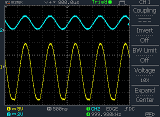

For testing, I changed the feedback resistor to 1k, bias to 1k, - input to ground 100 ohm and am sweeping from 5 KHz to 2.5 MHz and it's perfect.
~ 10 mA draw on the negative supply, around 20 mA on the positive supply (per amplifier, no load).

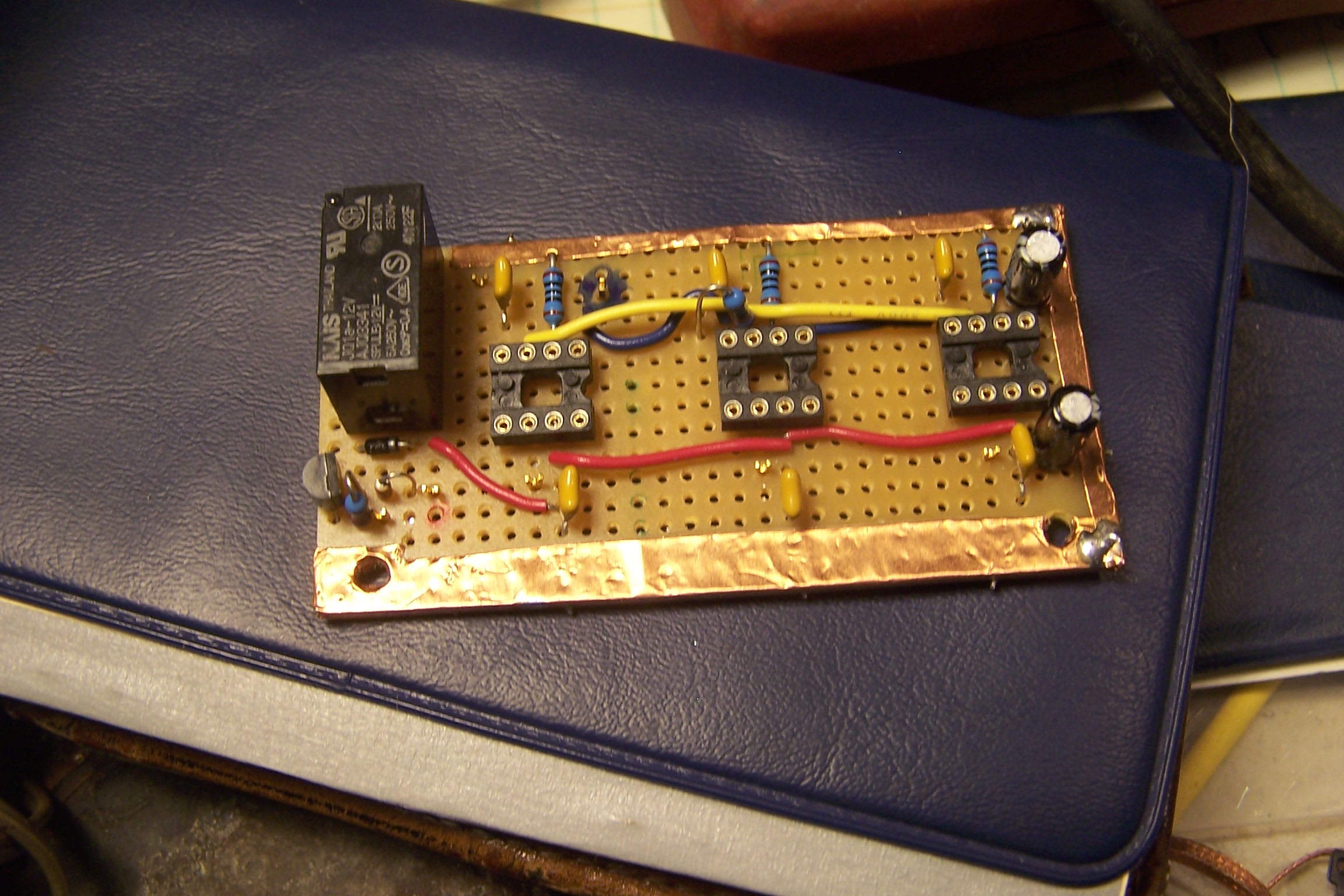

So, as Joe Piezynski would say (and did in his threading video, it's about time to clench those cheeks and apply power and RF to this preamp and see where the smoke is the prettiest.
Schematic once it works. This is 3 channels to drive 6 tubes, with a relay on the input that either selects the panel BNC or a resistor to -15v to turn things off. ADEL 2020 opamps will go in the sockets.

Well, after finding one bad solder joint (
) it seems to work perfectly, though the opamps do get warm even at no load (not surprising for these specs).
https://youtu.be/QUX1c1CrTBU
shows a nice little sweep from 5kHz to 2.5 MHz, flat as can be - note source is DC coupled and puts out positive from ground only, and the preamp here is also DC coupled but outputs the negative rail voltage (around -15v) at idle or with an input at ground, which is a good resting bias for this amplifier in this configuration. A relay connects the preamp to either the input or a slightly negative bias so I can "blank" the setup for when the FeelTech Arbitrary wave generator is glitching while I'm changing its parameters (there is no way to tell it to shut up while doing that).

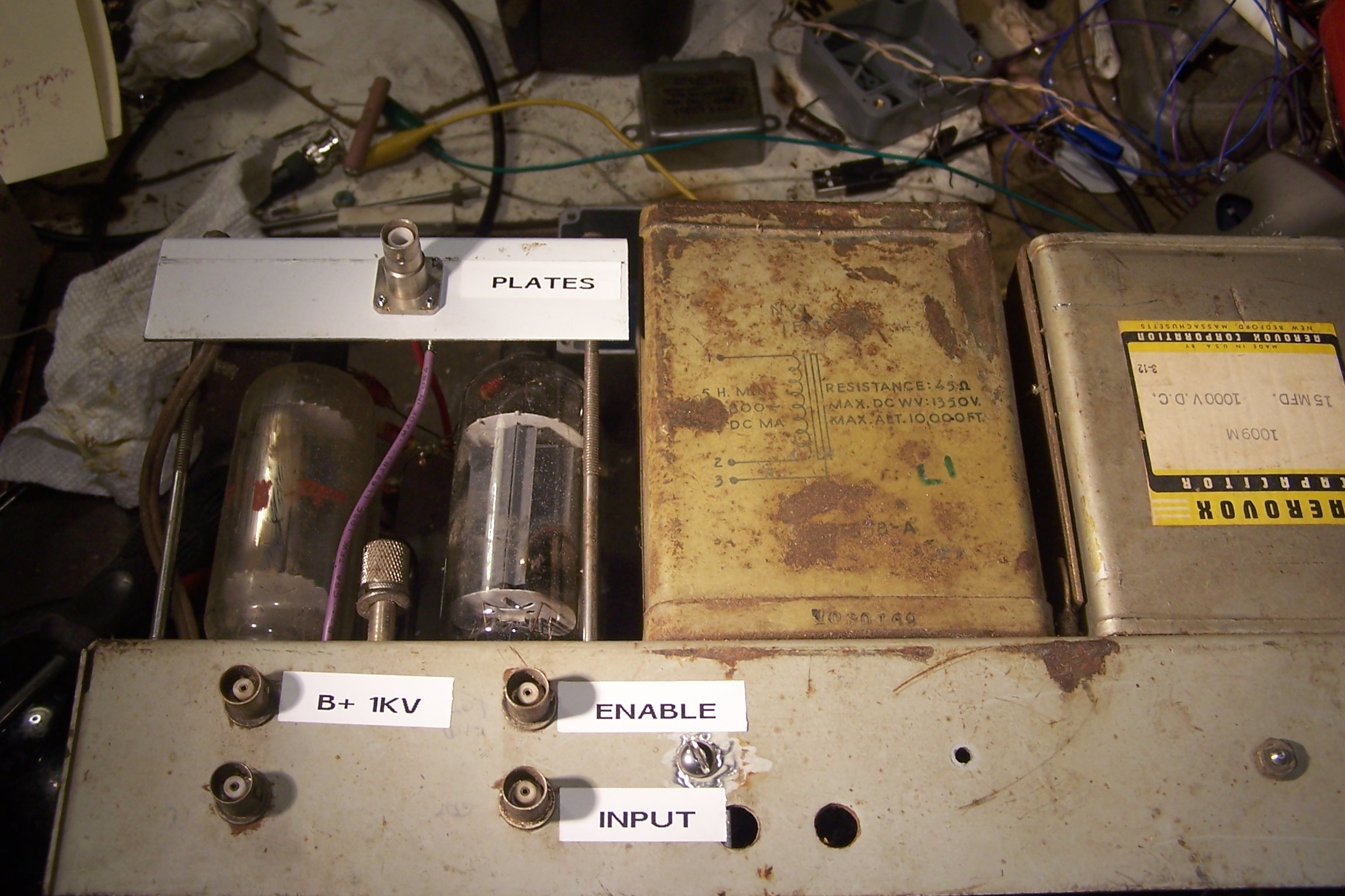

Well, here's hoping Bill "Grumpy" Jenkins was right when he said "Purty don't make it run good".
All wired, tests tomorrow or the next day. The sharp-eyed might notice I pulled the screen grids off ground with bypass caps and then grounded the 6 parallel ones for now...I might want more like the full available current out of these at some point - which will necessitate some other changes to get more control grid bias at rest, so we'll see how it is this way first.
