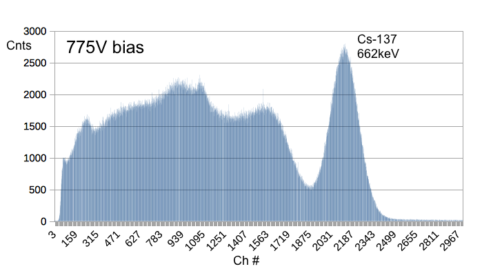

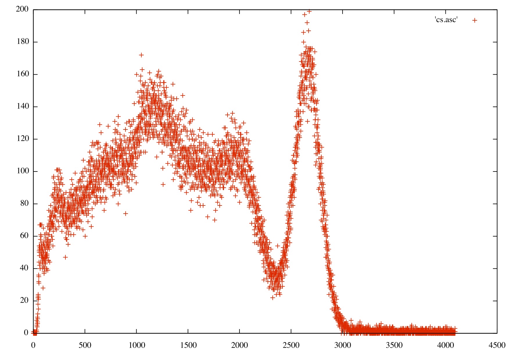

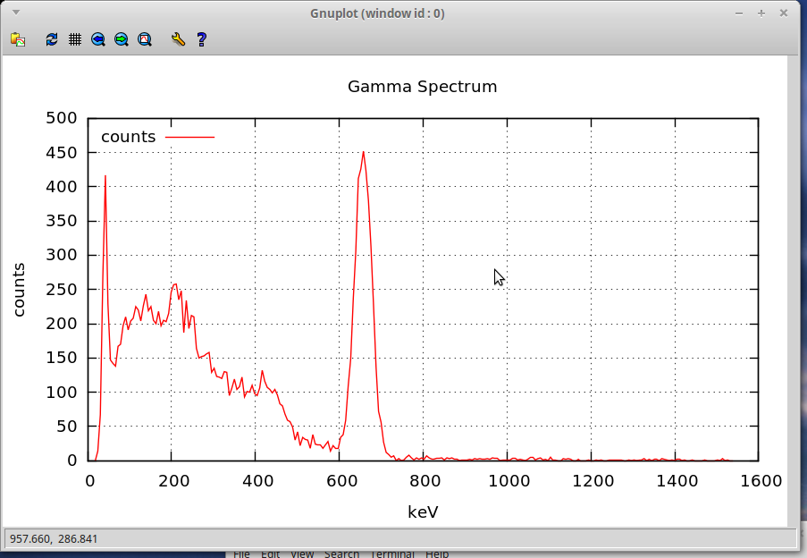

Doug sent me (thanks again!) some Na:I heads among other stuff, and I finally got around to try the smaller one of these. (I still need to put a BNC plug on the bigger one before I can wire it into my MCA.)
I didn't change any settings on the MCA, just replaced the BC-412 by the Na:I and wondered how it might turn out. Since my design uses even slower opamps (OPA-111) than the one I sent to Doug, I'm using excessively high series resistance for the phototube (either 100k or 1M) to give me slower peaks. Of course this makes it prone to problems with pulse pileup but for not-too-hot sources it seems to work well.
Here's a spectrum of Doug's Cs-calibration source (spark gap tube) with live times of 5 minutes and 3 hours, respectively.
Note that the scaling is a little different for both graphs -- that was because I used a somewhat higher bias voltage (~50V more) for the 3h-spectrum.
Doug, I couldn't get that misbehaviour of my board doing these weird fluctuations between adjacent bins reproduced here so far (although I didn't try with the big head). Probably peak length plays an important role (considering the not-quite-highspeed components on the board), and since I stretch my pulses that much, I don't run into those problems?
Philipp
Philipp
Re: homebrew multi-channel analyzer
I'm not sure what's going on there...noise of that amount usually isn't an issue here, so ???. Try with the same sensor I used. I see here that you've set the threshold high enough to not see the low energy line of Cs137. I didn't toss the boards out, if we learn something, that's good. I did add some pulse stretching in the form of 22 pf across the 220k feedback resistor on your opamp. Sure looks like a lot of compton scattering, more than I had here on the bigger sensor, which is to be expected. To avoid some of that, the big boys will sometimes put detectors outside the NaI and put in anti-coincidence logic so that anything scattering out of the side of the NaI means "no count". But in practice that's really hard to do - even lead may as well be transparent at the higher gamma energies, so how to keep the incoming beam collimated enough?

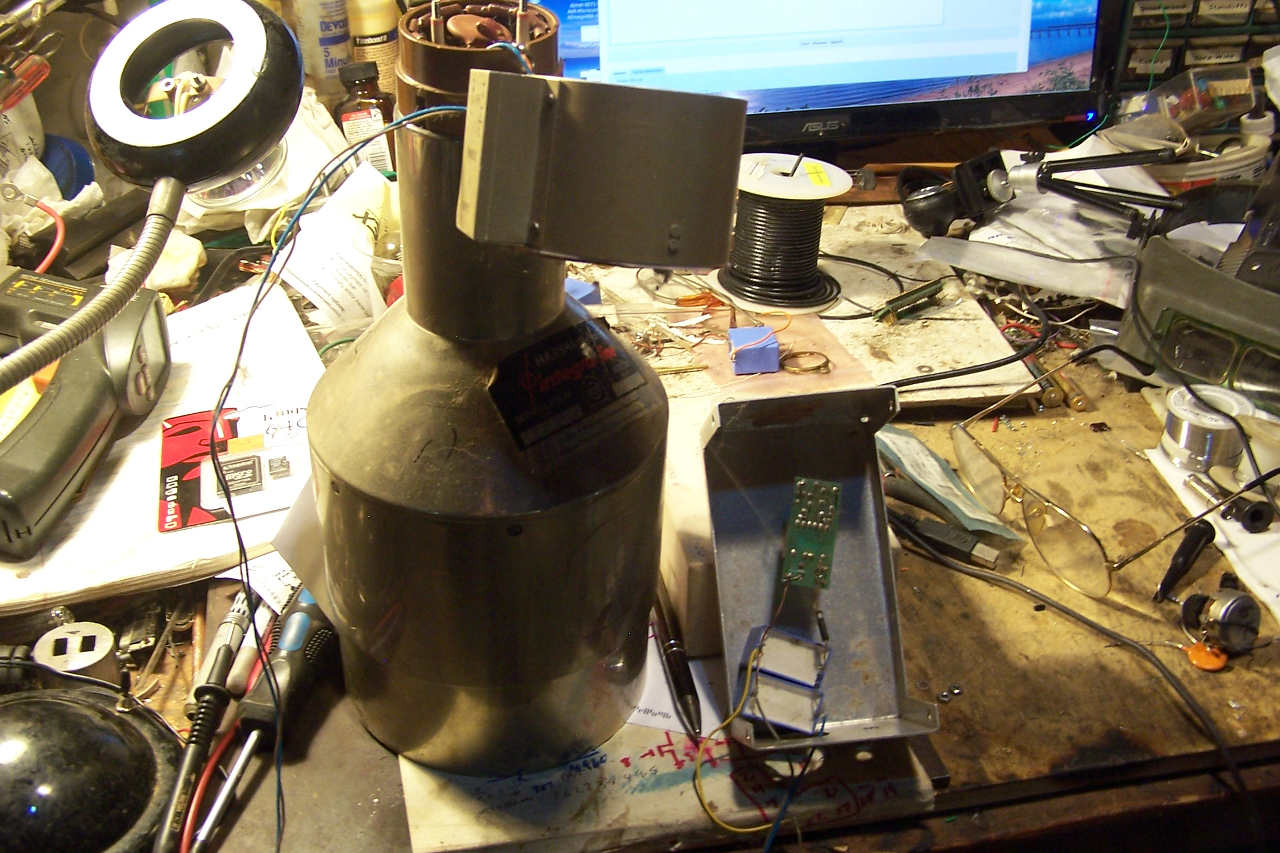

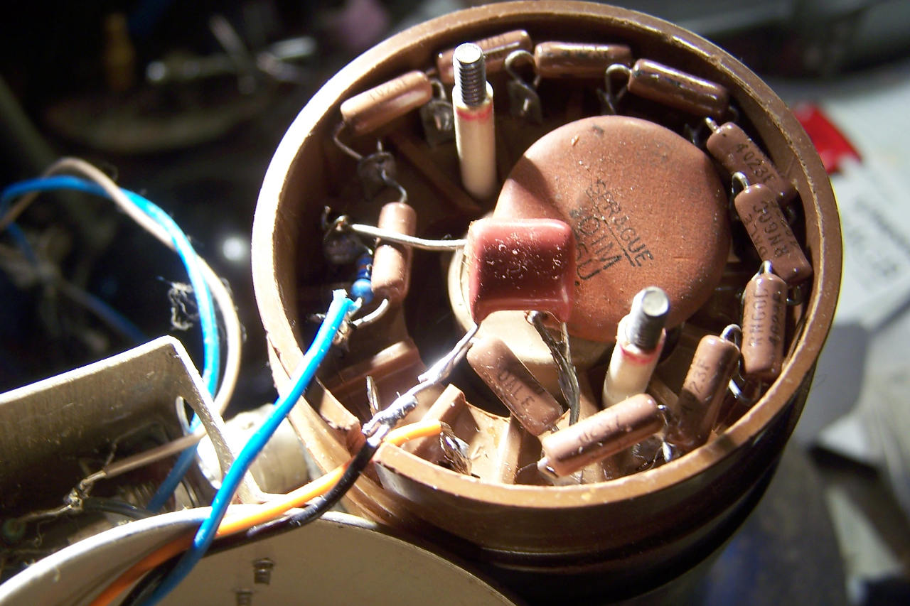

While I've heard otherwise from some in the biz, I have to agree with John here - it's always worked for me. The phototube gain vs voltage is a really steep curve, and getting closer to where the voltage makes less difference (bonus, more signal) seems wise, and has worked out that way here many times. Your main worry is overheating the resistive divider chain if you go too far. We don't know how many stages are in those bicrons, but usually ~>~120v/stage is good. The reason the curve rounds over at high voltage is that the electron multiplication of whatever dynode coating they use has a maximum-limit vs electron velocity. I run my 12 stage (going by resistor count) "gallon jug" NaIs at 1837v here, which is what gave the best spectra on an expensive borrowed MCA. I have re-wired it so that the anode "floats" and is a ground level, providing the HV as negative polarity DC to the photocathode. That works out to around 153v/stage, which made Paul at URSA wince, but it's what worked the best in real life.
Shown here is also the voltage doubled 1kv CCFL inverter I use to drive this - it's in its own box that's kept fairly far away for noise reasons. And here's the actual wiring in there, with the lid taken off so you can see it: This lashup, with a good MCA, gave better spectra of CS137 than the example on wikipedia, but not by a whole lot. There are limitations in every scintillator to resolution, intrinsic and constructional - how many times does a photon have to bounce around before it hits the cathode? This is why my tiny NaI, only a couple mm thick, works better at the low energy end of things.
In this pic, blue is the negative HV, black is ground, and the orange is the output signal (goes to a bnc).

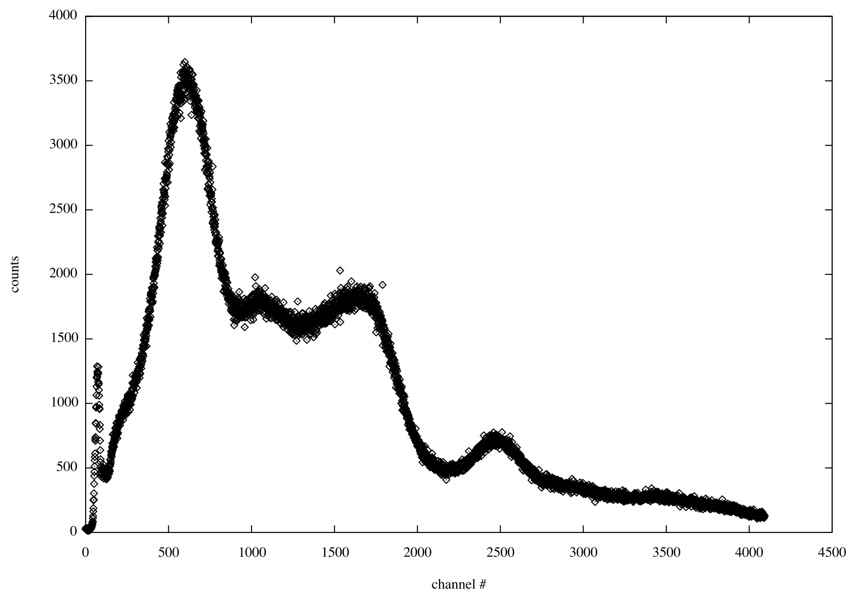

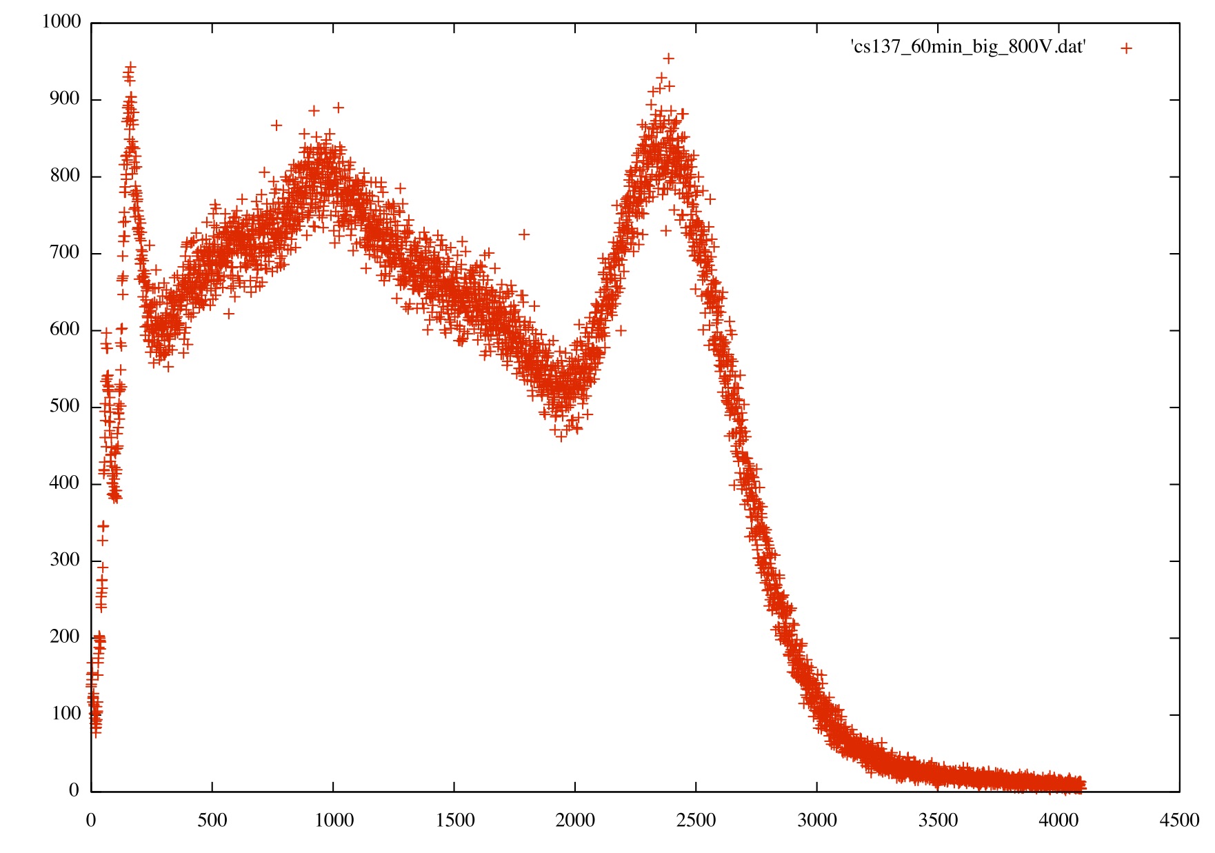

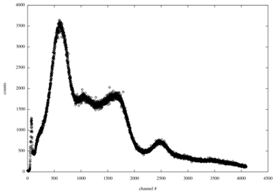

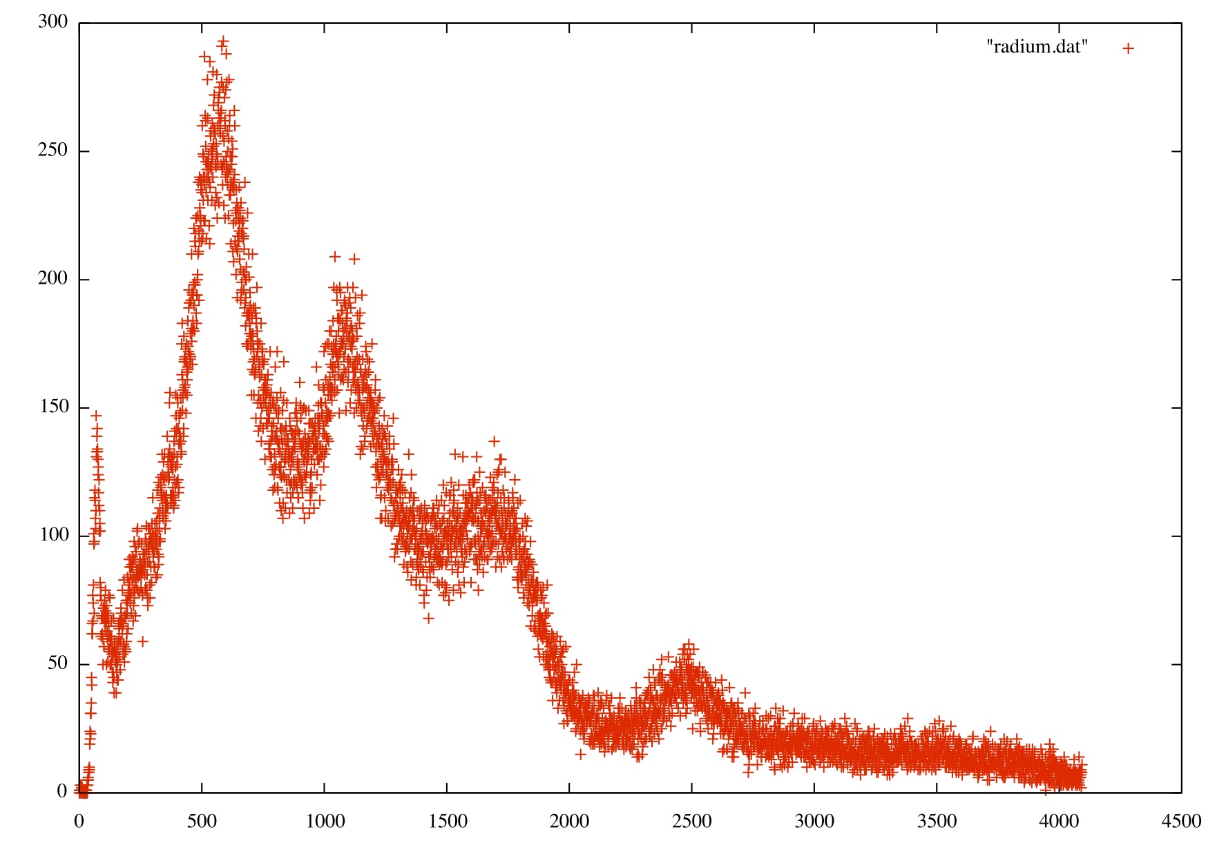

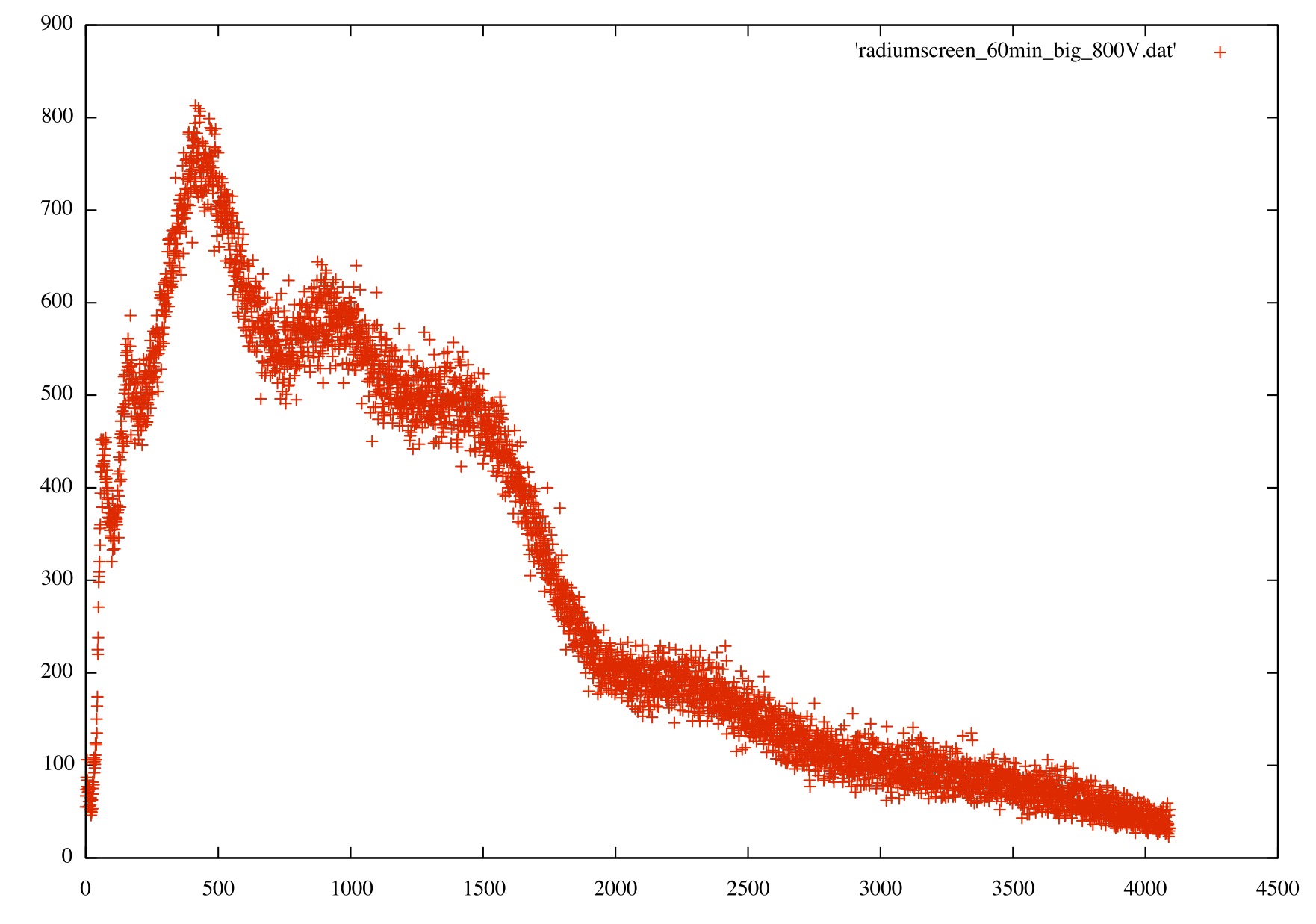

I finally got a chance to do some cross-checking between the two heads Doug sent me. I took spectra of the Cs-137 check source and small radium watch hands.
Here's the raw data (only first and last channel removed from displayed dataset):
Two things are noteworthy: of course, the big head is much more sensitive, hence the improved SNR compared to the small detector. On the other hand, the peaks on the spectra taken with the big detector seem to come out not nearly as clear as on the corresponding shots with the small one. Any hints to what the cause could be?
Philipp
EDIT: Doug, I just looked again at the noise characteristics of the spectra you took with my board and the big probe (added below for sake of completeness). Judging just "by the looks of it", the noise in your spectra (at least to me) looks much more artificial than the bin noise on the above Cs-137 spectrum. What do you think?
Philipp
Well, Philipp, I'd have to do some guessing, which is a domain I'd rather not be in.
I did not change the trimpot or try different time constants on the AC coupling, either of which could account for the differences I see here. I fear that the larger of the two detectors has a flaw of some sort - I did see some junk on its output waveform here. I really doubt any excessive noise was the issue, at least from what I saw on the scope. You did seem to run longer than I did - which averages things better, of course. I was running this over a grounded metal plate here, and in a place that is low-noise to begin with.
Your scheme of waiting for a signal to drop entirely below threshold means variable droop in your S/H if the time varies or the threshold, and that alone would account for (most of) the differences we're seeing here.
I see WAY too much compton scattering in these plots (both of ours) which John Futter tells me is mainly due to how small both of the detector crystals are - they are from PET scanners and were only used for detecting coincidences above some threshold. Indeed, in tests here with those and a "big jug", the big jug shows a far better spectra, with very low compton "noise" between the low energy gamma and high one from Cs-137, quite a few dB down there, if you will. Hard to beat a huge chunk of detector - if a gamma hits the middle, it gets stopped by more of the xtal before it can scatter out. It could be you don't have a "good geometry" experiment there - other nearby things scattering gammas back into the detector, or something between the source (like air) and the detector. It's hard to get right.

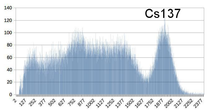

Well, I wish they were better than they are. To make it work close to right, I have to current compensate the NPN, and that causes sag between the time it reports a peak and the a/d in the pic finally gets to it (interrupt latency etc).

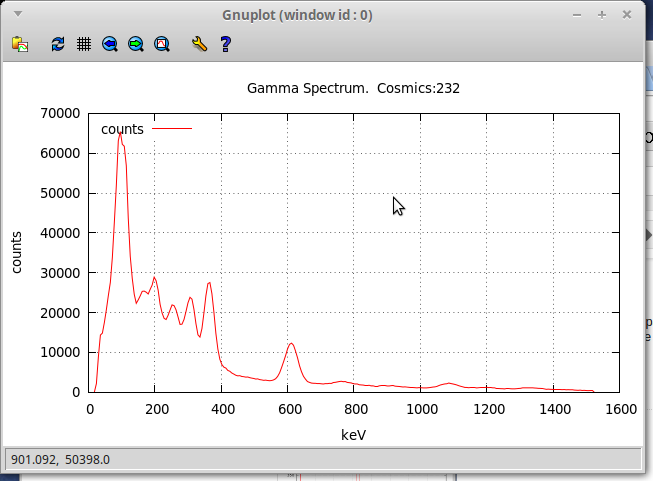

I see a pattern in the data that seems to point to nonlinearity in the pic a/d...hmmm - every 4th bin seems to be very hard to "hit". This might be a pic hardware issue, dunno. I'm going to have to do a couple things differently it appears - move one of the fet "shorting out" elements to the opamp output, rather than the between transistors spot, so the current comp on the NPN (right now, a big R and a -9v battery) won't cause a sag during that time. The pic doesn't seem to always take the same time to respond to an interrupt, which could be because I'm running other junk in the background to flash a led with delay()...and other interrupts (the timer). This is a place where the "simpler" arduino setup is not in your favor, as that stuff is kinda hard to find and turn off so it doesn't interfere with hard real-time things. I might have to go with the "real" mplab IDE, or make the circuit perfect so it doesn't care, one or the other. Or both.

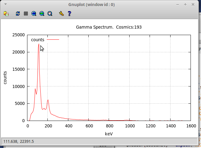

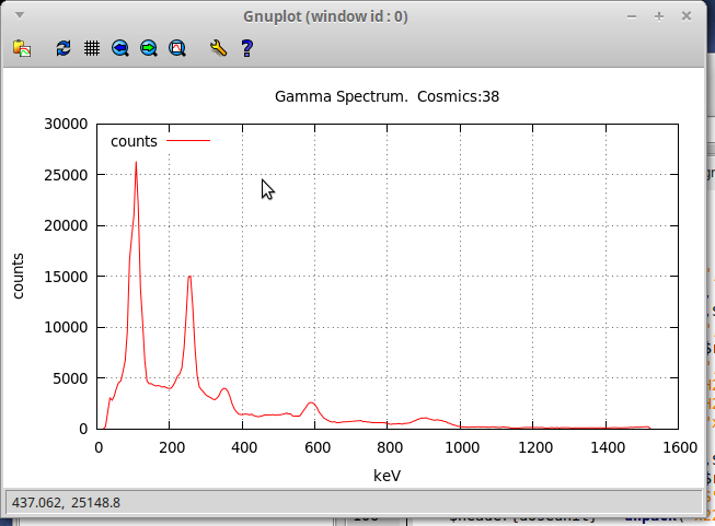

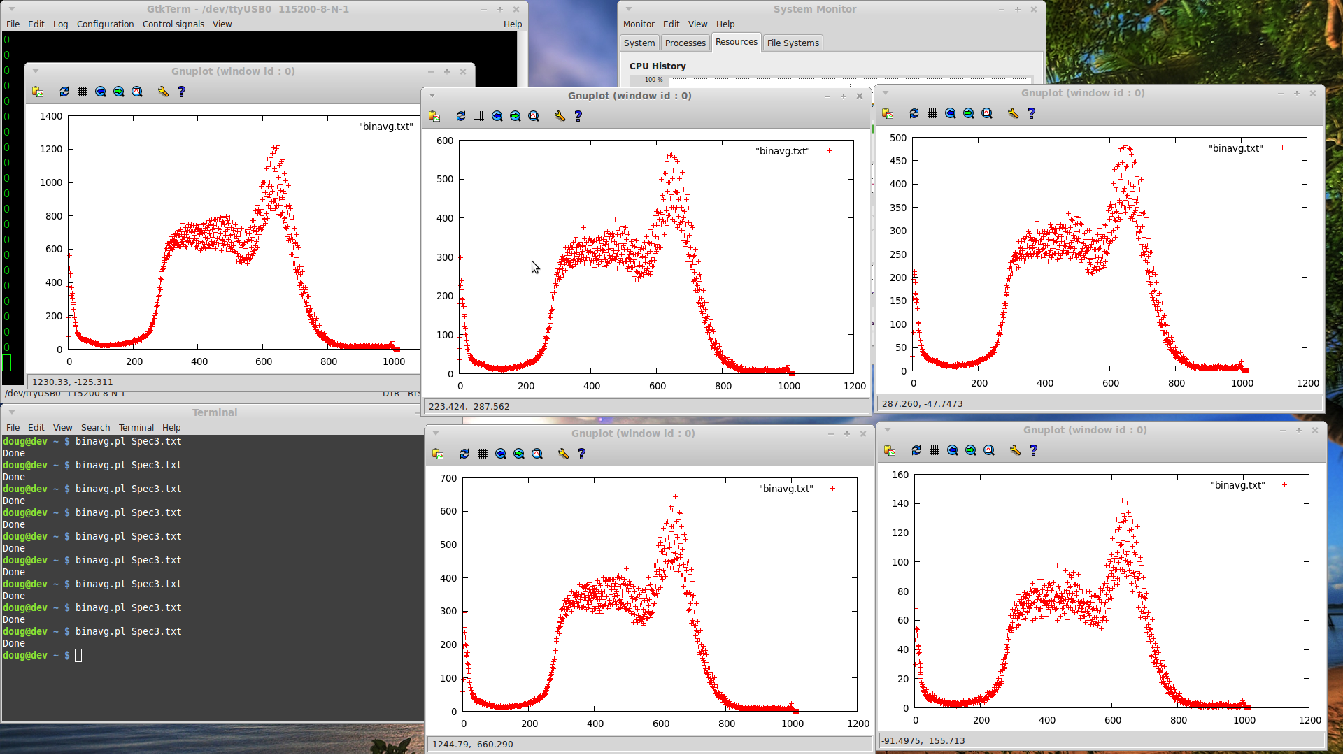

Right now, I'm working with a very nice "Exploranium" GR-130 Bill just got us, only 255 bin resolution, and writing code to grab spectra from it and put them in a database and plot them. When I finish that - which is adequate for my intended use anyway, I'll get back on this one since it will have 4x the resolution and that will eventually matter with better detector heads. For what's in the GR-130, it's not an issue - it's about the same as the bigger NaI I sent you, only laid out a little better as regards light efficiency & compton scattering, but the same weight of NaI as far as I can tell.
Here's some plots of it:
