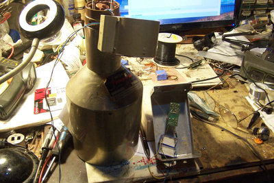

While I've heard otherwise from some in the biz, I have to agree with John here - it's always worked for me. The phototube gain vs voltage is a really steep curve, and getting closer to where the voltage makes less difference (bonus, more signal) seems wise, and has worked out that way here many times. Your main worry is overheating the resistive divider chain if you go too far. We don't know how many stages are in those bicrons, but usually ~>~120v/stage is good. The reason the curve rounds over at high voltage is that the electron multiplication of whatever dynode coating they use has a maximum-limit vs electron velocity. I run my 12 stage (going by resistor count) "gallon jug" NaIs at 1837v here, which is what gave the best spectra on an expensive borrowed MCA. I have re-wired it so that the anode "floats" and is a ground level, providing the HV as negative polarity DC to the photocathode. That works out to around 153v/stage, which made Paul at URSA wince, but it's what worked the best in real life.
Shown here is also the voltage doubled 1kv CCFL inverter I use to drive this - it's in its own box that's kept fairly far away for noise reasons. And here's the actual wiring in there, with the lid taken off so you can see it: This lashup, with a good MCA, gave better spectra of CS137 than the example on wikipedia, but not by a whole lot. There are limitations in every scintillator to resolution, intrinsic and constructional - how many times does a photon have to bounce around before it hits the cathode? This is why my tiny NaI, only a couple mm thick, works better at the low energy end of things.
In this pic, blue is the negative HV, black is ground, and the orange is the output signal (goes to a bnc).

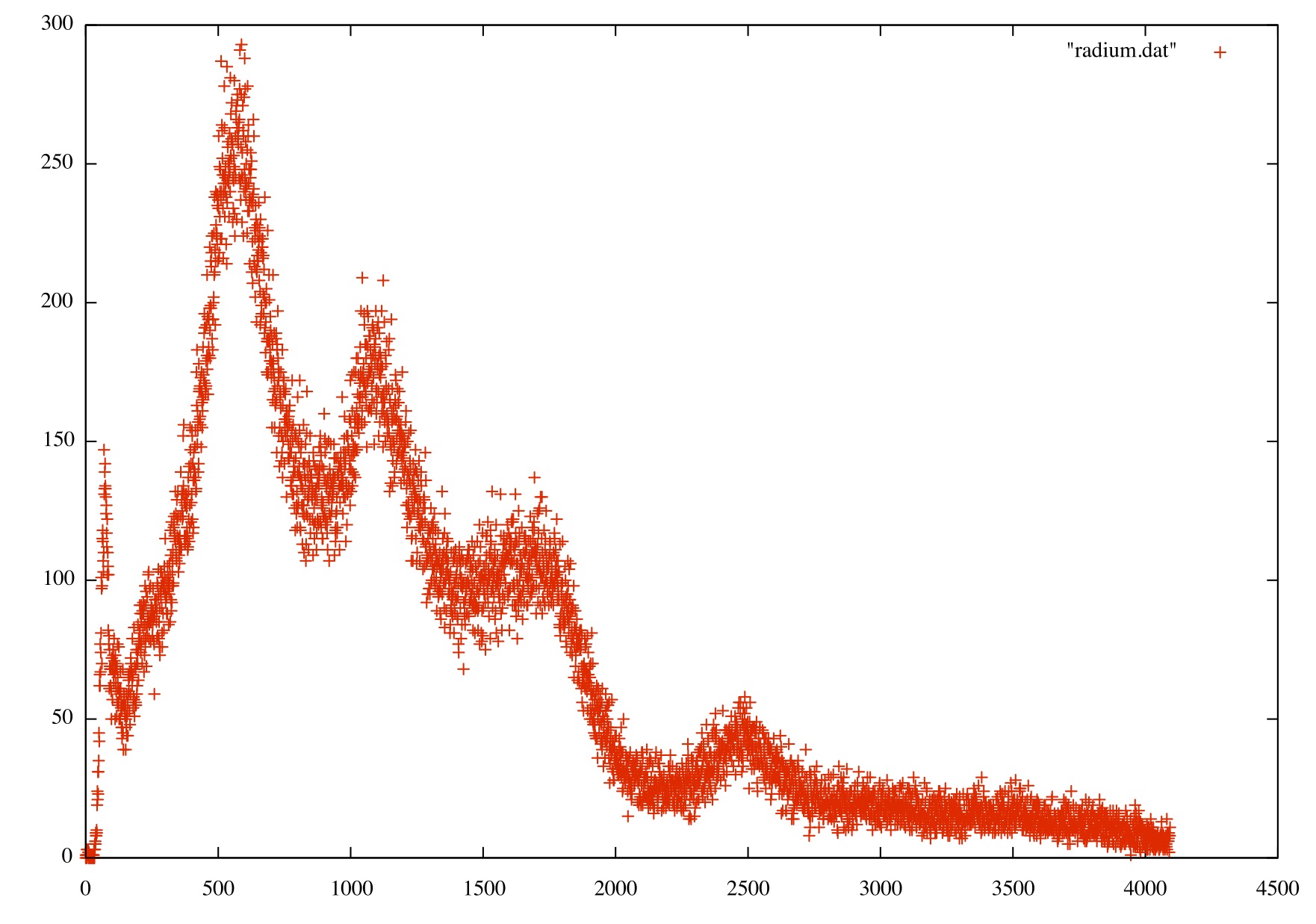

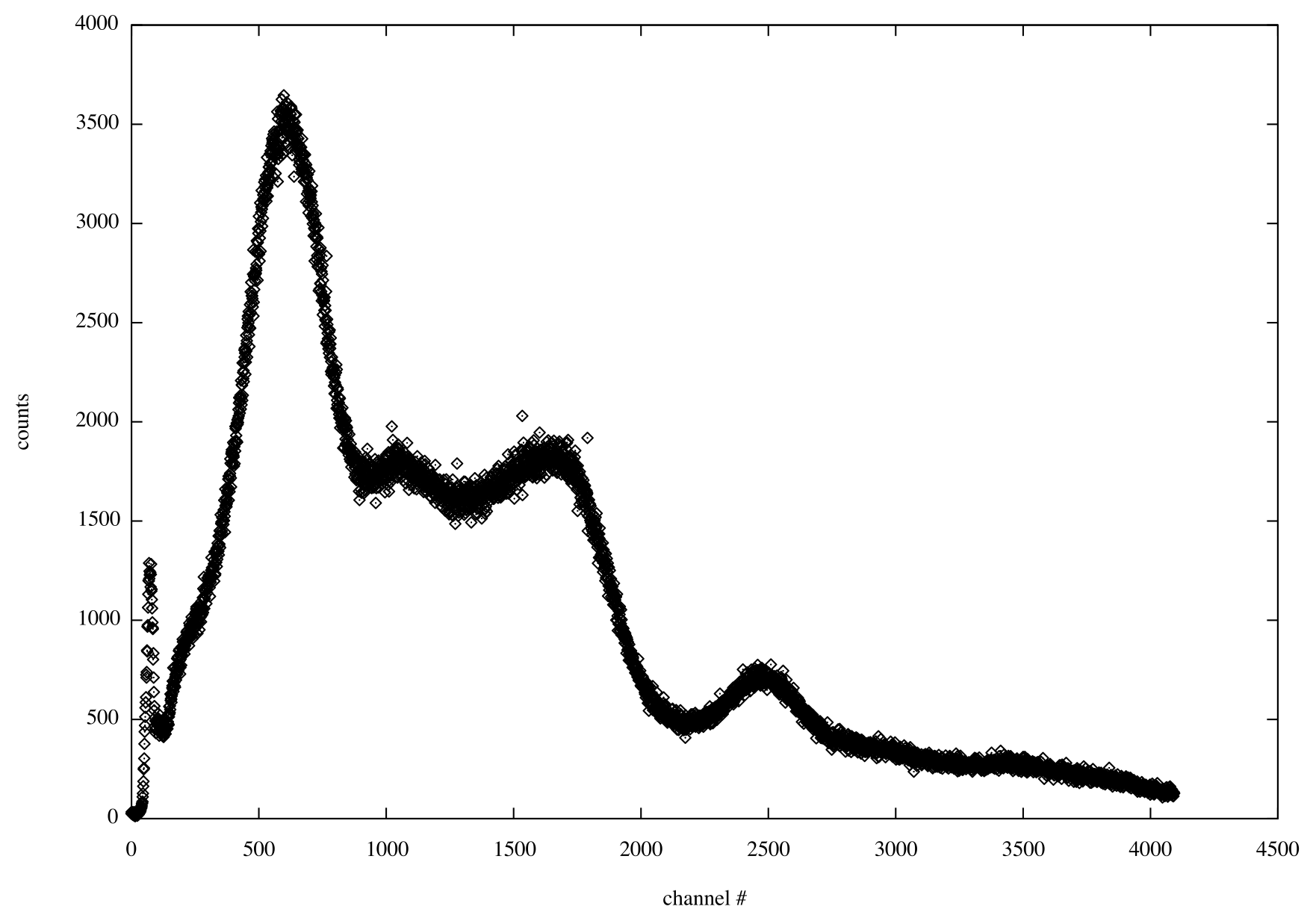

I finally got a chance to do some cross-checking between the two heads Doug sent me. I took spectra of the Cs-137 check source and small radium watch hands.
Here's the raw data (only first and last channel removed from displayed dataset):
Two things are noteworthy: of course, the big head is much more sensitive, hence the improved SNR compared to the small detector. On the other hand, the peaks on the spectra taken with the big detector seem to come out not nearly as clear as on the corresponding shots with the small one. Any hints to what the cause could be?
Philipp

Well, Philipp, I'd have to do some guessing, which is a domain I'd rather not be in.
I did not change the trimpot or try different time constants on the AC coupling, either of which could account for the differences I see here. I fear that the larger of the two detectors has a flaw of some sort - I did see some junk on its output waveform here. I really doubt any excessive noise was the issue, at least from what I saw on the scope. You did seem to run longer than I did - which averages things better, of course. I was running this over a grounded metal plate here, and in a place that is low-noise to begin with.
Your scheme of waiting for a signal to drop entirely below threshold means variable droop in your S/H if the time varies or the threshold, and that alone would account for (most of) the differences we're seeing here.
I see WAY too much compton scattering in these plots (both of ours) which John Futter tells me is mainly due to how small both of the detector crystals are - they are from PET scanners and were only used for detecting coincidences above some threshold. Indeed, in tests here with those and a "big jug", the big jug shows a far better spectra, with very low compton "noise" between the low energy gamma and high one from Cs-137, quite a few dB down there, if you will. Hard to beat a huge chunk of detector - if a gamma hits the middle, it gets stopped by more of the xtal before it can scatter out. It could be you don't have a "good geometry" experiment there - other nearby things scattering gammas back into the detector, or something between the source (like air) and the detector. It's hard to get right.

the thing is - apart from getting rid of the preamp, I did not make any changes to the circuit. Given the intrinsic problems of the design, I'd say it works remarkable well (for my practical requirements, I can do away with the noise by just letting it run longer).
Here's another one I did the other day. This is a small chunk of pitchblende (the smallest I had, but still hotter by far compared to the Cs-137): Yes, I will most definitely try that BGO crystals of yours on that dual phototube! I only have to throw together a new power supply (negative volts, and more power, my current supply is limited to about +800V) and find some truly light-absorbing material to house the crystal.

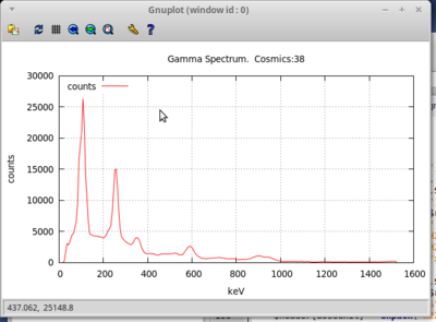

Right now, I'm working with a very nice "Exploranium" GR-130 Bill just got us, only 255 bin resolution, and writing code to grab spectra from it and put them in a database and plot them. When I finish that - which is adequate for my intended use anyway, I'll get back on this one since it will have 4x the resolution and that will eventually matter with better detector heads. For what's in the GR-130, it's not an issue - it's about the same as the bigger NaI I sent you, only laid out a little better as regards light efficiency & compton scattering, but the same weight of NaI as far as I can tell.
Here's some plots of it:
