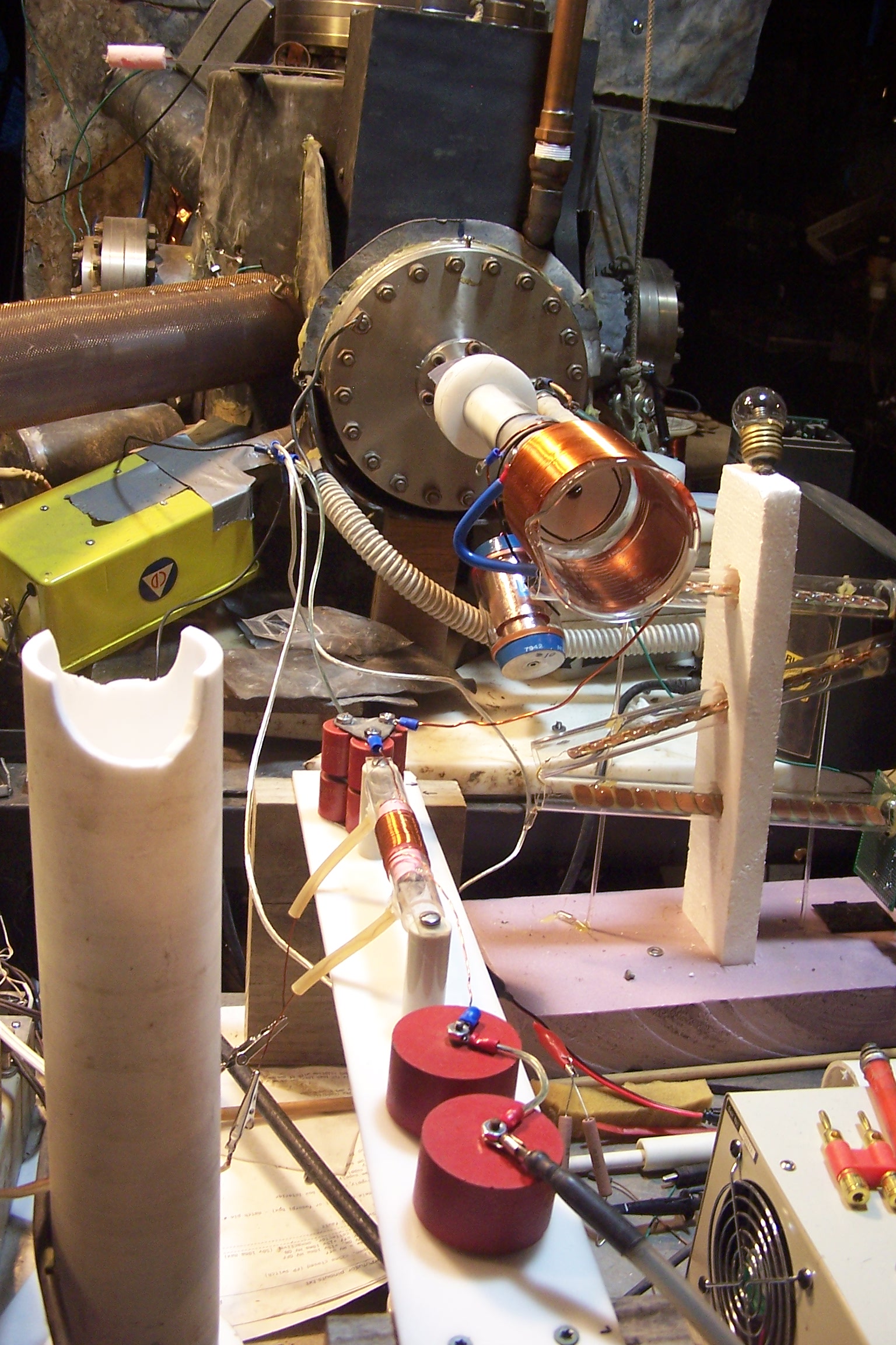

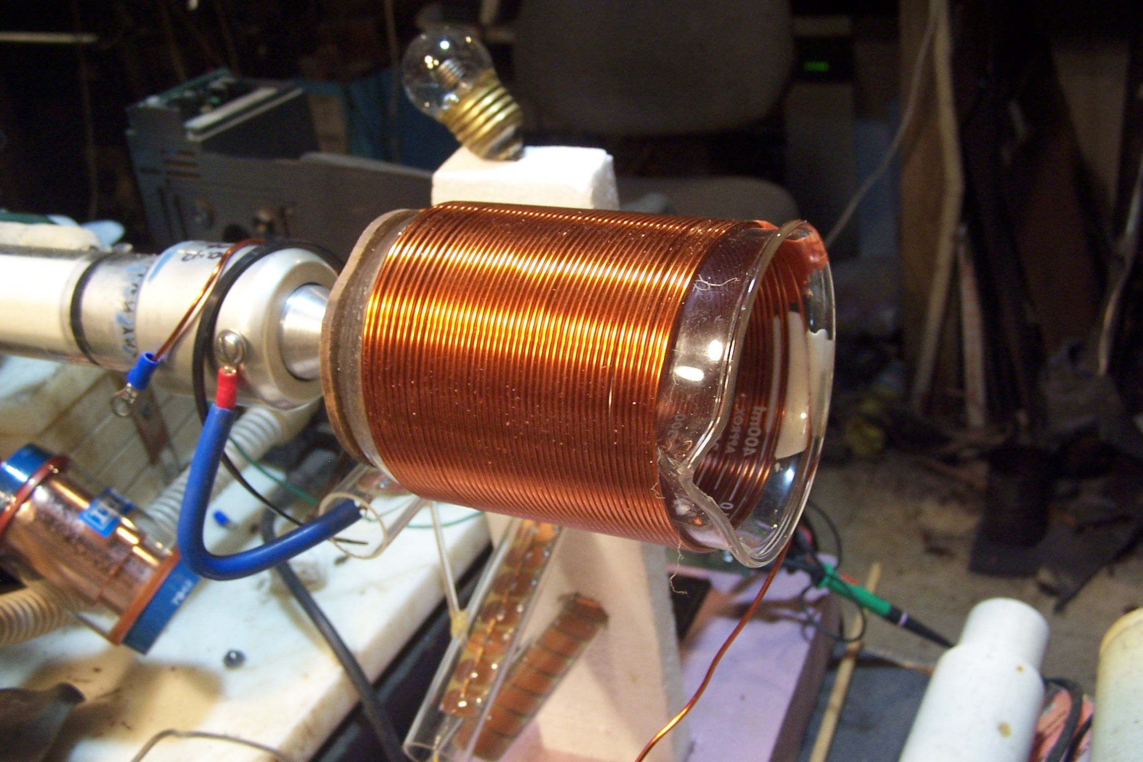

Wouldn't you know I finish up this prototype build just in time to quit for the day....but here's what it looks like before I smoke it.
The pi network L coil is that big dude at the top, wound on a beaker I've drilled a hole in (glass drilling is fairly easy, I should do a post on that). It gives me a drive impedance (without ion loading) around 470 ohms at resonance at 2.9 mHz or so.
The RF amp will drive 1k no sweat, breaks a sweat below that, and I need isolation, so that's the transformer with the quartz tube in the middle, wound on a .5" piece of type 61 ferrite.
The big red caps at the bottom are bypass for the DC input, so I don't try to back drive the Spellman and fry it (it's about 5k pf total).
Lathes are nice for winding coils: I'm not using the vacuum cap shown here, yet. With that L it's too much for the frequency I want now...but the idea was to provide more C fixed so the ion load, which looks like more C (as well as some R) won't affect things as much. In this case I (stupidly?) added some Hysol epoxy to hold the turns on there - it gets warm - so changing the L for a smaller value to keep the F0 up will be a "try that when I know I need to" thing. It could very well be that I want a lower frequency due to the way losses seem to interact with the math...losses make the particle move slower for a given input voltage, which is probably why I was seeing at least some bunching even down at the 100's khz range earlier....at much denser (higher loss) conditions than I plan for this set of runs.
And yes, that's an oldie but goodie multi-watt neon bulb stuck in the styrofoam that's also holding the HV probe stuff...lights up quite brightly when the RF is on...

You plan on getting that coil real hot? PVC would have been easier to work with and at HF, loss should not be an issue.
Re: Big Video Amp
No, not super hot, but...Stuff happens sometimes. The pi coils I first tried with thinner wire got real hot from skin effect losses. And that's before I could really crank in the power.
Beakers are both cheaper and lighter in weight than PVC (a case of 12 was ~ $30 on amazon - some import, thin glass)...The feedthrough end does get hot, it conducts heat all the way from the grid and on out, which is otherwise a good thing, I can run more power without melting things. Both the copper and the boron nitride are pretty good thermal conductors. So if you have the tooling to use them, it's not as dumb as it sounds.

I suspect it would be mostly conducted heat from the fusor itself. at 2 MHz, your coil should not get that hot. Now if you were at 30 Mhz, you would want to use 12 Ga silver plated wire.
