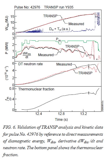

The plot I usually post up is figure 6 of a paper you can download here; http://www.iop.org/Jet/fulltext/JETP98036.pdf
This is one of the most powerful tokamak runs ever. Only JET and TFTR are equipped to perform DT operation. JET sits behind metres-thick concrete, and work inside the vessel can now only be done by robot.
The figure shows actual results versus simulation. It's a bit tricky to work out whether an experimental neutron came out of a thermal-thermal fusion reaction or a beam-background reaction, so I will take it as read that the simulation below describes it accurately, as it is accurate in the other parameters (power output, &c.).
So if you eyeball the thermonuclear fraction, you'll note that there is very little at the start of the pulse. The fusion power, as much as it is, is dominantly from the fast ions circulating in the toroidal current. This remains the case for almost the entire duration of the pulse!! Overall, it looks to me like most fusions for the whole pulse are beam-target.
Clearly, the tokamak guys have high hopes of pushing this into dominantly thermonuclear with a longer run and they may well achieve that, but for now the beam-target fusion that goes on at the start of the pulse is actually a necessary heat input for the plasma to get it to the thermal temperature required for thermonuclear reactions.

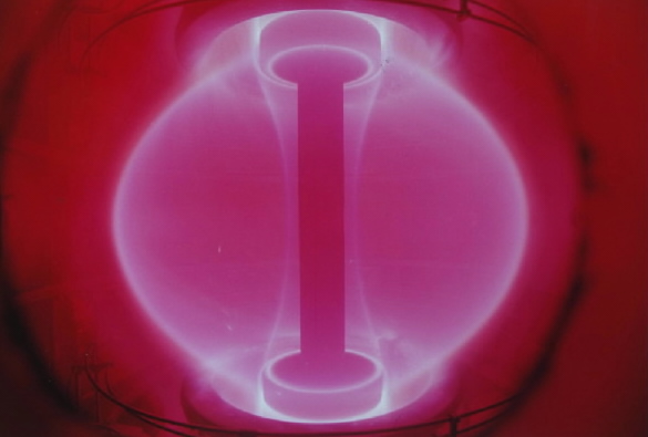

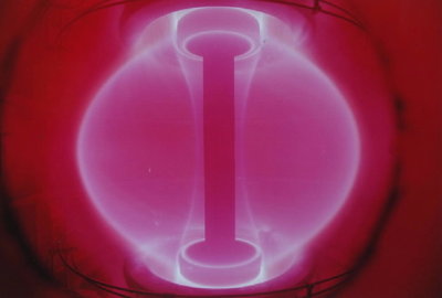

I am supposing that they are hoping for collision events with the non neutron reaction products for enough heating to get to "thermonuclear" mode? Obviously, the neutrons aren't going to contribute much heating. I am also guessing that (most of) the X rays come from near-misses of electrons and ions, braking radiation? From your picture, that looks like the spherical version that seems to do so much better than the ITER design that they are proposing using it for materials testing? I forgot the name of that project, drat. Link?

I don't think they are explicitly looking for non-thermonuclear-fusion heating, per se. They'd view it merely as a side effect from driving a pinch current through the plasma.
START was the first [spherical] tight aspect ratio [tokamak] and gave results better than expected so they went ahead and built a dedicated experiment [MAST]. This wasn't a 'dedicated' kit in that START was built from equipment scavenge along the lines of many a fusor setup, being made up of what was lying around at Culham. One of the reasons this is such a 'good' image is that the chamber used is actually a large cylindrical process chamber that was lying gash and was 're-used'. Though they would've liked to have a dedicated toroidal chamber, the use of the cylinder meant that they got a superb angle shot of the whole plasma, which was in no small measure a direct factor in them securing funding for MAST. (Getting good imaging of your work is not a particularly useful scientific function, but I think it's one not to overlook to generate interest and support which is why I have tried hard to do that.)
The START experiment was around a £100,000 cost, and gave ~10^13 neutron output pulses, so it worked out cheaper $/neutron that any fusor project also.
The spherical tokamaks give a higher beta than the lower aspect ratio toroids, but they don't have the same confinement times [I think that is the downside - don't quote me on that] so are not yet appearing to be better net energy candidates than regular tokamaks though they can pump out the neutrons readily enough in short pulses. There are some opinions that spherical tokamaks will ultimately show tokamaks the way to go and there are a number of programmes trying to get these running as the high beta should mean they won't need to be very big by comparison.
Well, you could point your mouse over the image and you'll see I gave it the title 'MAST', which is a bit of a clue.... But actually I think that is a red-herring because looking at the central column it looks like it is START.Doug Coulter wrote: I forgot the name of that project, drat. Link?
