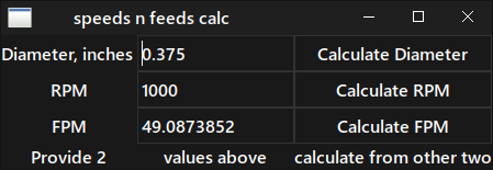

To use this, put in any two of the values, and click the button beside the third one you want to calculate from the other two.
Sample values are already there - you just delete them and type over them.
This was prompted by seeing an $80 calculator bundled with Machinery's handbook to do these calculations. This is a little less expensive, and I do have computers pretty much everywhere.
It looks like this in my dark-themed raspberry pi running the "twister" opsys
Careful surfers might notice that the number for sfm above is wrong...I made the rather embarassing mistake of thinking that the circumference was pi*r, instead of the
obvious pi*d in the first upload this afternoon. I actually woke up in the night thinking...D'oh... it's fixed now.

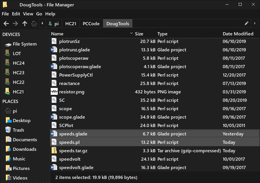

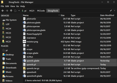

Note the size of the tar file above. This contains the perl program, and an xml file created by Glade that defines the GUI layout and properties - essentially twice, as the same content has been pasted into the perl script itself to remove the dependency on finding that file somewhere in your system. I just provide it separately as well to make it easy to open up in Glade and see what's going on or edit it to taste.
Small, despite wordy xml GUI definitions
