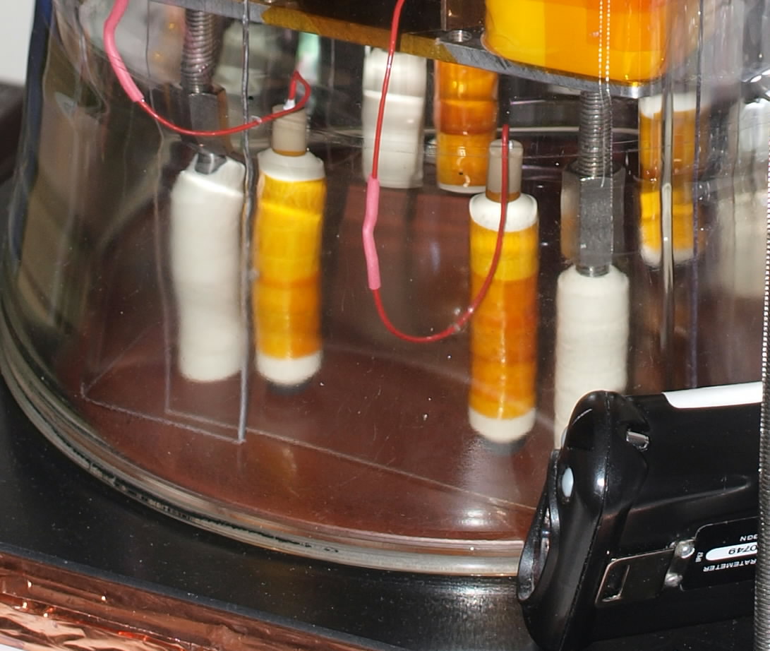

OK, so my post here is not quite the topic you are discussing, so this won't help (!) but hopefully might get the thought-juices flowing, perhaps...
In my setup I get a lot of help from the residual magnetic fields floating around. Mag fields appear to suppress undesirable discharges - but only so far.
My setup needs lots of connections and, though smaller voltages, potentials (V/m) that in some locations are not so different to fusors.
I got discharges all over the place from the feedthroughs I had. I made teflon threaded standoffs from the baseplate, but I still got discharges coming off the interconnections at the top, even when screened by even more teflon. In other words, even just a tiny gap left in a dielectric still won't help much, and those wily electrons will find a conduction path.
Here you can see where I ended up, simply out of practical convenience. This would be unsuitable for you, but the problems I am overcoming here might be relevant (to avoid!). I had made up 2kg(min order) worth of 8.5mm ID fish-spine beads for general purposes inc to use as 'shadows' around M8 parts. I used these to drop over the feedthroughs (which are M5 stainless studs) and then passed the wire through a peek insert that passes through the top most bead. Still conduction paths right through where the beads touch - and that was tenths of mm. So I then wrapped kapton tape around those beads to cover the gaps up. Also, I wrapped PTFE tape around the wires (those are Kapton wires too) and that 'bundle' of tape can then be slid down the wire to bung up the remaining hole left in the top between the wire and the PEEK insert
So I think there might be a couple of pointers that could still apply to any thinking on feedthroughs; i) howsoever you arrange dielectric material around the feedthrough, you can't leave even the slightest gap exposing a conduction route because it'll always find a path through, ii) however, you don't actually need a great thick insulator to do that and, for example, (rather than using kapton tape) you could wrap a thin sheet of teflon around the standoff and then push ceramic beads over the teflon wrap to hold it in place which'd shadow the teflon from ion exposure/deposition.
I'm not sure I've explained all this quite well enough, but fire back to me on anything if I've been unclear. And I'm sorry that this probably doesn't help that much but you're running square into the issues of why 'fusors' are so limited in their scope of being recognised as likely to answer any 'serious' fusion questions.

Re: Getting HV into a fusor
